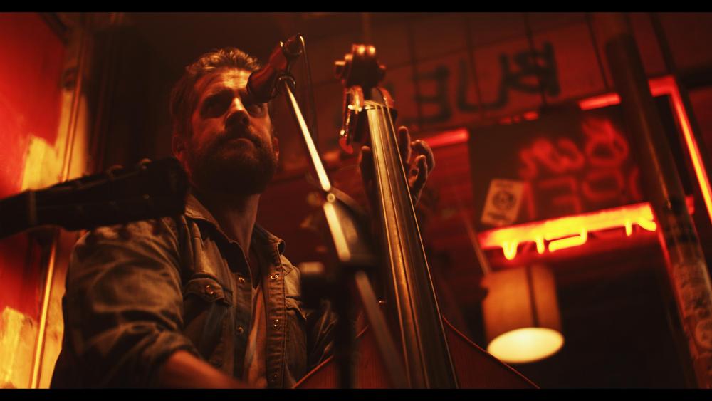

thebrothersthre3 Posted March 13, 2019 Share Posted March 13, 2019 1 hour ago, kye said: If you want to learn a thing or two, take the original images and then match everyones grades as close as you possibly can. If you can't work out what someone did, ask them and then try that. You will learn a bunch about what the knobs all do, but you'll also learn more about what you like and what 'works' according to your eye and preferences. Yeah I'll try that, a lot of colors look grey to my poorly calibrated eyes. Link to comment Share on other sites More sharing options...
kye Posted March 13, 2019 Author Share Posted March 13, 2019 33 minutes ago, thebrothersthre3 said: Yeah I'll try that, a lot of colors look grey to my poorly calibrated eyes. A trick in grading you can do to 'see better' is to add a contrast/saturation effect at the very end to both shots. I'd suggest: Start with normal settings and get the right colour space transformation Sat=0 and just match the overall contrast and gamma curve Sat=0 with added contrast to fine-tune the gamma adjustments Sat=150-200% with normal contrast to exaggerate the colours and match the WB, saturation of various hues, and any tints to shadows / highlights back to normal sat and contrast and play the "what looks different' game In a sense, a lot of grading to match things is just looking for what looks wrong and then fixing it and keeping on doing it until it's good enough. The other part of grading is looking for what might make the image better (whatever that means for the project) and just trying things and when you find something that improves it then just dial in the strength of it and then look for the next thing. Link to comment Share on other sites More sharing options...
thebrothersthre3 Posted March 13, 2019 Share Posted March 13, 2019 5 hours ago, kye said: A trick in grading you can do to 'see better' is to add a contrast/saturation effect at the very end to both shots. I'd suggest: Start with normal settings and get the right colour space transformation Sat=0 and just match the overall contrast and gamma curve Sat=0 with added contrast to fine-tune the gamma adjustments Sat=150-200% with normal contrast to exaggerate the colours and match the WB, saturation of various hues, and any tints to shadows / highlights back to normal sat and contrast and play the "what looks different' game In a sense, a lot of grading to match things is just looking for what looks wrong and then fixing it and keeping on doing it until it's good enough. The other part of grading is looking for what might make the image better (whatever that means for the project) and just trying things and when you find something that improves it then just dial in the strength of it and then look for the next thing. Sounds like a good workflow. My bigger issue is just not really knowing what proper color looks like to judge skintone or really anything in the shot. Link to comment Share on other sites More sharing options...

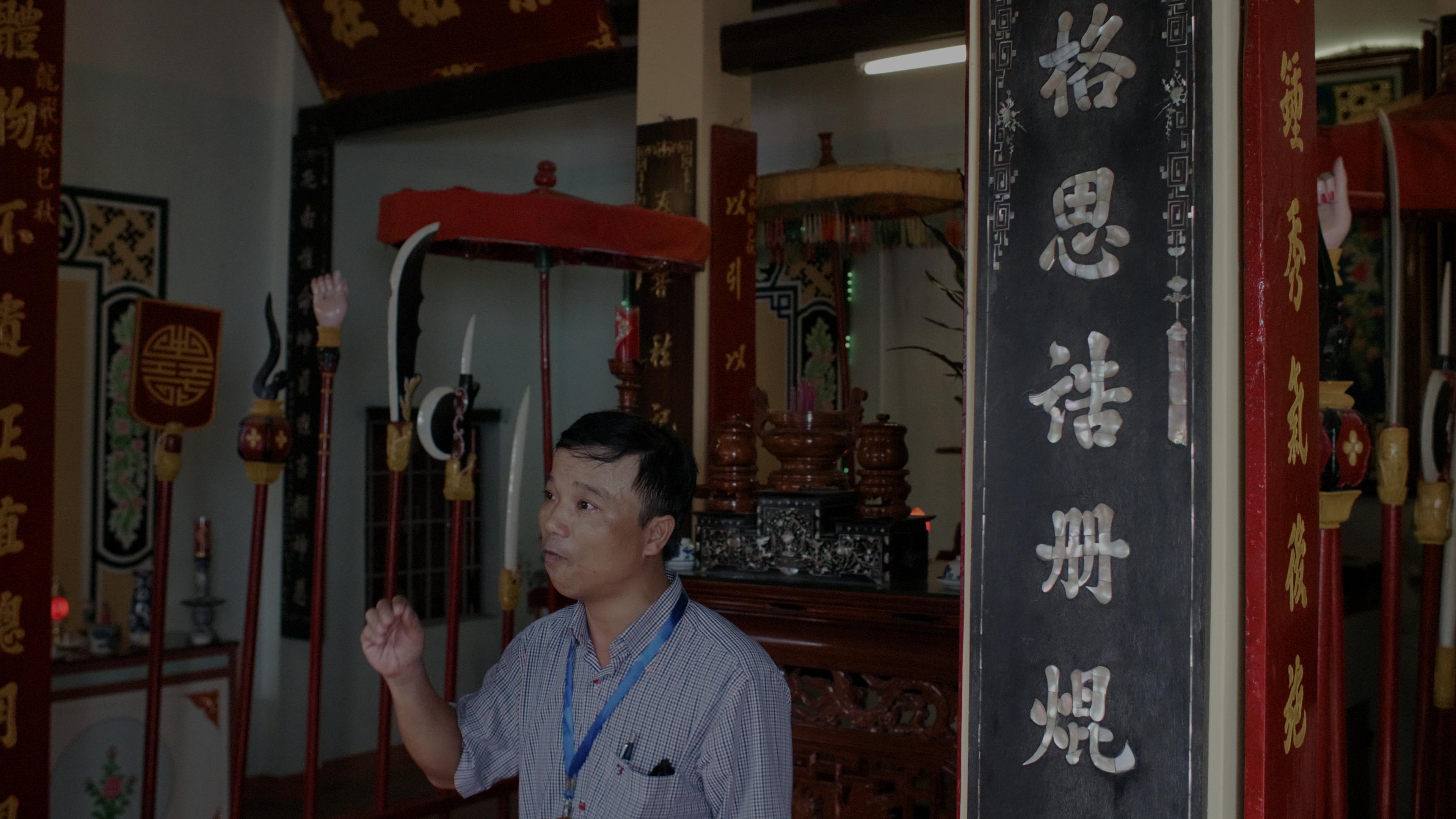

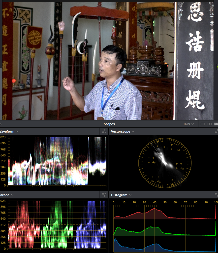

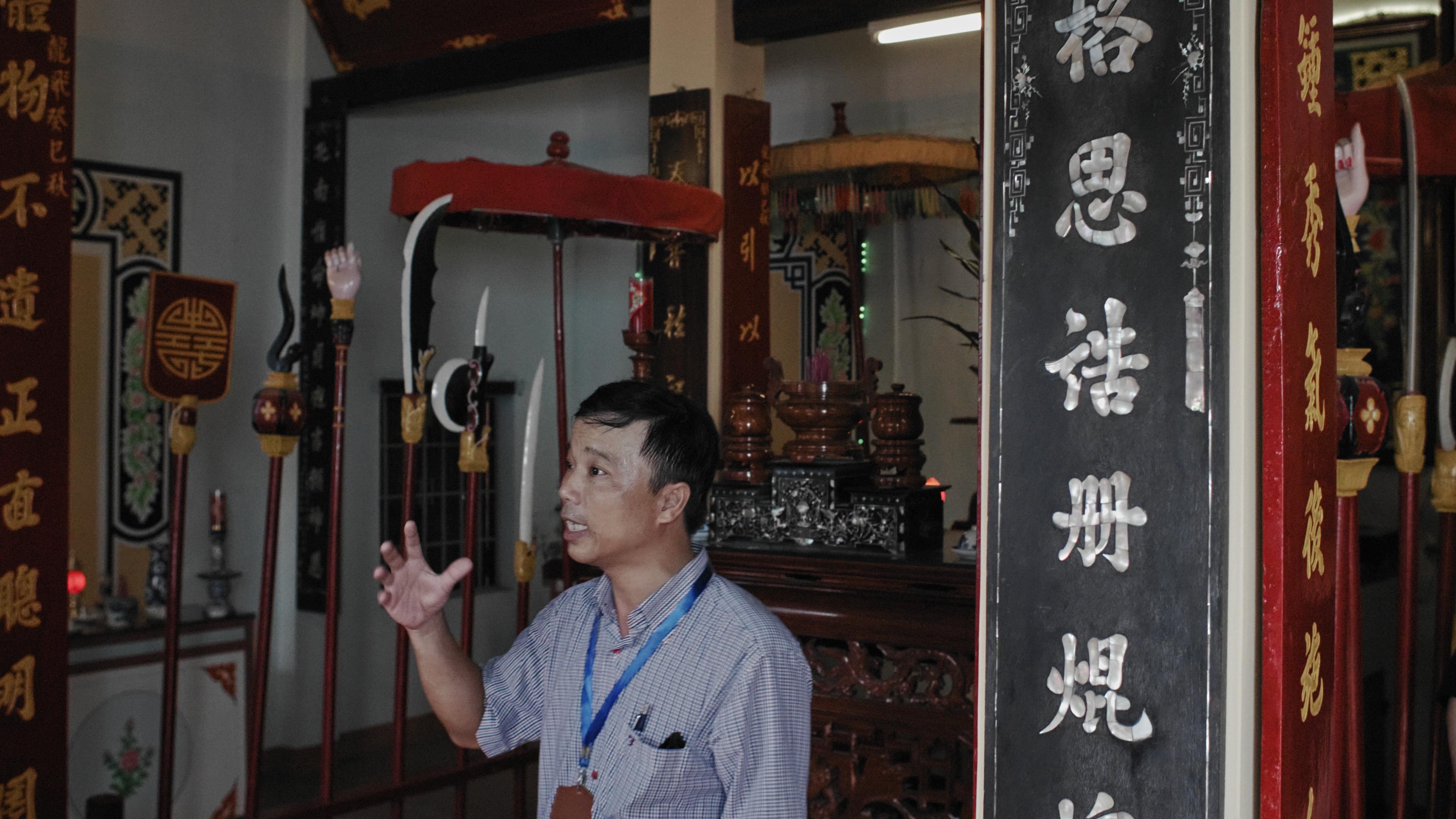

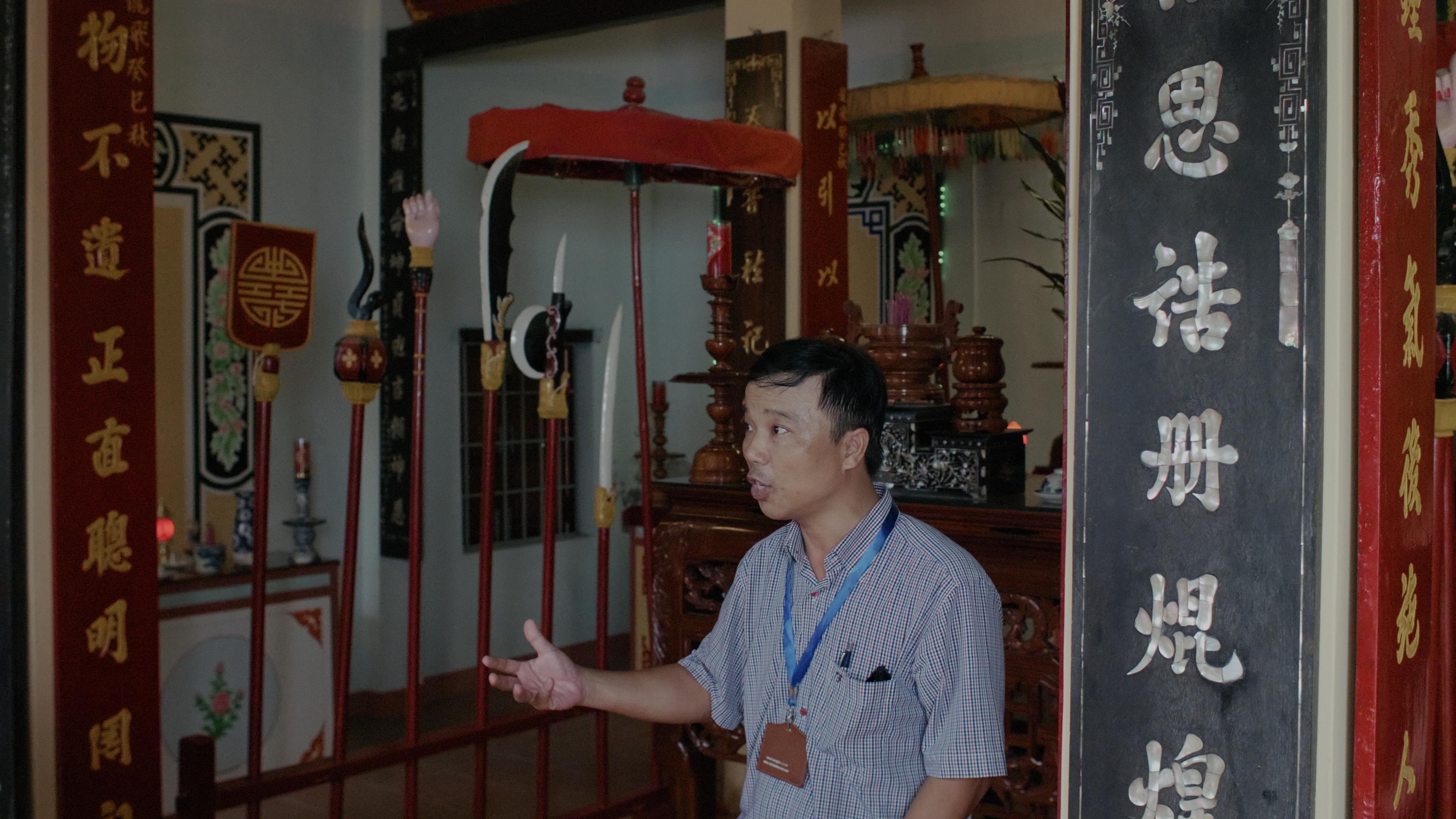

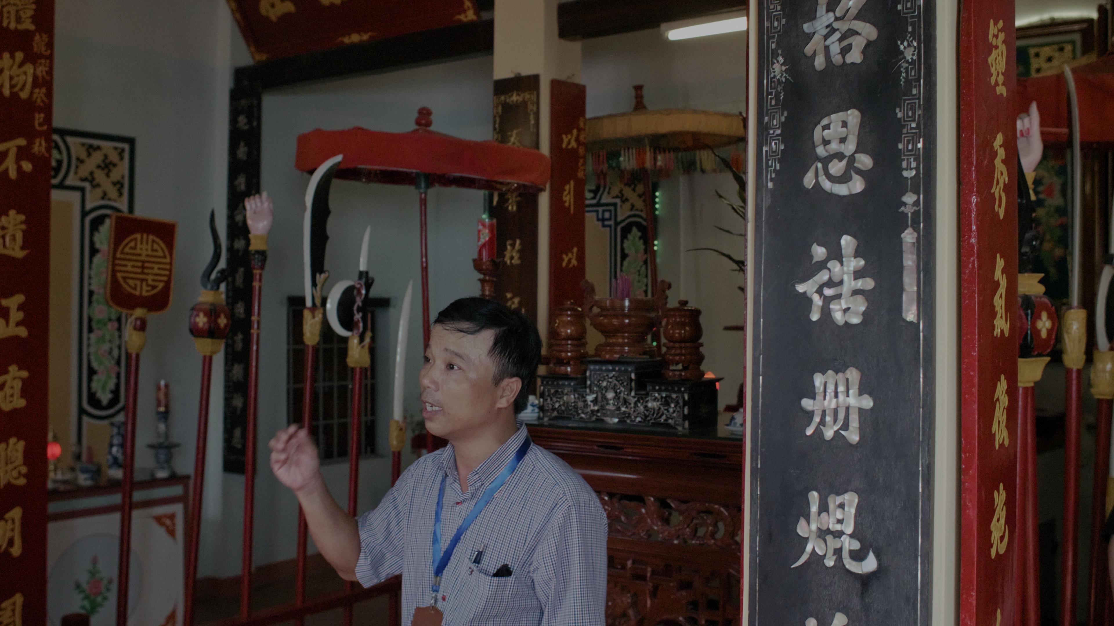

kye Posted March 16, 2019 Author Share Posted March 16, 2019 Let's up the ante... Challenge #3 - colour match the first two images. You are done when you could cut from one to the other in the same scene. Link to comment Share on other sites More sharing options...
kye Posted March 16, 2019 Author Share Posted March 16, 2019 58 minutes ago, kye said: Let's up the ante... Challenge #3 - colour match the first two images. You are done when you could cut from one to the other in the same scene. First attempt is a fail, time to start again I think. This isn't an easy task. This is where I got to. The scopes tell the story pretty nicely - these are with only a CST applied: One is direct sun, the other all shade. One has lots of saturated objects in it, the other has almost none. There are some heavy and complicated green/magenta shifts going on, and I suspect that the hue of reflected light is also different. Link to comment Share on other sites More sharing options...

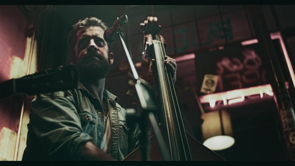

seku Posted March 16, 2019 Share Posted March 16, 2019 i was not happy with my early attempts either... kye, could you give me some honest feedback about this one? (i didn't bother denoising and regraining it, my question is more about gamma linearity, and quality of skintones and general balance) Link to comment Share on other sites More sharing options...
kye Posted March 17, 2019 Author Share Posted March 17, 2019 4 hours ago, seku said: kye, could you give me some honest feedback about this one? (i didn't bother denoising and regraining it, my question is more about gamma linearity, and quality of skintones and general balance) Sure! Firstly, I'll preface this by saying that I'm not an expert, and also that grading is subjective, so there's no right or wrong - only right or wrong for the project you're doing. Comparing my still with your two grades Your first grade: My grade: Your second grade: Here's what I'm seeing: The hue of the skin tones seems fine and matches across all three grades I look for skin tones in that middle-ground between yellow and pink and it's there I also look for a variation in hue because skin colour varies across different areas of the face and yours also has that It's the contrast of the skin tones is where they differ In my example the skin has far less contrast than on both of yours, I'm looking at how bright the lighter areas are compared to the darker areas. This also contributes to yours having slightly more saturation in skin tones too. Your second grade is much better in terms of exposure, with the first one being too bright and losing skin texture. I think you're meant to put skin tones at a certain gamma level (40 IRE?) and your second one is much better than your first, although both yours second and mine might both still be a bit light. I am constantly surprised by how dark skin tones are in professional situations. Looking at the wider image of your second grade vs my first grade Yours has slightly more overall contrast than mine with black and white points a bit more pushed apart Probably the main difference is in the contrast of the mid-tones where mine has less contrast, giving mine a more vintage feel The distribution of saturation is different too, mine looks to have more saturation in the mid-tones (look at the red/brown in the wood) but that might be because those items are lighter in mine and from a mathematical perspective they might be similar, however, the most saturation areas of yours seem to me more saturated than the most saturated areas of mine, for example the red light on the far left or the red umbrella directly above his head. However, the saturation of the other colours appears to be similar, look at the green lights or the coloured tassels hanging above the shrine. IIRC I might have deliberately played with the reds, and I definitely did a Sat vs Sat to boost saturation of mildly saturated tones without also boosting the more heavily saturated tones. Overall WB is very similar and you don't appear to have tinted the shadows or highlights. In terms of taste, I prefer mine as it is more flattering and a bit more vintage, but I suspect that if we were physically there yours might be more accurate with the level of contrast. Mine kind of looks 'nicer', both in skin tones (contrast on skin tones isn't flattering) as well as the overall look - the world that yours is from looks like a harsher and less friendly place to live. Hope that helps? Link to comment Share on other sites More sharing options...
seku Posted March 17, 2019 Share Posted March 17, 2019 Splendid kye, just what i needed to hear, a lot of thanks for the very detailled breakdown! I like contrast way too much for my own good, and it seems i am scared of images not "popping" enough, so i've got some unlearning to do. It's kinda scary to go to those low IRE but i gave it a go at around 30 IRE skintines... it looks horrible as a thumbnail, but fullscreen it *kinda* works... second screen is at 40 IRE : Link to comment Share on other sites More sharing options...

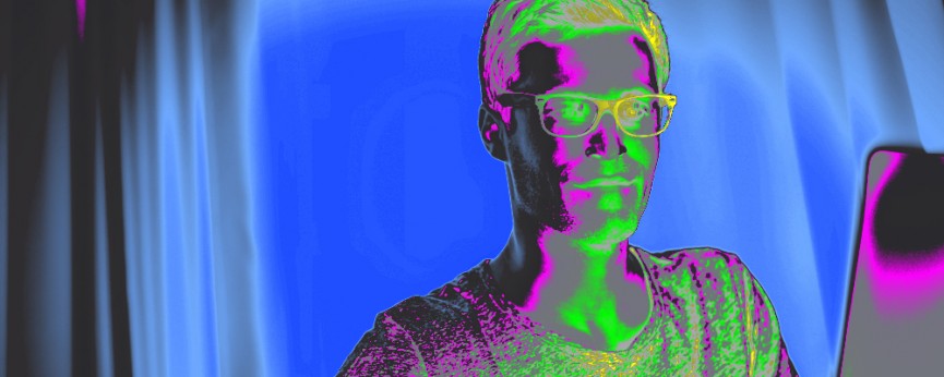

kye Posted March 17, 2019 Author Share Posted March 17, 2019 50 minutes ago, seku said: Splendid kye, just what i needed to hear, a lot of thanks for the very detailled breakdown! I like contrast way too much for my own good, and it seems i am scared of images not "popping" enough, so i've got some unlearning to do. It's kinda scary to go to those low IRE but i gave it a go at around 30 IRE skintines... it looks horrible as a thumbnail, but fullscreen it *kinda* works... second screen is at 40 IRE : Actually, I think that number is wrong, those do look a little dark for this scene. This article has some useful information: https://www.premiumbeat.com/blog/how-to-use-false-color-nail-skin-tone-exposure/ That shows that skin is in the 48-52 IRE level. This one is a bit more difficult because it's a lot more contrasty: But those levels really change if the image is high key like this one: or low key like this one: and this one has no skin tone - only shadows and highlights: I just make things look right. I wouldn't be too afraid of contrast either - Hollywood isn't afraid to absolutely crank it right up. I'd suggest pulling together a collection of reference images from skilled colourists Link to comment Share on other sites More sharing options...
seku Posted March 17, 2019 Share Posted March 17, 2019 yeah, it all is based on intent... it's no easy task I am also waiting for a couple of screens to arrive, that i want to use for scopes and false color. Btw, once you get to 50IRE, it becomes way punchier : kye 1 Link to comment Share on other sites More sharing options...
