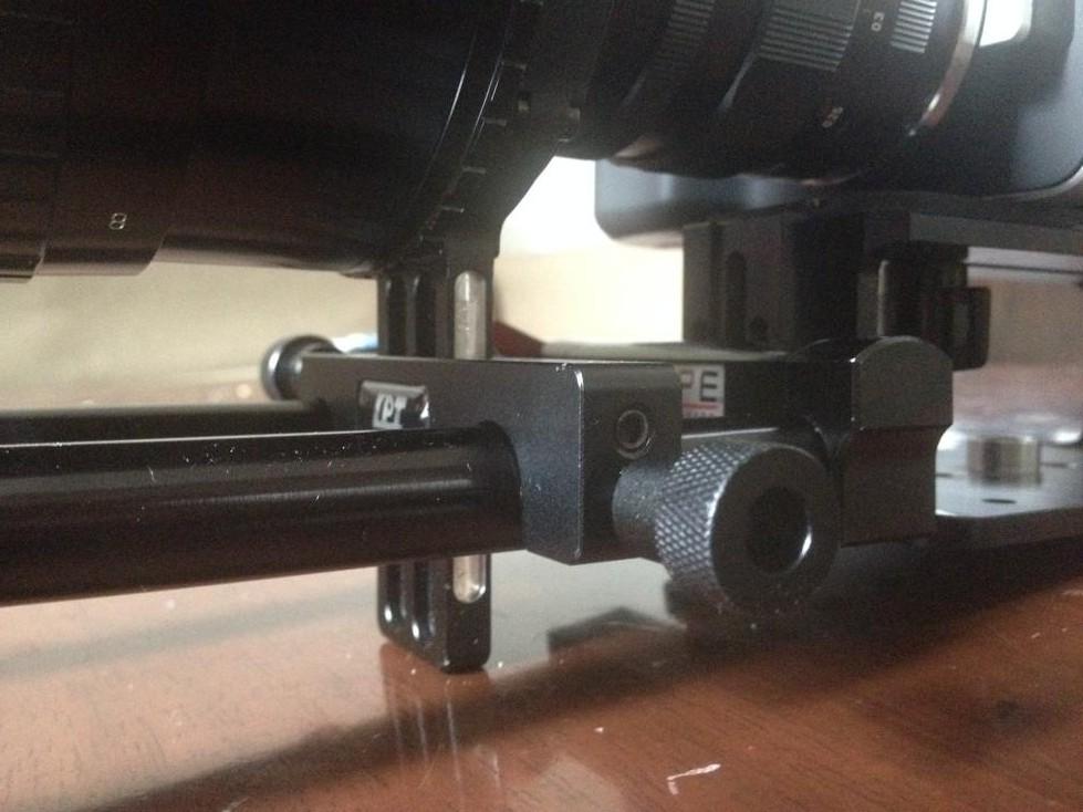

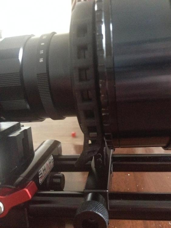

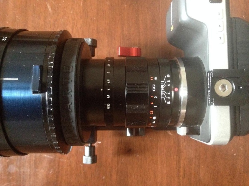

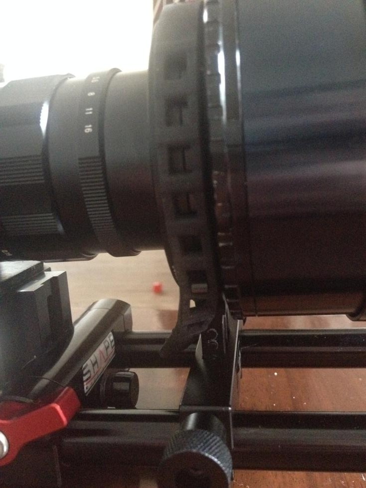

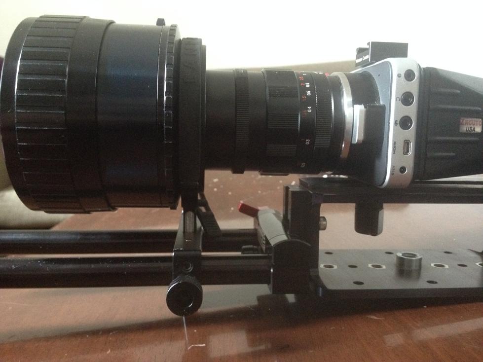

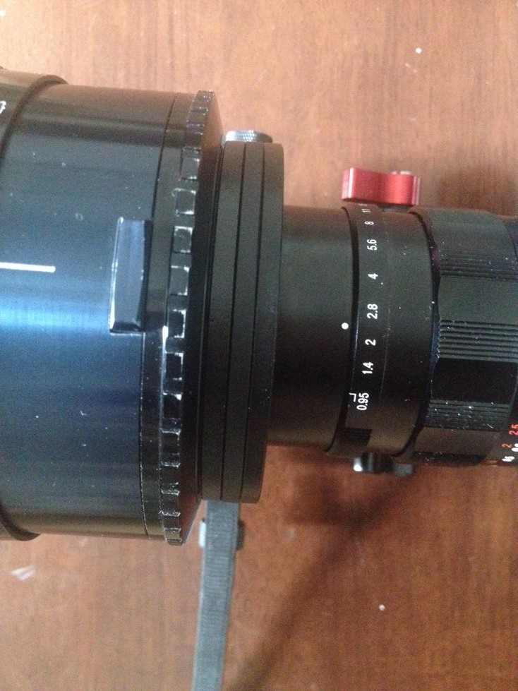

premini Posted January 1, 2015 Share Posted January 1, 2015 I finally bought a Lanparte support and does the job on my isco. This one:http://www.amazon.com/dp/B00JWV426Q/ref=sr_ph?ie=UTF8&qid=1420124099&sr=1&keywords=lanparte+lens+supportI put 2 adapter rings in the rear en of the ISCO one 77-72 and another 72-77, additionally i am using it with a 52mm front lens so i added a third 52-77 ring. I am attaching some pics... Quote Link to comment Share on other sites More sharing options...
