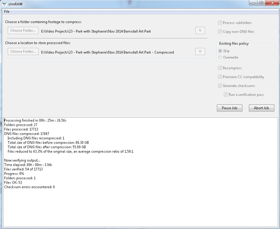

Emanuel Posted March 14, 2019 Share Posted March 14, 2019 5 hours ago, deezid said: Compression isn't even the issue here. Was using 4:1 cDNG all the time with fantastic results while Braw at Q0 still smudges texture, fine details, creates fringing and color bleeding issues as well as contrast halos around edges. It's just an internal processing issue and I really wish BMD could add a low or no internal processing option. What about the 6.1 firmware version + saving 63.3%? source: http://www.cineticstudios.com/blog/2015/7/slimraw-an-easy-method-to-save-space-with-cinemadng-footage.html According to my math you get 134 minutes of 4:1 into a 500GB SSD which is more space in disk than .braw 5:1 offers... Not bad if you have a capable machine to handle post, I guess, even though, slimraw promises a way faster workflow. deezid, amanieux and shooter 3 Link to comment Share on other sites More sharing options...

amanieux Posted March 14, 2019 Share Posted March 14, 2019 2 hours ago, Emanuel said: What about the 6.1 firmware version + saving 63.3%? this 1:58 slimraw compression result is lossless and the original was lossless cinemadng, correct ? Link to comment Share on other sites More sharing options...
Emanuel Posted March 14, 2019 Share Posted March 14, 2019 7 hours ago, amanieux said: this 1:58 slimraw compression result is lossless and the original was lossless cinemadng, correct ? Yes. No idea how it goes with 4:1, even though, the idea is to keep the original 4:1 quality. So, is there more space to save on disk? Maybe Mihail @cpc may drop a word here. I've called him on here but he seems to be offline so far though : -) shooter 1 Link to comment Share on other sites More sharing options...
cpc Posted March 15, 2019 Share Posted March 15, 2019 16 hours ago, amanieux said: this 1:58 slimraw compression result is lossless and the original was lossless cinemadng, correct ? This is most likely uncompressed source to losslessly compressed output. It also looks like a rather old version of slimraw. But if you want to know more about the various types of compression in the dng format, here is an overview: http://www.slimraw.com/article-cdngmodes.html (@Emanuel I am around, just not following the discussion closely ) shooter and Emanuel 1 1 Link to comment Share on other sites More sharing options...

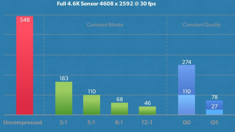

cpc Posted March 15, 2019 Share Posted March 15, 2019 4 hours ago, Emanuel said: I am looking for three levels quality to know: Quality A / QA: - Green screen for VFX work; Quality B / QB: - Motion picture acquisition for intense grading work towards movie theater screening; Quality C / QC: - Casual shooting for further use as stock footage to fit any serious professional project later on wherever platform is (including big screen/broadcast, printing stills, etc). I had found Q0, 5:1 and Q5 respectively the .braw answer to my needs. What about slimraw? This is very resolution dependent, but assuming 4k, the corresponding settings would be: lossless, 5:1, and 7:1 / VBR LT. Quote You wrote: "When shooting a Blackmagic camera which allows for both lossless and lossy raw with the intent of passing the raw footage through any of the slimRAW lossy compression modes it is best to record lossless CinemaDNG in camera". Does this mean should we avoid to record cDNG 4:1 or even 3:1 in-camera? Only if you'd use slimraw in a lossy mode afterwards. It is generally better to avoid multiple generations of lossy compression, and there are a few significant differences in how in-camera dng lossy compression works in comparison to slimraw's lossy compression. Quote If we use your VBR HQ (for my QB usage above) let's take 3.5:1 as average compression, once cDNG compression by Blackmagic rounds 1.6:1, we'll end with about 80 minutes (more or less in the .braw range), correct? Yes. Quote How can we extend that without losing any quality towards my QB table trying to match 5:1 at .braw side at least? Well, 5:1 is matched by 5:1. The meaning of these ratios is that you get down to around 1/5 of the original data size, which is the same no matter what format you are going to use. Quote Is it safe going with recompression? What slimraw setting? Would cDNG 4:1 or even 3:1 acquisition + VBR HQ be a possibility and safe enough to match my QB standard and goal? "Safety" is something only the user can judge. You are always losing something with lossy compression. It is "safe", in the sense that it is reliable, and it will work. VBR HQ will normally produce files between 4:1 and 3:1, but since it's constant quality/variable bit rate it depends somewhat on image complexity. Now, it is important to note that it is probably not a good idea to swap a BRAW workflow for a DNG workflow, unless you need truly lossless files (for VFX work, for example). Even though a low compression lossy DNG file will very likely look better than an equally sized BRAW frame (because by (partially) debayering in BRAW you increase the data size, and then shrink it back down through compression, while there is no such initial step in DNG; remember: debayering triples your data size!), this quality loss is progressively less important with resolution going up. Competing with BRAW is certainly not a goal for slimraw. There are basically 4 types of slimraw users: 1) People shooting uncompressed DNG raw: Bolex D16, Sony FS series, Canon Magic Lantern raw, Panasonic Varicam LT, Ikonoskop, etc. The go-to compression mode for these users is the Lossless 10-bit log mode for 2K video, or one of the lossy modes for higher resolution video. 2) People shooting losslessly compressed DNG on an early BM camera (Pocket, original BMCC, Production 4K) or on a DJI camera: these users normally offload with one of the lossy modes to reduce their footprint (often 3:1 or VBR HQ for the Pocket and BMCC, and 4:1/5:1 for the 4K). Lossless 10-bit log is also popular with DJI cameras. 3) People doing DNG proxies for use in post with Resolve. They are usually using 7:1 compression and 2x downscale for a blazing fast entirely DNG based workflow in Resolve (relinking in Resolve is a one-click affair and you can go back-and-forth between originals and proxies all the time during post). 4) People shooting BM cameras and recording 3:1 or 4:1 CDNG for longer recording times, who do their post in Premiere. They use slimraw to transcode back to lossless CinemaDNG in post and import the footage in Premiere. Of course, there are other uses (like timelapses, or doing lossless-to-lossy on a more recent BM camera, if you are a quality freak (a few users are), slimraw will beat in-camera for the same output sizes, which is expected -- it doesn't have the limitations of doing processing in-camera), but these are less common. So yeah, if you don't need VFX, it is likely best to just stick to BRAW and don't complicate your life. Emanuel and shooter 2 Link to comment Share on other sites More sharing options...
Emanuel Posted March 15, 2019 Share Posted March 15, 2019 3 hours ago, cpc said: This is very resolution dependent, but assuming 4k, the corresponding settings would be: lossless, 5:1, and 7:1 / VBR LT. Yes, 4K: DCI and UHD. OK, so let's set up 5:1 compression as big screen requirement for 4K then. I've also arrived to similar conclusion as reported. 3 hours ago, cpc said: Only if you'd use slimraw in a lossy mode afterwards. It is generally better to avoid multiple generations of lossy compression, and there are a few significant differences in how in-camera dng lossy compression works in comparison to slimraw's lossy compression. Which means better to avoid lossy compression in-camera? 3 hours ago, cpc said: Well, 5:1 is matched by 5:1. The meaning of these ratios is that you get down to around 1/5 of the original data size, which is the same no matter what format you are going to use. I meant quality-wise. .braw seems lower quality, I bet. 3 hours ago, cpc said: "Safety" is something only the user can judge. You are always losing something with lossy compression. It is "safe", in the sense that it is reliable, and it will work. VBR HQ will normally produce files between 4:1 and 3:1, but since it's constant quality/variable bit rate it depends somewhat on image complexity. Now, it is important to note that it is probably not a good idea to swap a BRAW workflow for a DNG workflow, unless you need truly lossless files (for VFX work, for example). Even though a low compression lossy DNG file will very likely look better than an equally sized BRAW frame (because by (partially) debayering in BRAW you increase the data size, and then shrink it back down through compression, while there is no such initial step in DNG; remember: debayering triples your data size!), this quality loss is progressively less important with resolution going up. Competing with BRAW is certainly not a goal for slimraw. Competition is part of the game. Impossible to not compete if you offer something better. 3 hours ago, cpc said: There are basically 4 types of slimraw users: 1) People shooting uncompressed DNG raw: Bolex D16, Sony FS series, Canon Magic Lantern raw, Panasonic Varicam LT, Ikonoskop, etc. The go-to compression mode for these users is the Lossless 10-bit log mode for 2K video, or one of the lossy modes for higher resolution video. 2) People shooting losslessly compressed DNG on an early BM camera (Pocket, original BMCC, Production 4K) or on a DJI camera: these users normally offload with one of the lossy modes to reduce their footprint (often 3:1 or VBR HQ for the Pocket and BMCC, and 4:1/5:1 for the 4K). (...) Does this mean the lower resolution the lower compression needed? Quote Lossless 10-bit log is also popular with DJI cameras. Why not with Blackmagic cameras too? 3 hours ago, cpc said: 3) People doing DNG proxies for use in post with Resolve. They are usually using 7:1 compression and 2x downscale for a blazing fast entirely DNG based workflow in Resolve (relinking in Resolve is a one-click affair and you can go back-and-forth between originals and proxies all the time during post). How to not see it as serious contender to the .braw workflow?! : ) 3 hours ago, cpc said: 4) People shooting BM cameras and recording 3:1 or 4:1 CDNG for longer recording times, who do their post in Premiere. They use slimraw to transcode back to lossless CinemaDNG in post and import the footage in Premiere. Won't this save disk space in the end? If so, how much will the ratio be? 3 hours ago, cpc said: Of course, there are other uses (like timelapses, or doing lossless-to-lossy on a more recent BM camera, if you are a quality freak (a few users are), slimraw will beat in-camera for the same output sizes, which is expected -- it doesn't have the limitations of doing processing in-camera), but these are less common. So yeah, if you don't need VFX, it is likely best to just stick to BRAW and don't complicate your life. LOL I guess there's a quality freak inside each P4K owner... ; ) In conclusion, what's the best method to save bytes as highest quality as possible other than VFX? Lossless cDNG in-camera acquisition + Lossy 5:1 as for instance? Or some other compression ratio? -- What else then? 4:1 or 3:1 cDNG (any of both obviously lossy modes) in-camera recording + slimraw later on towards to archive / post? -- If so, what setting route? Lossless (slimraw)? What additional compression ratio? Let's put big screen and intense color correcting / grading without the need of VFX as only paradigm now. shooter 1 Link to comment Share on other sites More sharing options...

cpc Posted March 17, 2019 Share Posted March 17, 2019 22 hours ago, Emanuel said: In such case, is slimraw able to match braw file sizes as well the same amount of minutes length as for instance for 4K DCI 24fps 5:1 compression around the 110-120 minutes range per 500GB? Quality-wise, enough for movie theater screening with intense color correction / grading work even though without VFX needs? Yes, a couple of hours of 4K at 5:1 should be somewhere under 500GB. I usually recommend 5:1 for oversampled delivery only (i.e. when shooting 4K or higher, but going for a 2K DCP). I know some users routinely use 5:1 for 4K material and are happy with it, but I am a bit conservative about this. I'd imagine most indie work ends up with a 2K DCP anyway (well, at least anything I've shot that ended in a theater has always been 2K). Link to comment Share on other sites More sharing options...
Emanuel Posted March 17, 2019 Share Posted March 17, 2019 9 minutes ago, cpc said: Yes, a couple of hours of 4K at 5:1 should be somewhere under 500GB. I usually recommend 5:1 for oversampled delivery only (i.e. when shooting 4K or higher, but going for a 2K DCP). I know some users routinely use 5:1 for 4K material and are happy with it, but I am a bit conservative about this. I'd imagine most indie work ends up with a 2K DCP anyway (well, at least anything I've shot that ended in a theater has always been 2K). What maximum compression ratio would you recommend in order to a 4K DCP with no need of VFX? Link to comment Share on other sites More sharing options...
