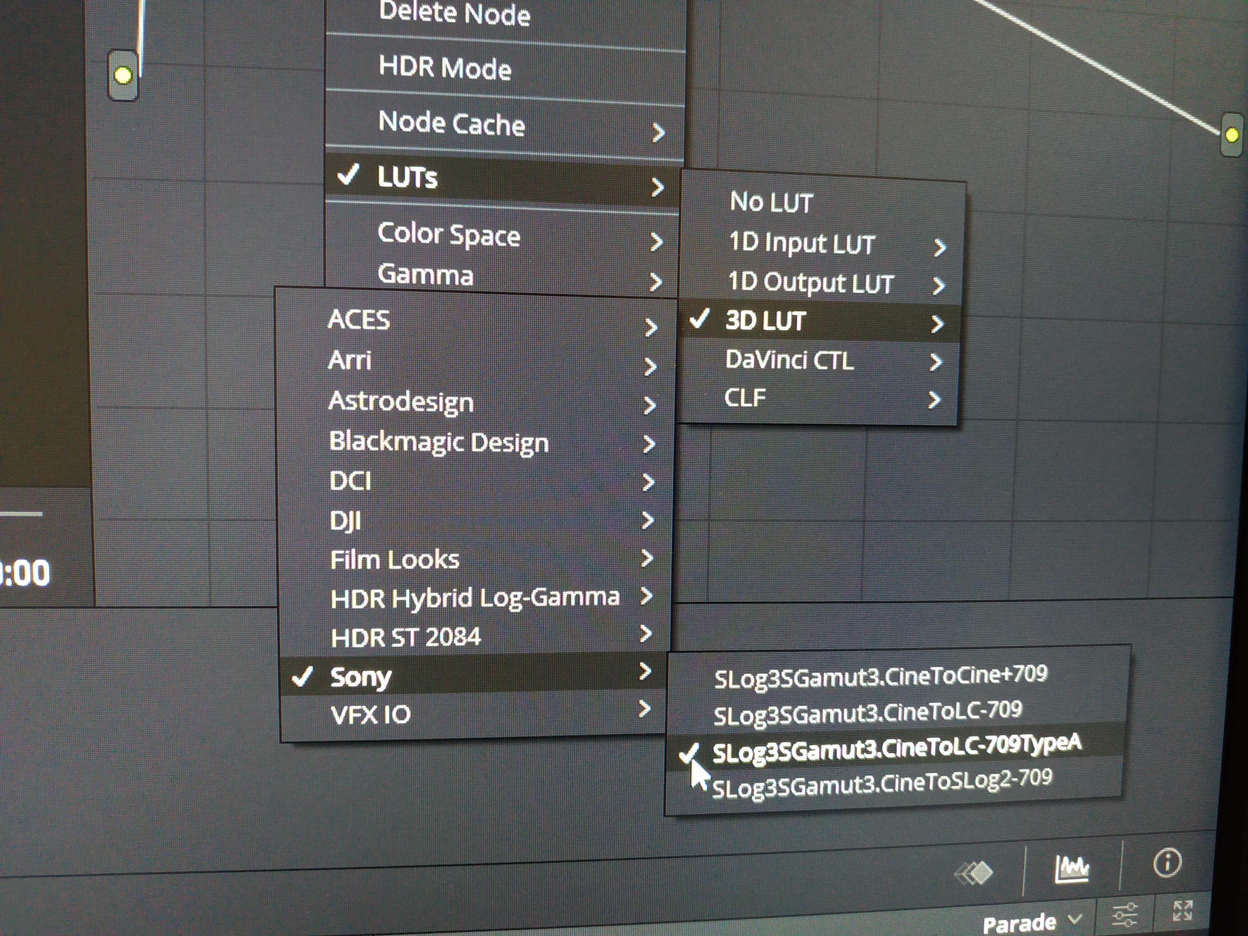

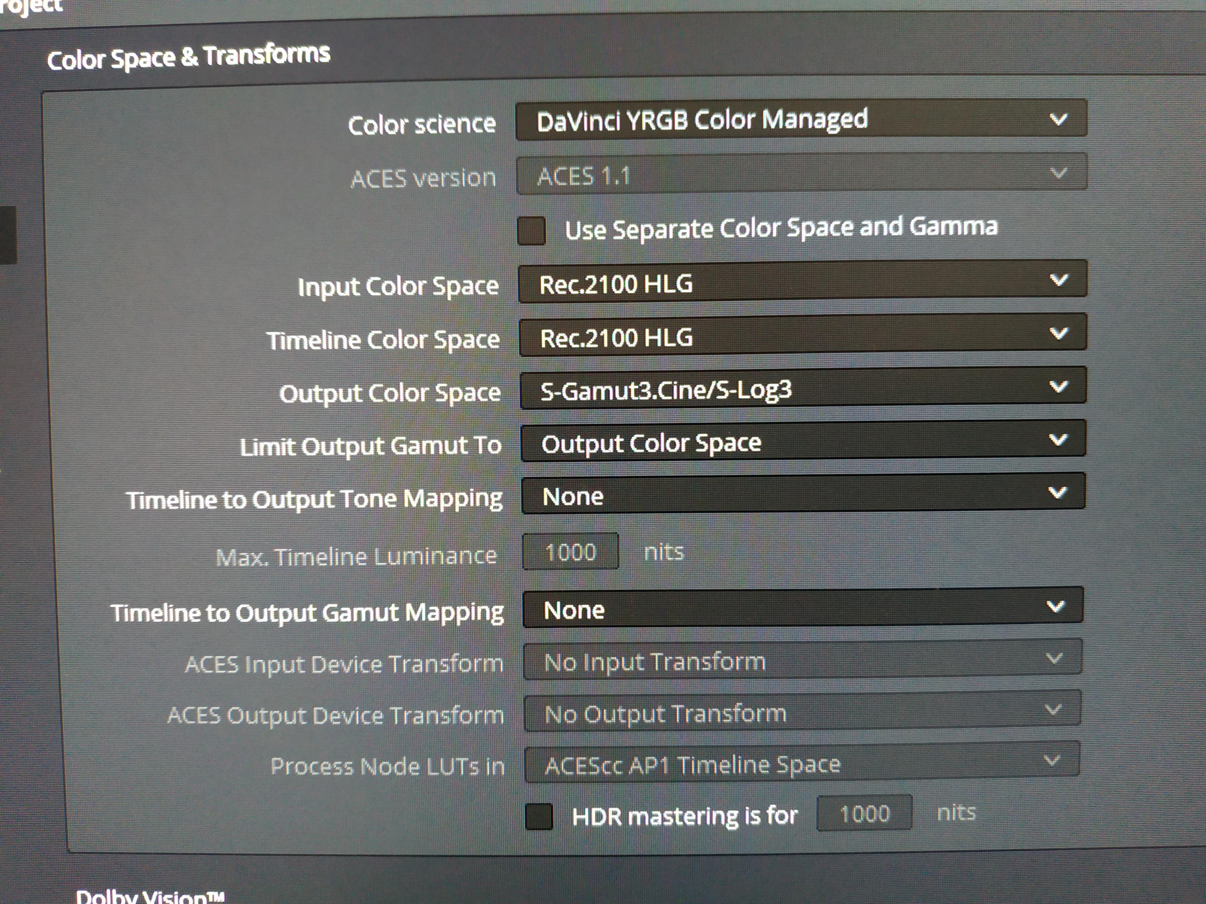

omega1978 Posted March 9, 2019 Share Posted March 9, 2019 11 hours ago, Laurier said: I saw people doing color space transforms to Alexa , it work quite well. But the thing is that Sony basically said that the Venice sensor is the a9 sensor. So my reasoning is that the a9 sensor output very similar colors as the a7iii and a fair amount of the cine Alta color science is actually in the last LUT they provided. Since IMO the slog3 is unusable on the A7iii, using color space transform just to remap the colors from HLG to slog3 give you the best of both world , a profile easy to expose with a lot of DR and the best colors science Sony have to offer . It s definitely nicer on the skin tones and the green colors when you shoot nature . How do you set the project in resolve to do the conversion? In this way: Link to comment Share on other sites More sharing options...

Laurier Posted March 9, 2019 Share Posted March 9, 2019 6 hours ago, omega1978 said: How do you set the project in resolve to do the conversion? In this way: No , you leave the project settings as default, Color space transform is a effect node as seen here : https://ibb.co/YyX97PD and you need the following lut : http://www.hingsberg.com/downloads/2018/s709_cube_V200.zip Cheers Link to comment Share on other sites More sharing options...
omega1978 Posted March 10, 2019 Share Posted March 10, 2019 10 hours ago, Laurier said: No , you leave the project settings as default, Color space transform is a effect node as seen here : https://ibb.co/YyX97PD and you need the following lut : http://www.hingsberg.com/downloads/2018/s709_cube_V200.zip Cheers Thank you, i will give it a try! Link to comment Share on other sites More sharing options...
