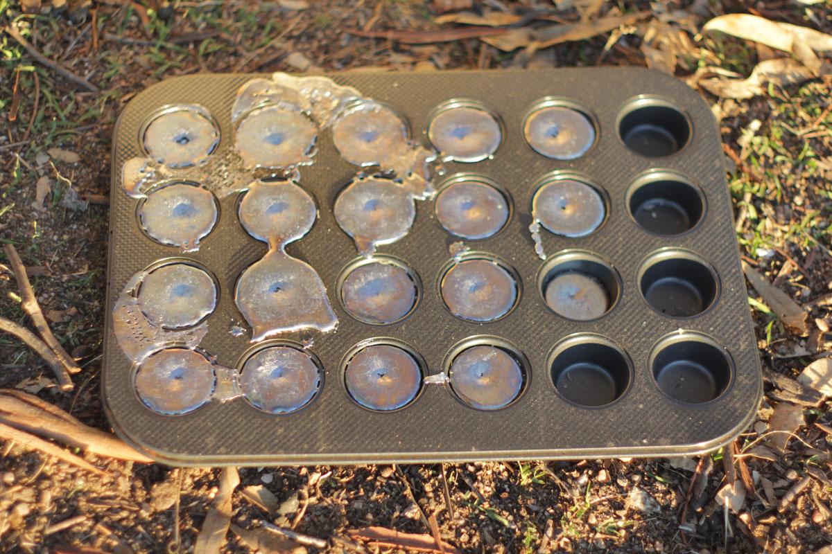

Super Members BTM_Pix Posted June 22, 2019 Super Members Share Posted June 22, 2019 9 minutes ago, leslie said: If I ever visit you, I'll have to remind myself not to take up any offer of a home made cupcake. leslie 1 Link to comment Share on other sites More sharing options...
leslie Posted June 22, 2019 Author Share Posted June 22, 2019 6 minutes ago, BTM_Pix said: If I ever visit you, I'll have to remind myself not to take up any offer of a home made cupcake. watching utube pretty much every one uses the mini muffin trays to cast lead ingots or alloy ingots. I think the king or random started it, but i ran with the herd anyway ? and it has been quite a learning experience. It seems like i have an interesting assortment of things that i want to do to tick of my bucket list ? i have an area set aside about 100 meters from the house for experiments and i'm pretty keen to keep them both separated don't worry about that BTM_Pix and kye 2 Link to comment Share on other sites More sharing options...
kye Posted June 22, 2019 Share Posted June 22, 2019 23 minutes ago, BTM_Pix said: If I ever visit you, I'll have to remind myself not to take up any offer of a home made cupcake. They're not the softest, but what they lack in enjoyability they make up for in shelf life! BTM_Pix 1 Link to comment Share on other sites More sharing options...

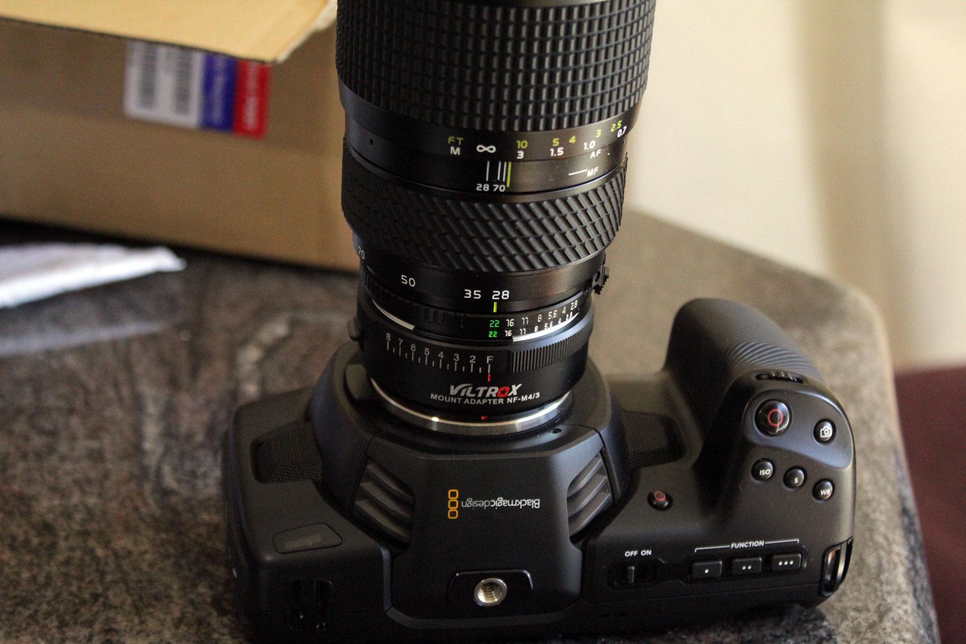

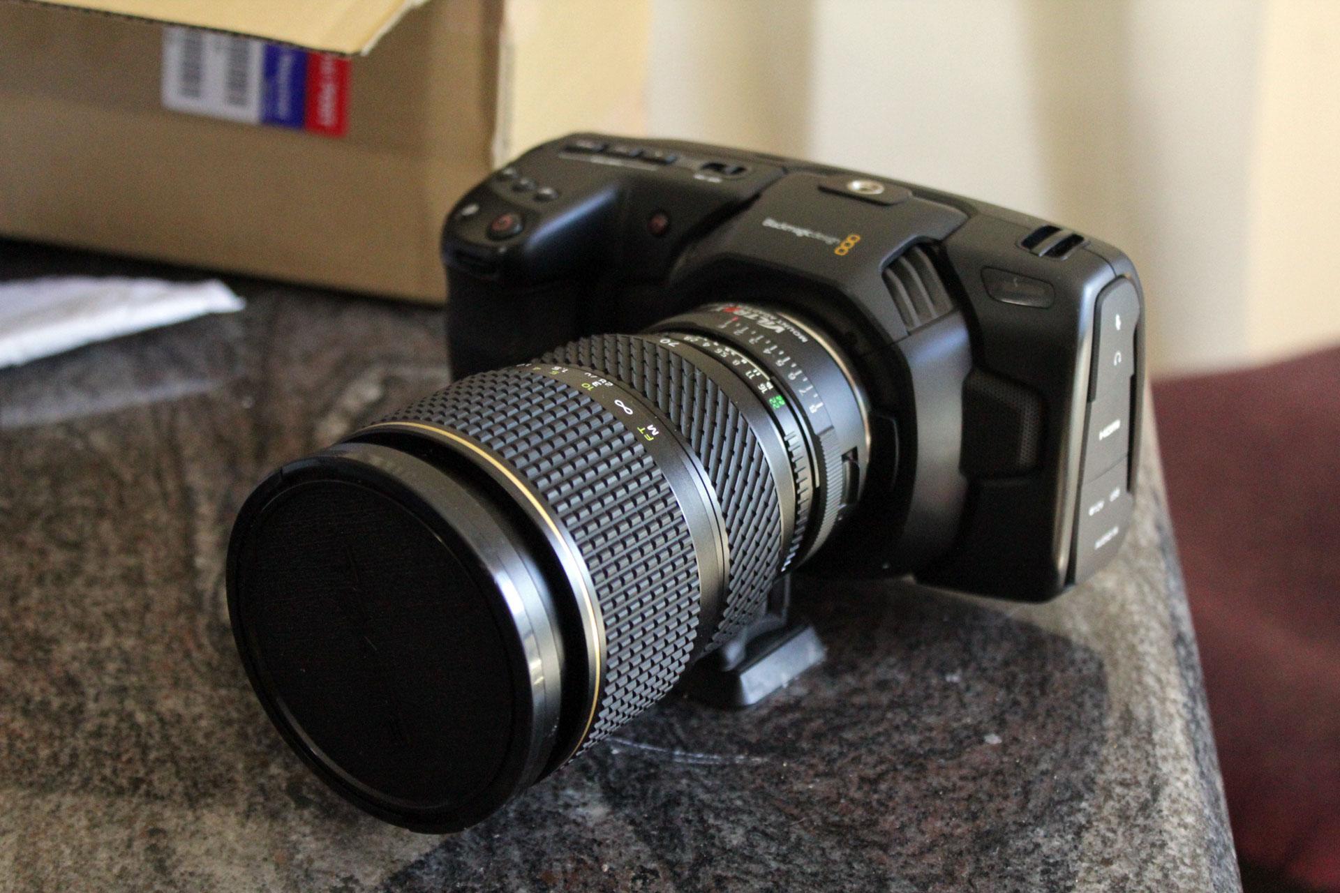

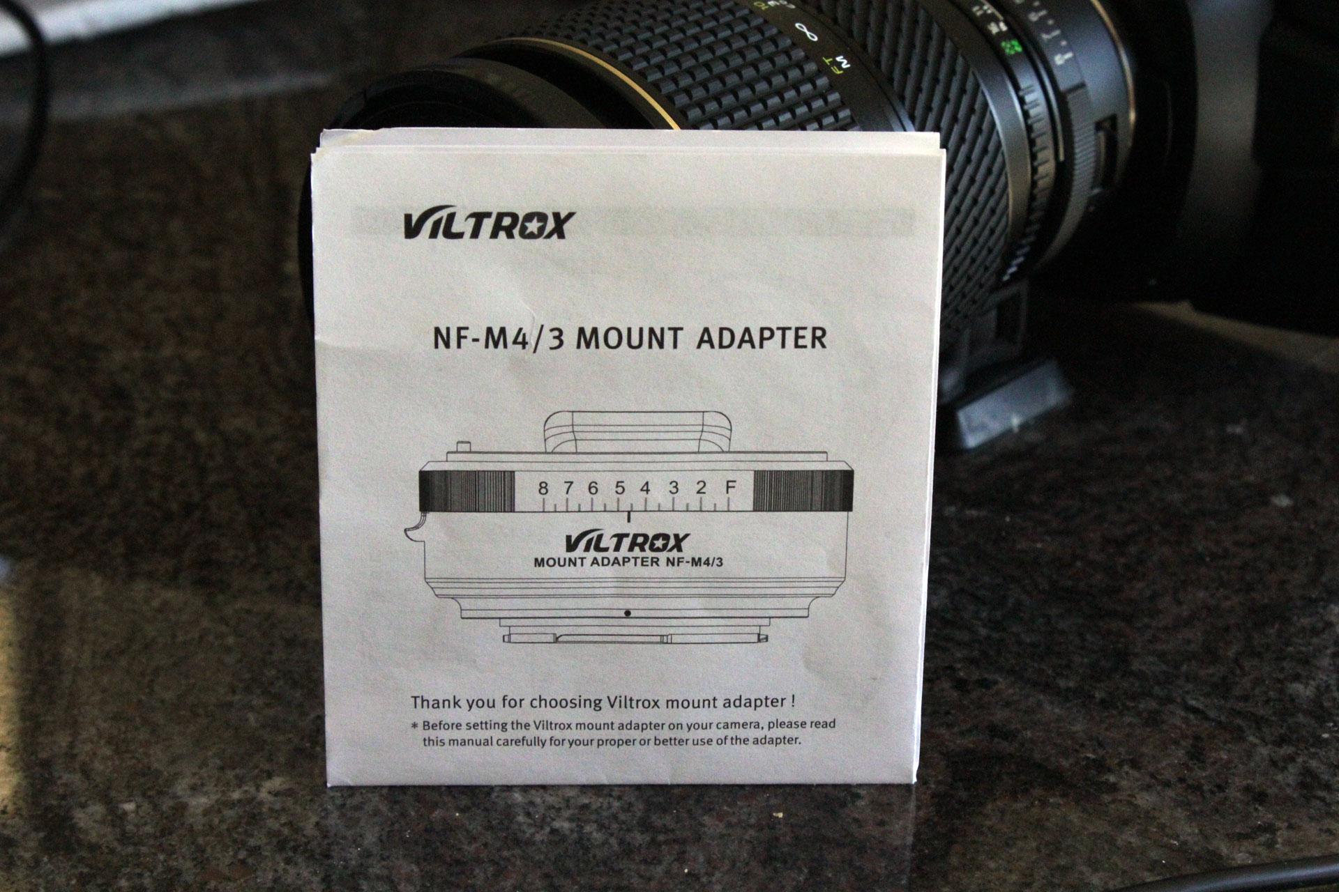

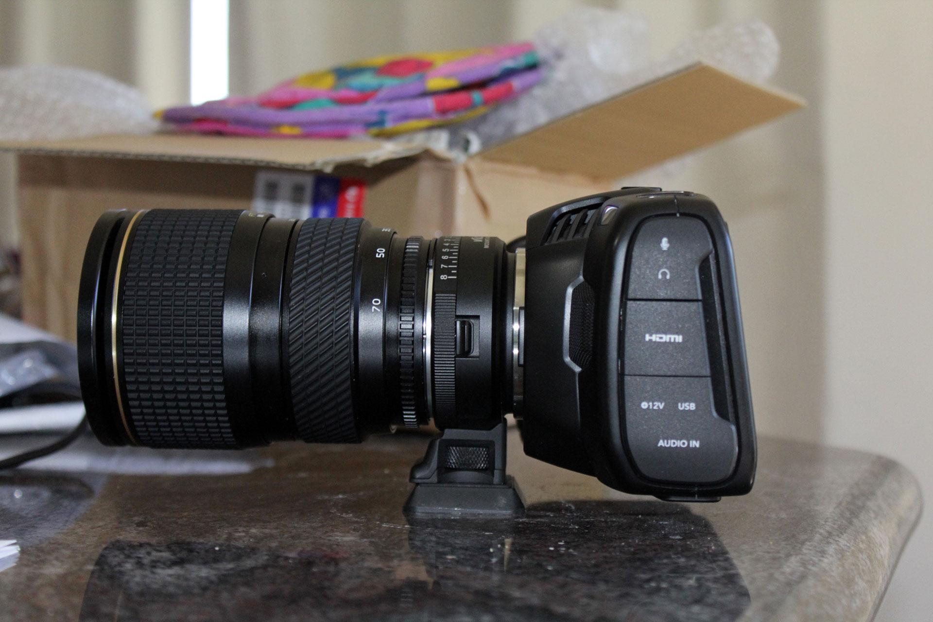

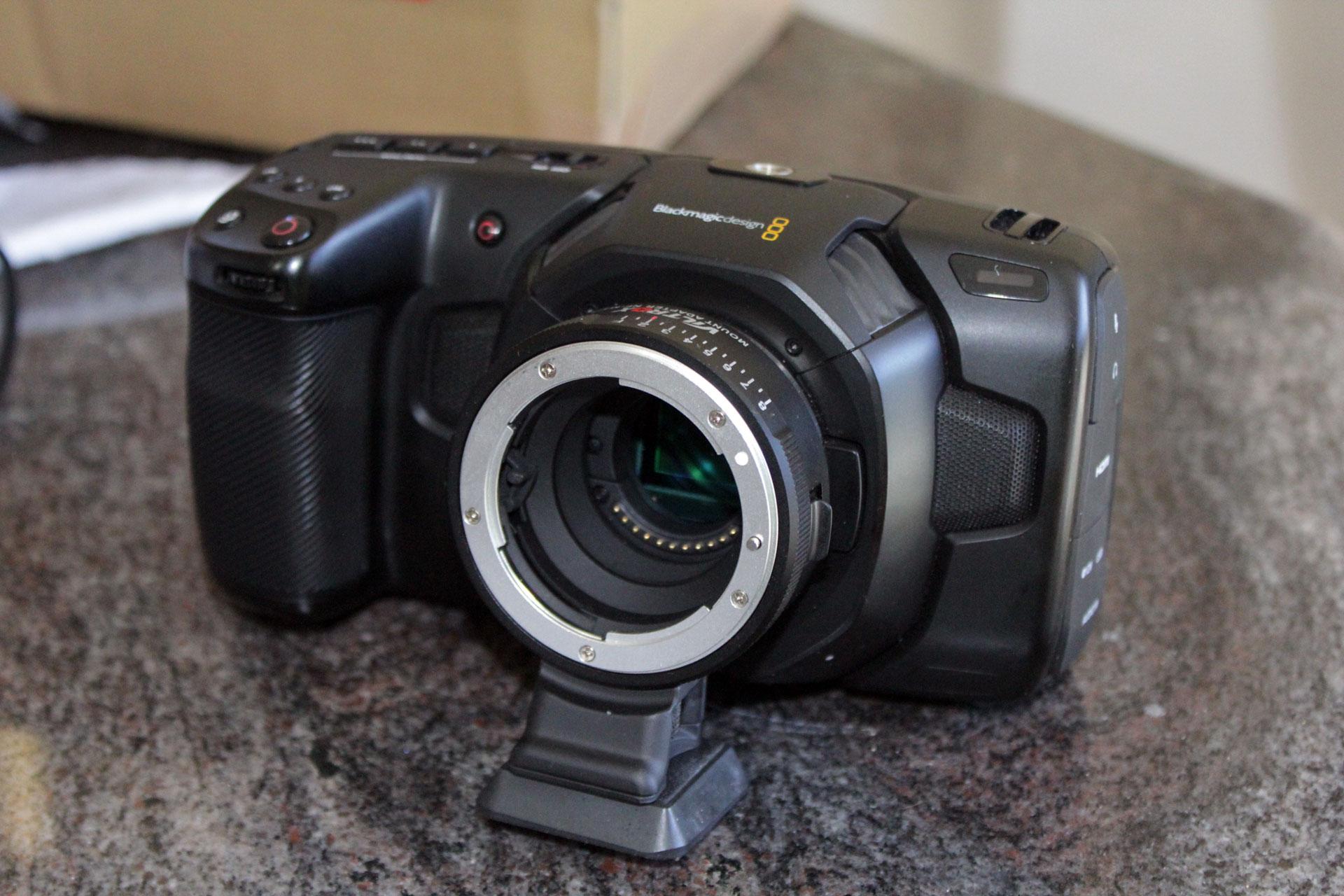

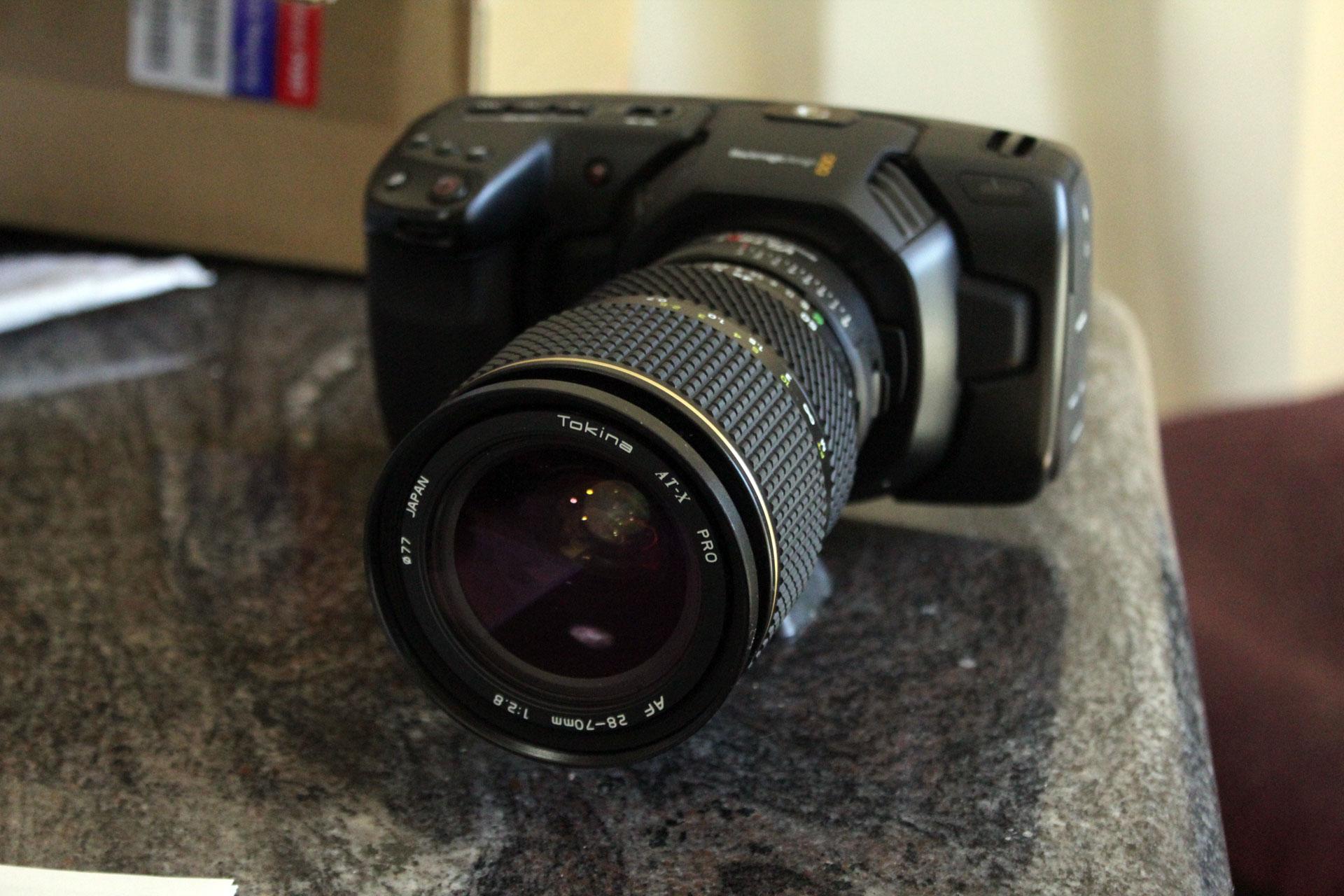

leslie Posted July 30, 2019 Author Share Posted July 30, 2019 Ok so my tokina 28-70 turned up last week and the vitrox adapter arrived on friday. Spent some time with both on the bmp4k over the weekend. This viltrox is the most expensive adapter i have bought so far most others have been dumb cheap adapters ( read that as really cheap ) for my pentax m42 lenses. the viltrox fits onto the tokina lens very snugly no play, sadly cant say the same about the fit to the bmp4k there is some rotational play there. I understand that manufactures need to make allowances for tolerances but i think bm could have make things a bit tighter on the mount front. So far thats been my only thing that seems to bug me about the bmp4k and various lenses that i mount to it. I'm really starting to like the tokina 28-70mm zoom even with the brief amount of play time. I'm thinking this may quickly become a favorite lens. The viltox has a tripod socket foot that does that screws up onto the adapter with a thumbscrew. However i'm either a 300 pound weakling or the thumbscrew doesn't screw up as tight as i would like as i get a little bit of side to side movement when attached to a tripod. i am going to try living with it for awhile but i think i'lll end up getting a local welder to spot weld it or something. i new it was a smart mount when i bought it but was unsure if it would work on the p4k. The viltrox has something like an aperture ring that goes from f to 8 which is similar to your normal aperture ring except instead of being say f2.6 - f22 it goes f-1,2,3,4,5,6,7,8 i guess it correlates close enough for a human mind to interpret. With out reading the manual the adapter will change the nikon aperture from the ring on the vitrox adapter but not from the bmp4k. With the tripod socket foot attached and the tokina on the front, the camera seems balanced enough to sit flat without tipping forwards or backwards but pick it up and its a touch heavier on the lens. i have included a bunch of dng stills converted to jpegs for your perusal. Probably the next thing on the agenda is a speed booster which is what i will be looking into next, as i'm not really a fan of the 2x crop of the p4k, maybe the viltox one. Apart from the movement from the foot socket i quite like the viltrox adapter. I did find some dirt or something inside the tokina lens when i first looked through it, not attached to the camera when zooming however it doesn't seem to show attached to the camera, maybe i should do some pixel peeping. If i can find a good localish service center i would be tempted to get it cleaned. edit: by the way i got the nikon version, as far as i'm aware only the nikon and the pentax versions have an aperture ring, the others are controlled by the camera feel free to correct me i am wrong. kye and JordanWright 2 Link to comment Share on other sites More sharing options...
kye Posted July 30, 2019 Share Posted July 30, 2019 That's a more compact setup than the anamorphic frankenstein rigs you've posted before! (although the images they make are probably lovely...) Link to comment Share on other sites More sharing options...

Kisaha Posted July 30, 2019 Share Posted July 30, 2019 @leslie What adapter is that? The EF-M1? Have you not tried any more modern lens to check how the electronics work between the lens and the camera? You bought the adapter for just this one lens? Don't you have other lenses on different mounts? The 2X crop is not an issue, per se, when you use native lenses. I will be ordering the 12-100mm 4f Olympus which is a great all arounder going 24-200mm with great manual focus mechanism and amazing build quality. Sorry from brining it up again, but I hate bowl cancer. I hate it down to my stomach. Link to comment Share on other sites More sharing options...
leslie Posted July 31, 2019 Author Share Posted July 31, 2019 The adapter I bought is a viltrox nikon to m4/3. When I say expensive (read that as about $40 ) the other adapters have been half that or less. My lens collection consists of a few Fd lenses from the days of my film photography and a whole bunch of Pentax m42 lenses I bought and adapted for use on my canon 60d plus the Nikon 28-70mm I just got. I don't have any modern lenses apart from the 18-55 kit lens that came with the 60d. A few native lenses for the bmp4k would be awesome no doubt however they tend to be more expensive or pricier than I can afford when I look at such things. Maybe I'm just bad at budgeting lol. My approach to buying lenses may not have been well structured. It kinda took a left turn after getting the p4k with its 2x crop factor which makes nearly all my lenses, telephoto lenses barring the 24mm i have. It is what it is. I'm thinking I'll get a speedbooster next, that will gain me back a little ground so to speak. After that I'll look at some native lenses or a single focus solution for my anamorphic lens. Actually I'll probably go with getting a single focus solution Link to comment Share on other sites More sharing options...
kye Posted July 31, 2019 Share Posted July 31, 2019 17 hours ago, leslie said: What have you got against Frankenstein? Nothing, but as a hand-held shooter and as a wanna-be minimalist I do appreciate a light/compact/simple setup, and the Viltrox is much more in that direction! 4 hours ago, leslie said: The adapter I bought is a viltrox nikon to m4/3. When I say expensive (read that as about $40 ) the other adapters have been half that or less. My lens collection consists of a few Fd lenses from the days of my film photography and a whole bunch of Pentax m42 lenses I bought and adapted for use on my canon 60d plus the Nikon 28-70mm I just got. I don't have any modern lenses apart from the 18-55 kit lens that came with the 60d. A few native lenses for the bmp4k would be awesome no doubt however they tend to be more expensive or pricier than I can afford when I look at such things. Maybe I'm just bad at budgeting lol. My approach to buying lenses may not have been well structured. It kinda took a left turn after getting the p4k with its 2x crop factor which makes nearly all my lenses, telephoto lenses barring the 24mm i have. It is what it is. I'm thinking I'll get a speedbooster next, that will gain me back a little ground so to speak. After that I'll look at some native lenses or a single focus solution for my anamorphic lens. Actually I'll probably go with getting a single focus solution My most recent lens purchase was an FD lens and it's very nice, plus I have a bunch of manual m42 lenses which are awesome too. If you're willing to go manual there is a huge backlog of gems just waiting to be resurrected and to create magic again Link to comment Share on other sites More sharing options...

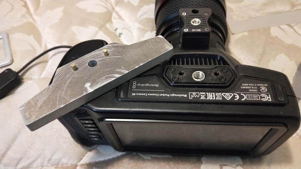

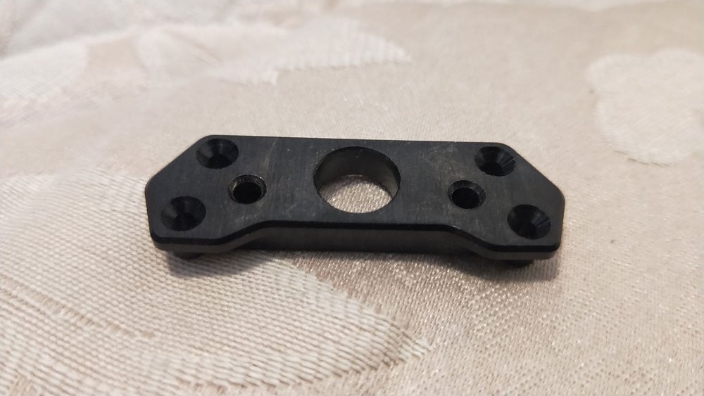

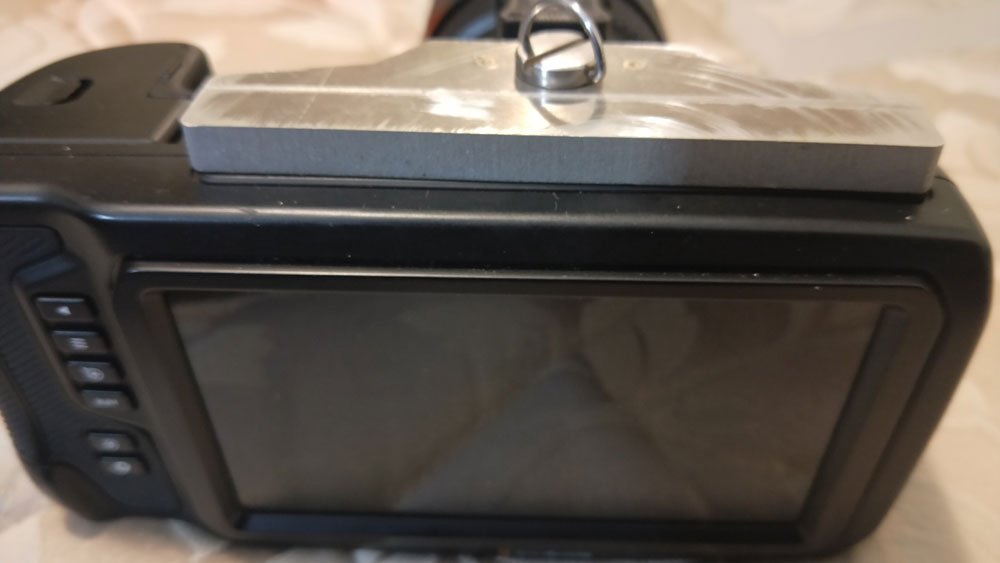

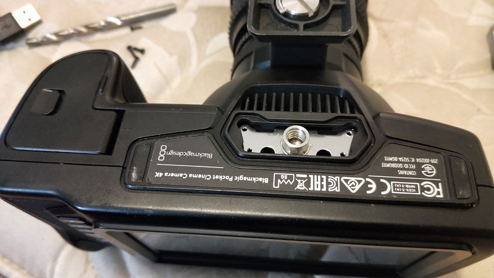

leslie Posted September 13, 2019 Author Share Posted September 13, 2019 made some time today for the p4k tripod base i have working towards. Had some 3mm brass rod turn up in the mail. It seems the holes in the bottom of the p4k are a little bigger than the 3mm i thought they were, maybe 3.2. there was a little wiggle room, which was what i was trying to avoid in the first place. by happenstance hitting a center punch to expand the base of the brass rod in the bottom of the alloy plate to get a nice tight fit, flattened the top of the brass rod for a snug fit into the p4k holes. I didn't even need to file anything down either. I'm nearly as handy with a hammer as thor ? I have yet to countersink a hole for the tripod bolt to sit flush maybe tomorrow. then i have to recess the alloy plate into the plastic base i have made earlier Link to comment Share on other sites More sharing options...

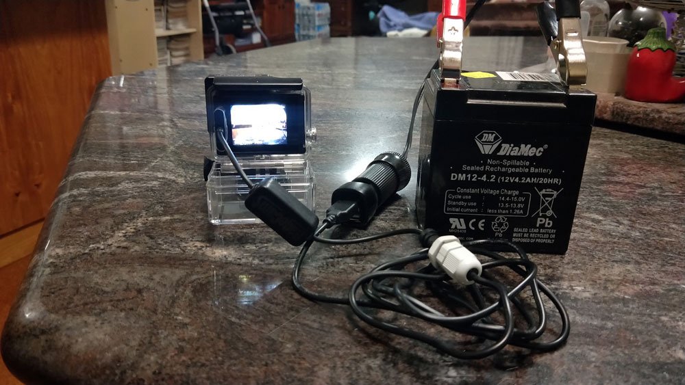

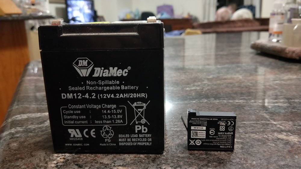

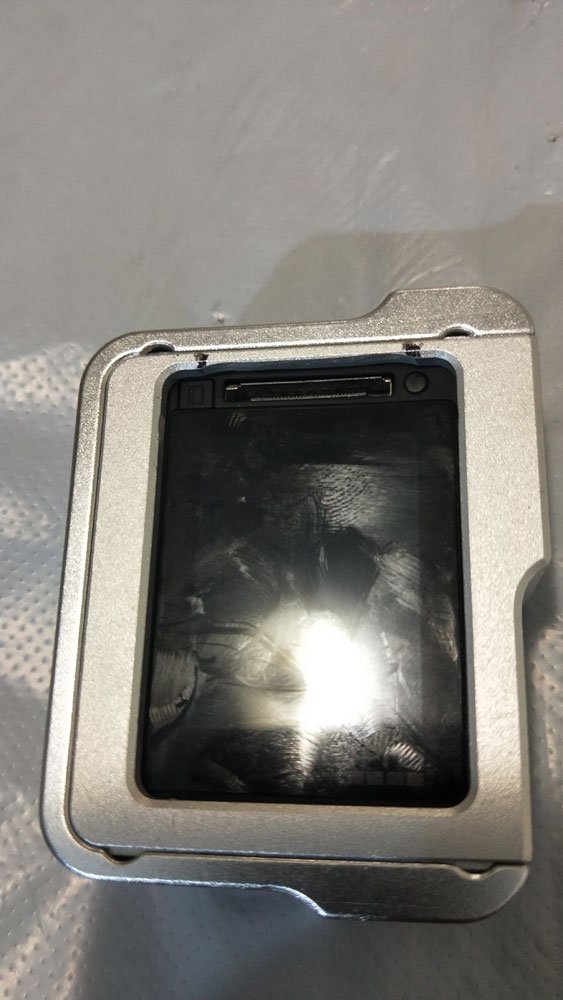

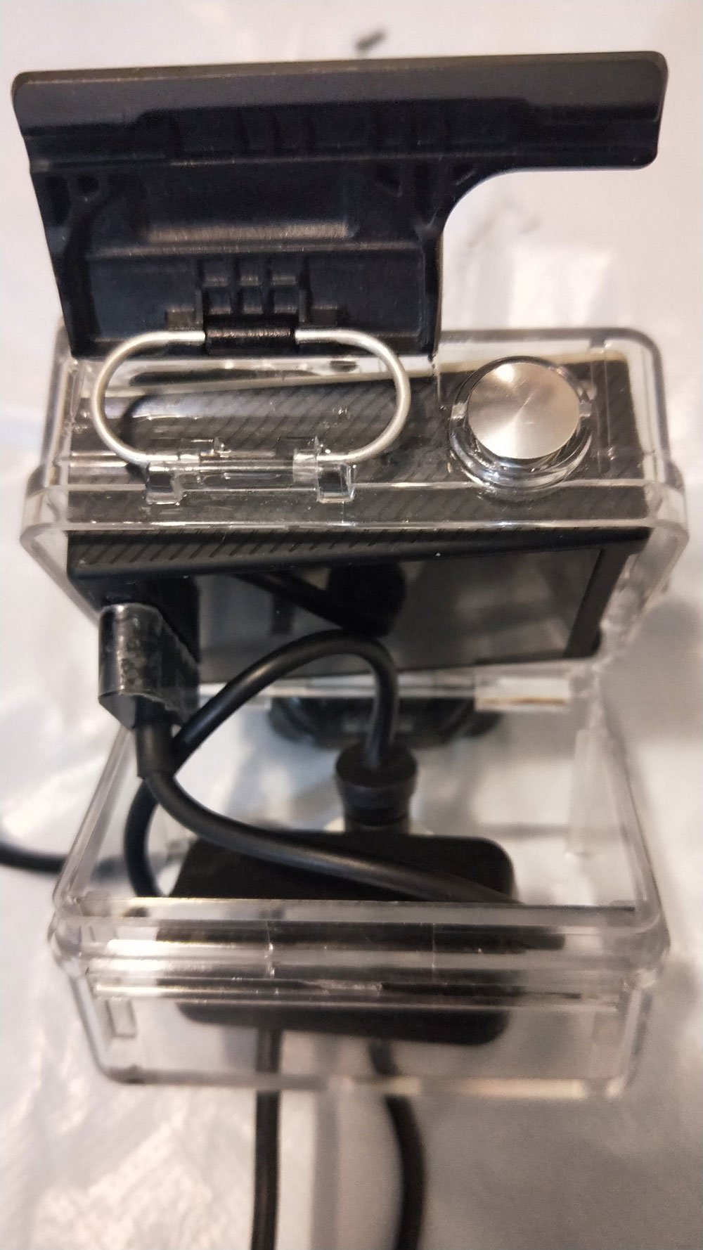

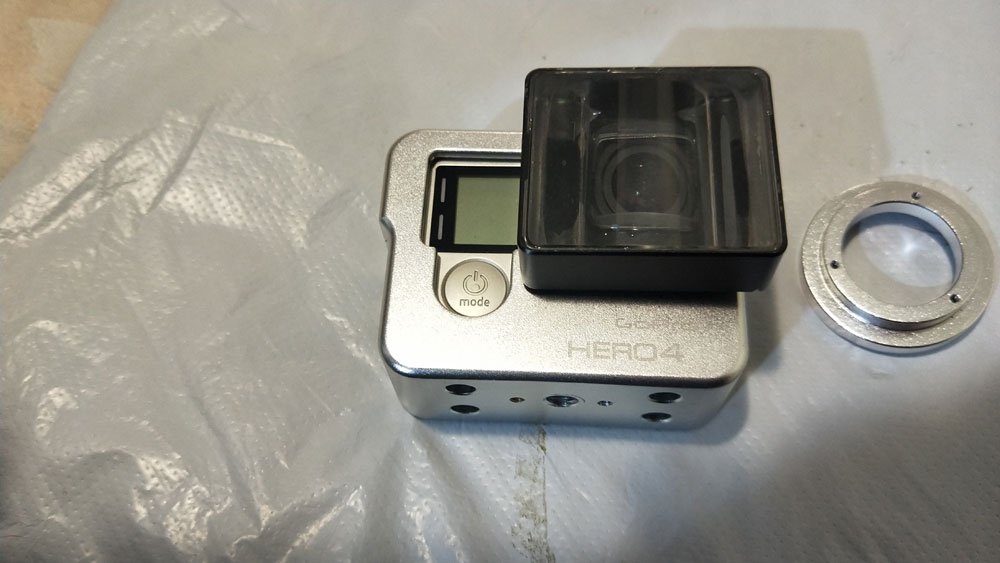

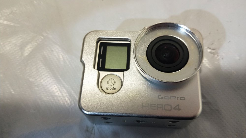

leslie Posted September 13, 2019 Author Share Posted September 13, 2019 I will now horrify some of you with a five letter word. That word is Gopro, if your offended you should look away now. A little while ago i bought the rage cam battery eliminator for the gopro4. I have had it a couple of weeks now, been considering it, the idea is good, however the implementation of that idea is a bit ordinary. Rage cam solution to eliminating a battery is to supply you with an extra deep plastic back, that snaps on in place of the old back door. i have no issues with that. The issue is the cabling they supply, no matter how you wind it, fold it or arrange it. It doesn't sit flat or fold away inside that extra wide plastic back very neatly at all. Honestly i cant see how those connections are going to last any significant amount of time before they fail with the strain placed upon them. Some of the blame probably resides with gopro themselves that connection is too close to the edge as soon as you put in in a housing the plug won't fit, not without breaking out the dremel any way, which is what i have been doing this afternoon. My intention is to have two housings, one water resistant the other a simple alloy frame. the standard plastic housing with the modified back will be used out doors when getting it wet would be a concern. the alloy housing for when i'm not so worried about water and maybe heat might be a concern. the standard housing usually has the letus anamorphic mounted to it, i took it off this afternoon to investigate how i might easily mount it to the alloy housing. Heres a bunch of photos so you can see what i'm up too. I have started removing material away from the edge of the alloy frame however i need to proceed slowly as i'm going to have about 1mm left i think on the back piece that slides into the frame. Link to comment Share on other sites More sharing options...

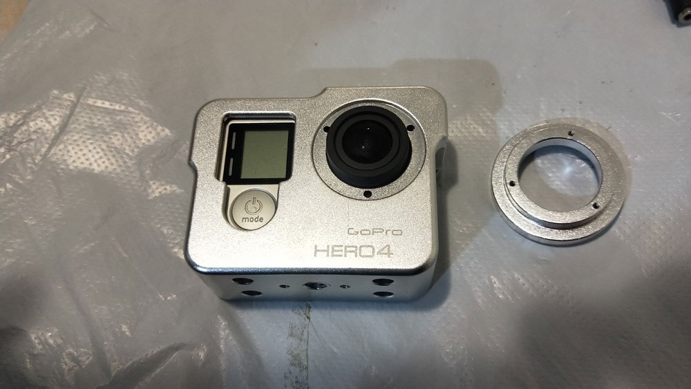

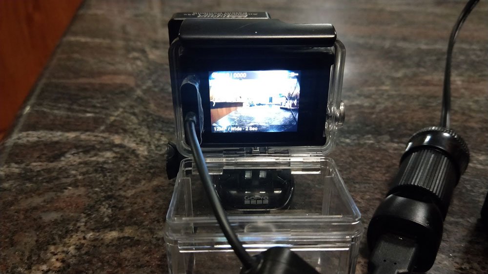

leslie Posted October 4, 2019 Author Share Posted October 4, 2019 still on a slight detour, i'm pleased to say, it lives. final pieces purchased and connected up. This is one project nearly completed apart from cutting a slot in the housing for the connector to slide through as i'm unimpressed with the stresses placed upon the cable as you weave it through the housing as intended. you might notice a slight vignette from the letus anamorphic on the super wide setting. Have to look into that some more, earlier playing with defishing and stretching didn't seem so obvious. the battery is greatly increased i think. no test yet but i imagine a timelapse will last a good long time. Link to comment Share on other sites More sharing options...

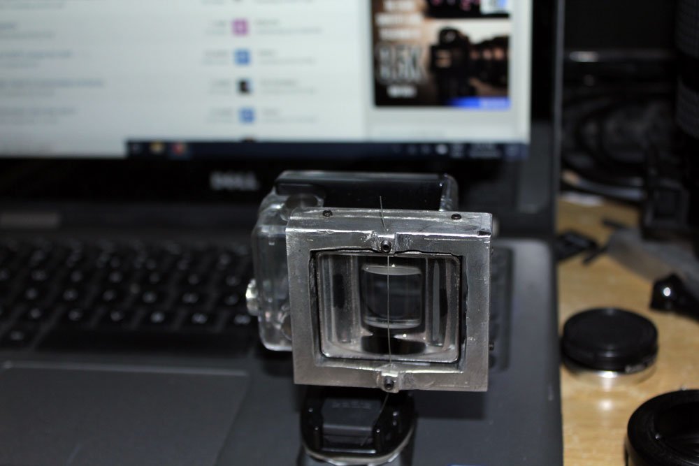

leslie Posted October 19, 2019 Author Share Posted October 19, 2019 More digressing, i know @Tito Ferradans has been doing something with faking the anamorphic look. Maybe he's posted something by now not sure. In the interests of sharing the anamorphic burden i had made a frame and had a machinist add some grubs screws to mount it onto my letus anamorphic. I have been wondering if perhaps i could add or change the flares somehow. Lots of testing in front of me just need to find a fishing buddy that has lots of different fishing lines. i will probably have to paint the frame black but the first test will to see how the frame reacts unpainted Link to comment Share on other sites More sharing options...
