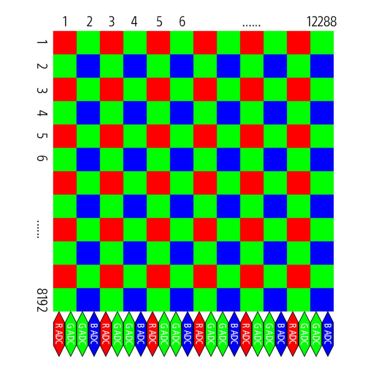

androidlad Posted March 20, 2019 Author Share Posted March 20, 2019 This 12288 x 8192 100MP sensor employs a unique, CFA-based column-parallel ADC design: Link to comment Share on other sites More sharing options...
Nikkor Posted March 21, 2019 Share Posted March 21, 2019 Pointless 100mp on a small sensor. I wish they would rather work on full well capacity or something else that gives more dynamic range. Link to comment Share on other sites More sharing options...
androidlad Posted March 21, 2019 Author Share Posted March 21, 2019 29 minutes ago, Nikkor said: Pointless 100mp on a small sensor. I wish they would rather work on full well capacity or something else that gives more dynamic range. Sony has some of the most talented sensor architects, how much do you know? ? The diagram above is exactly one of many innovative designs to improve sensitivity and dynamic range. Link to comment Share on other sites More sharing options...

androidlad Posted March 22, 2019 Author Share Posted March 22, 2019 9 minutes ago, liork said: It should be interesting to see how making a 8MP out of 100MP turns out in term of moire, aliasing etc. 12288/4096 = 3. 3 x 3 colour-ware binning with the above mentioned CFA-based ADC, producing 4096x2160 RGB 4:4:4 stream directly on-chip. Link to comment Share on other sites More sharing options...

androidlad Posted March 22, 2019 Author Share Posted March 22, 2019 20 minutes ago, Gianluca said: Androidlad, ok QE and and DR, but readout speed faster than a 4 time less megapixel.... Yep, IMX410 has 2-parallel ADC, this one has many many times more than that. Link to comment Share on other sites More sharing options...
androidlad Posted March 22, 2019 Author Share Posted March 22, 2019 3 hours ago, Nikkor said: With The Same Technology applied to large and to small Sensors, guess which one will have larger full well capacity and less rolling shutter. 100MP is total overkill for fullframe, when will you See diffraction? F5.6? Will they build in a focus stacking program for landscapes? Moving the ibis back and forth, using phase detection pixels to make a depthmap? I know they are not. What's the obsession with per-pixel FWC? Don't forget the pixels sit on a 36x24mm sensor, smaller pixels don't collect any less light, it's just there are more of them doing the same thing. this 100MP 2.91um pixel has a FWC of 32800e-, if we do a 2x2 binning and use it as a 25MP sensor, the FWC increases to 131200e-, which is significantly higher than 24MP A7 III 95764e-. Regarding diffraction, f/5.6 is a theoretical value yes, but in reality it's not clear cut like that https://fstoppers.com/education/5ds-f11-and-confusing-circles-68177 Link to comment Share on other sites More sharing options...
