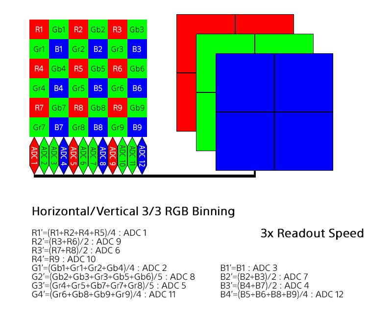

androidlad Posted March 31, 2019 Author Share Posted March 31, 2019 4K RGB 4:4:4 readout mode: Link to comment Share on other sites More sharing options...
ND64 Posted March 31, 2019 Share Posted March 31, 2019 3 hours ago, androidlad said: 4K RGB 4:4:4 readout mode: Good luck demosaicing this puzzle mess and get a clean 4k as full read out. Link to comment Share on other sites More sharing options...
androidlad Posted March 31, 2019 Author Share Posted March 31, 2019 3 minutes ago, Eric Calabros said: Good luck demosaicing this puzzle mess and get a clean 4k as full read out. Ha, this IS the demosaicing, all done on-chip at hardware level. You get super clean and sharp 4K 4:4:4 straight away. Link to comment Share on other sites More sharing options...

androidlad Posted March 31, 2019 Author Share Posted March 31, 2019 14 minutes ago, Andrew Reid said: Similar architecture to the Sony-Fuji 100MP medium format sensor? Personally I don't need 100MP stills but the technology is interesting as is all forward progress, it leads to an interesting future and is better than staying the same, otherwise we'd all be shooting 720p and 8MP stills Almost completely different architecture with this one being more advanced. 3.76um vs 2.91um, slim DTI, way more ADCs and they are now colour-aware (meaning significant readout noise reduction and QE boost). There are various 2x2, 3x3, 6x6 binning modes optimised for speed, quality or a compromise between the two. One of the 2x2 binning modes produces a 25MP image that even surpasses A7 III. Link to comment Share on other sites More sharing options...
sanveer Posted March 31, 2019 Share Posted March 31, 2019 7 hours ago, androidlad said: 4K RGB 4:4:4 readout mode: Whoa that's a monster of a CFA and binning setup combination. Link to comment Share on other sites More sharing options...
Towd Posted March 31, 2019 Share Posted March 31, 2019 9 hours ago, androidlad said: 4K RGB 4:4:4 readout mode: 2 hours ago, androidlad said: There are various 2x2, 3x3, 6x6 binning modes optimised for speed, quality or a compromise between the two. Very cool! Interesting to see how they are sampling the bayer pattern for the 4:4:4 color. Some pretty extensive binning going on. With this level of sampling, the speed optimized binning may still produce a really nice image with just a tad more noise. It'll be interesting to see the final results. Link to comment Share on other sites More sharing options...

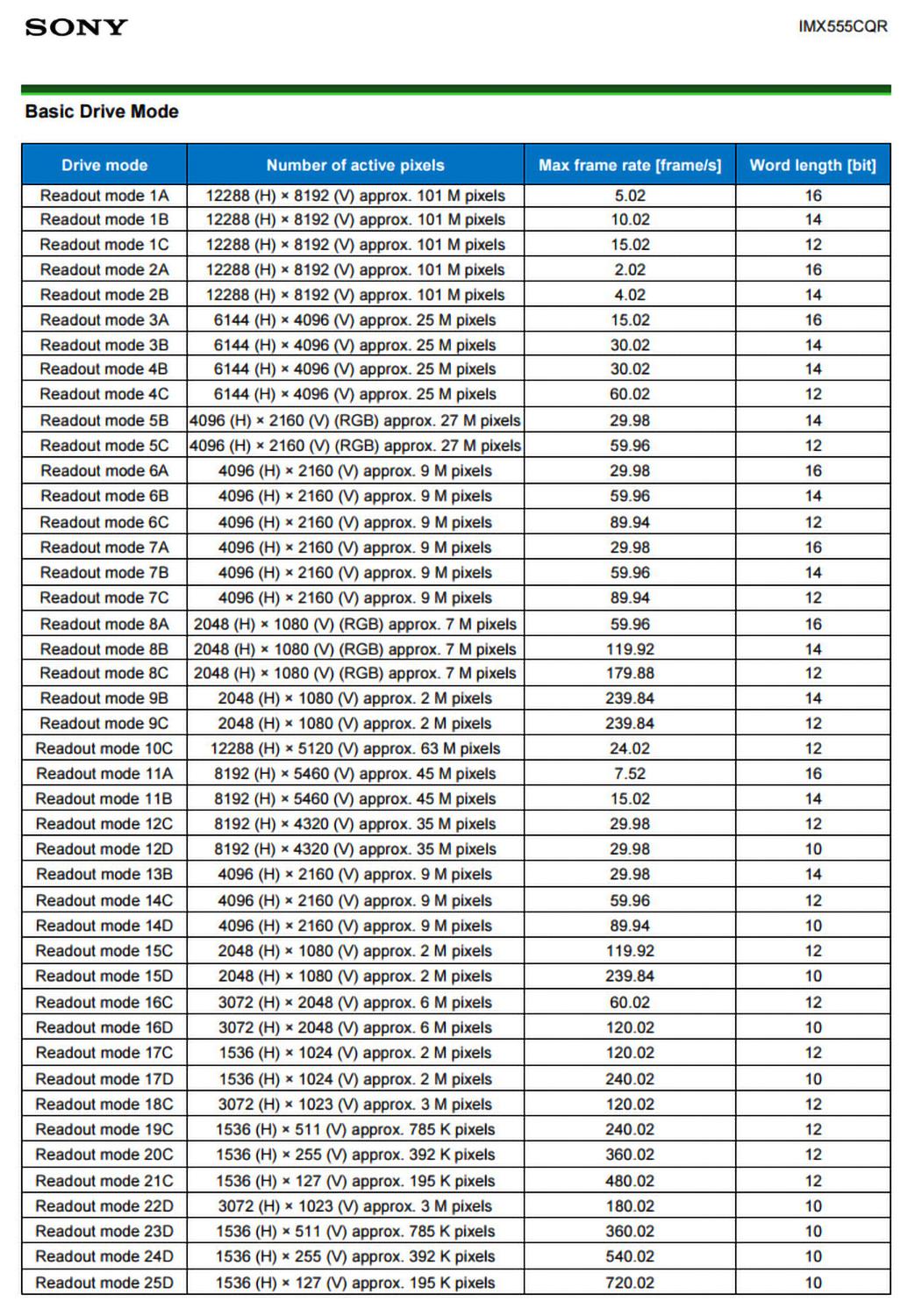

androidlad Posted April 14, 2019 Author Share Posted April 14, 2019 All readout drive modes detailed here: Link to comment Share on other sites More sharing options...
androidlad Posted April 15, 2019 Author Share Posted April 15, 2019 On 4/14/2019 at 11:43 AM, androidlad said: All readout drive modes detailed here: Let's all marvel at this particular piece of cutting edge engineering. It's the one sensor to rule them all. There's 8K 30P, 6K 60P, 4K 90P, 3K 120P, 2K 240P. Ultra high sensitivity RGB binning mode is available for 4K up to 60P and 2K up to 180P. 16bit ADC readout is available for video framerates for the first time. Link to comment Share on other sites More sharing options...
Towd Posted April 15, 2019 Share Posted April 15, 2019 1 hour ago, androidlad said: Let's all marvel at this particular piece of cutting edge engineering. It's the one sensor to rule them all. There's 8K 30P, 6K 60P, 4K 90P, 3K 120P, 2K 240P. 4K 90P I dunno. This isn't what I was hoping for in a next generation sensor. Even with triple the read out speed, I think I'm more interested in a lower megapixel version. For me it's less about the frame rates, and more to do with managing rolling shutter though, so maybe Sony will surprise there. In the end though this will be great for stills while also recording good video, so I'm sure it'll make a lot of people happy. If you find the specs for the lower resolution version, I'd be interested in seeing that. Link to comment Share on other sites More sharing options...
