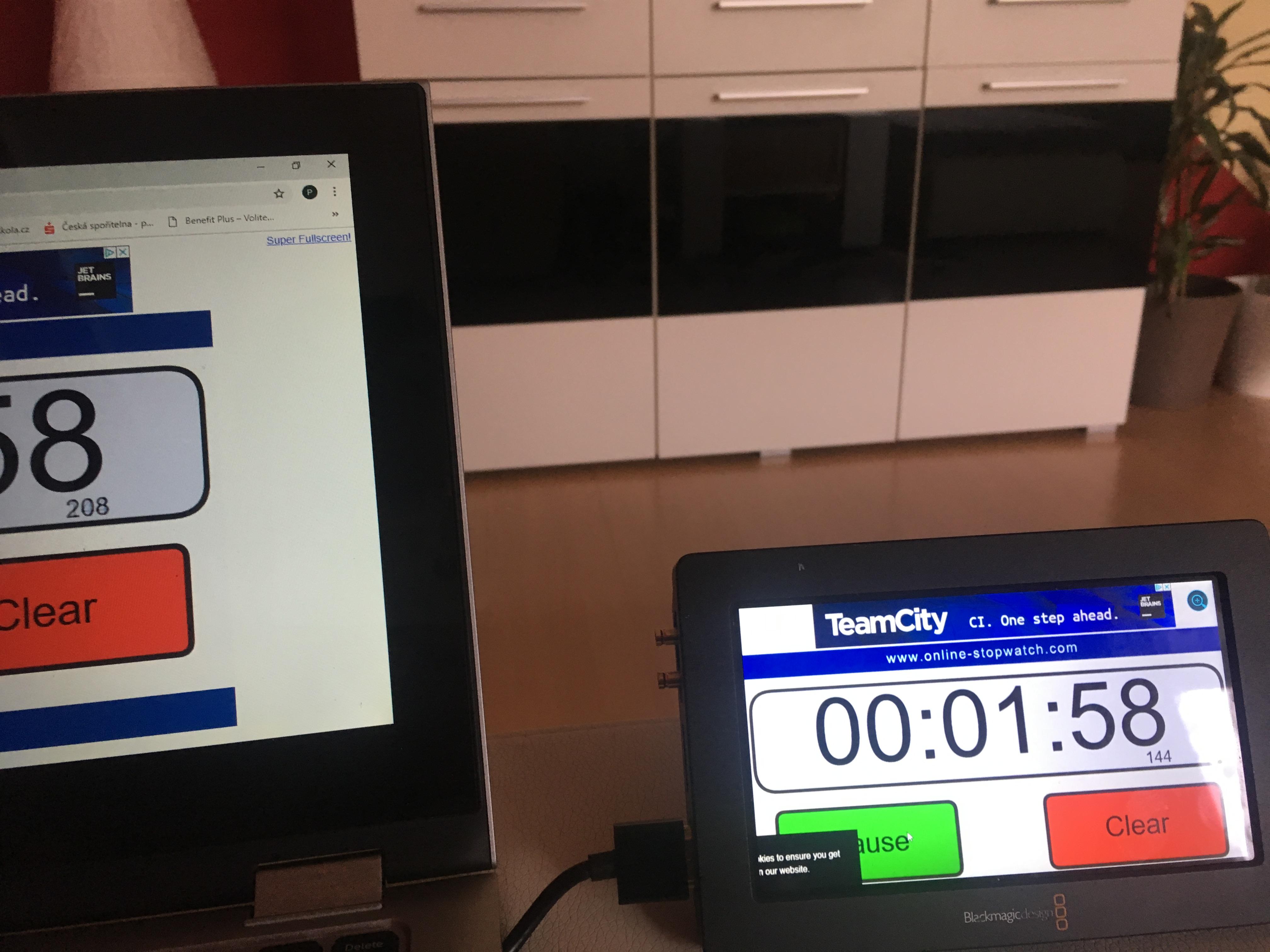

tonysss Posted March 26, 2019 Share Posted March 26, 2019 all atomos recorders have latency from 50-200ms depending on what kind of function is enabled (LUT, wave, etc.) It is easy to measure, turn on the laptop screen stopwatch with miliseconds and HDMI output connect to the Ninja , and take photo your mobile phone both screens simultaneously. my old Ninja 2 has 180ms my blackmagic videoassist has no latency with LUT disable. (immeasurable) Video assist 5" with LUT enable has 60-70ms latency Notebook hdmi out has minimal latency (1-2ms) for gh5 it was no matter what I turned on, it was always 140-170ms! BMMCC has 80ms Sony Z150 - SDI out has 50ms using a higher frame rate (50p) is output latency mostly by half. (I use on live big screen show 50p only) webrunner5 1 Link to comment Share on other sites More sharing options...
