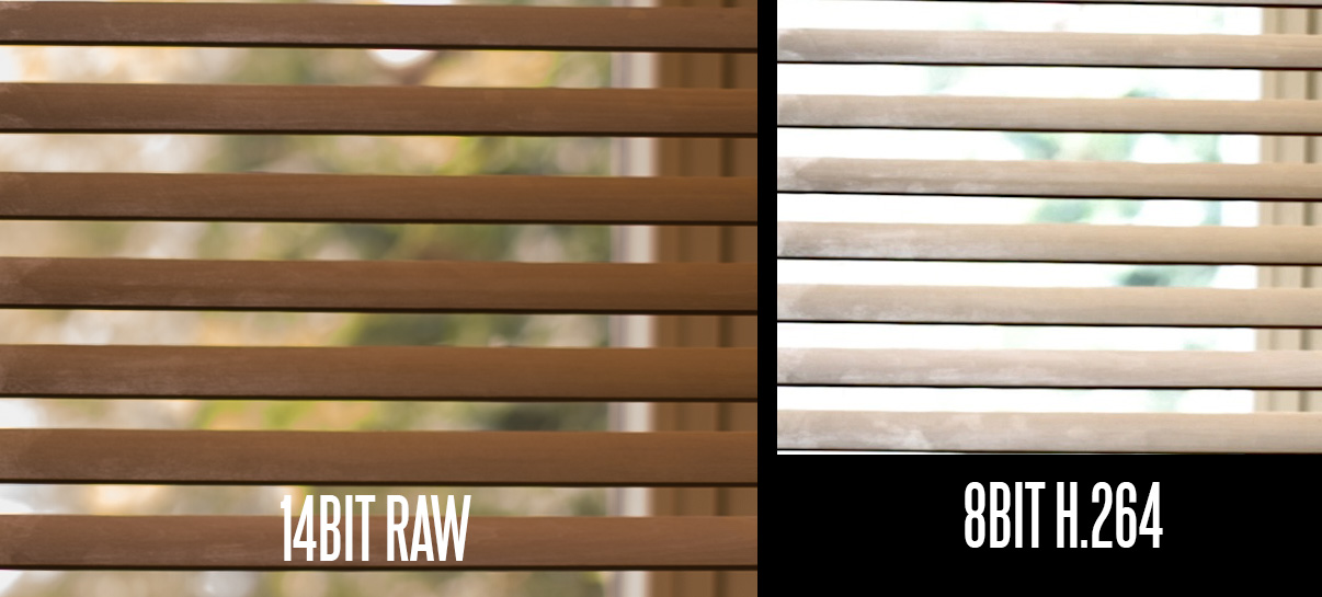

Administrators Andrew - EOSHD Posted July 26, 2013 Author Administrators Share Posted July 26, 2013 I will do a grading post on EOSHD soon which will show the difference between 14bit raw and 8bit codecs very clearly. Best thing to do is to stop talking about it and SHOW it. Link to comment Share on other sites More sharing options...
Administrators Andrew - EOSHD Posted July 26, 2013 Author Administrators Share Posted July 26, 2013 Quick test. Massively blown window by 3ev. Brought down 2.5 stops in post. If you enjoy having your highlights look like the mush on the right, keep shooting 8bit / C100 / standard DSLR video! Link to comment Share on other sites More sharing options...
peederj Posted July 26, 2013 Share Posted July 26, 2013 Can't be the same exposure since the non-blown portions of the image aren't the same value. Link to comment Share on other sites More sharing options...
Administrators Andrew - EOSHD Posted July 26, 2013 Author Administrators Share Posted July 26, 2013 Can't be the same exposure since the non-blown portions of the image aren't the same value. LOL. It's the same exposure. What non-blown portions? The whole window including blinds were over exposed by 2 stops. If you like I can upload the original H.264 with metadata for exposure, original raw DNG and even an original CR2. Link to comment Share on other sites More sharing options...
peederj Posted July 26, 2013 Share Posted July 26, 2013 To roughly test DR use a gray card in the frame and expose and post process for a defined value of that on your waveform/histogram. Then you will have a consistent baseline from which to measure latitude. You also need to note the gamma being used and normalize for that too. The original capture files and metadata would be useful of course. But this particular test isn't controlled and reproducible because sunlight is highly variable and may have changed drastically from one exposure to another merely by the presence of clouds. What we need is a proper, scientifically controlled, reproducibly documented, fully independent test site for video as we have for stills (DPreview/DxO, which doesn't entirely meet my listed standards but gets closer than anything else). Then we can happily argue till we're blue in the face about subjective qualities...the objective ones will be established beyond argument. Link to comment Share on other sites More sharing options...
Administrators Andrew - EOSHD Posted July 26, 2013 Author Administrators Share Posted July 26, 2013 Dude it was same shot on same camera with same lens and same exposure settings, same light same moment to within 5 seconds. You're an idiot. Link to comment Share on other sites More sharing options...
