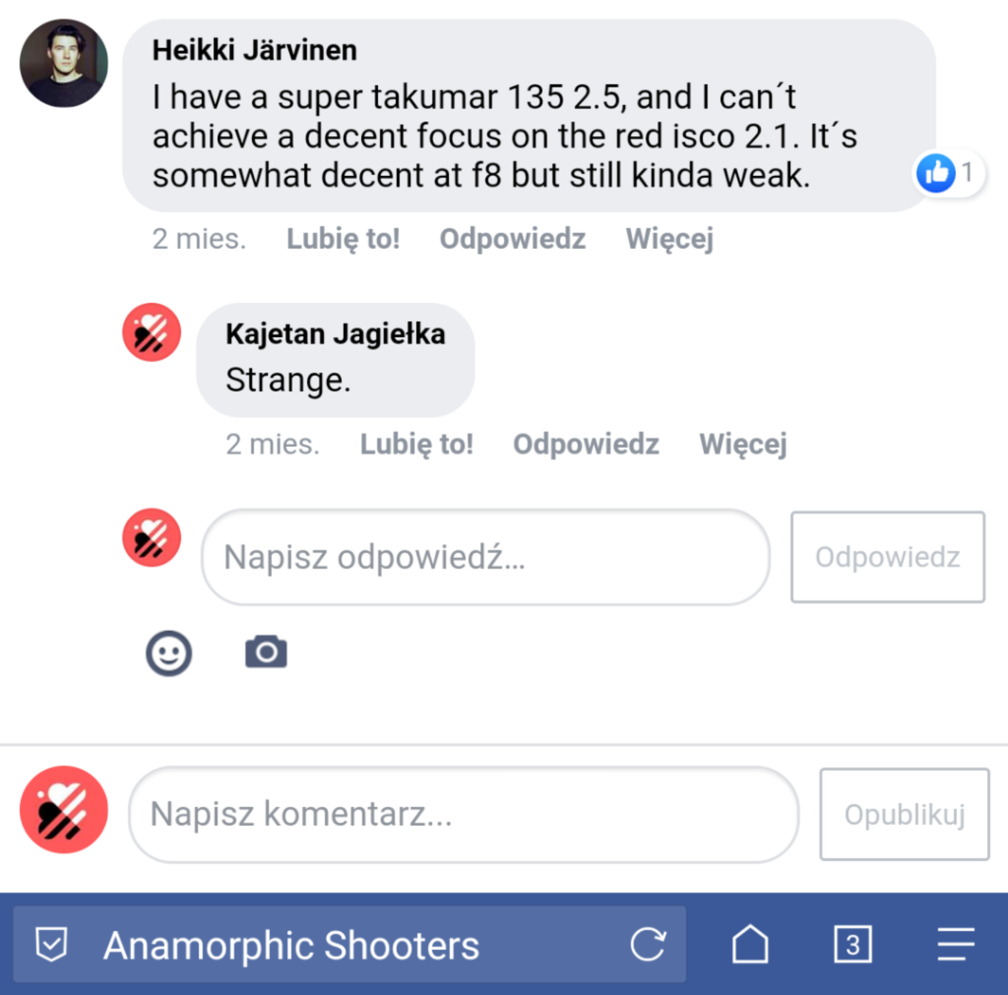

Andrew Clunie Posted May 4, 2019 Share Posted May 4, 2019 Hi all.. wondering if anyone has experience with this takumar paired with an Anamorphic lens? I’d be using it with a pre-36... wondering about the general experience.. sharpness.. colour, flaring etc. Link to comment Share on other sites More sharing options...
heart0less Posted May 4, 2019 Share Posted May 4, 2019 The only comment I've found: Andrew Clunie 1 Link to comment Share on other sites More sharing options...
Andrew Clunie Posted May 4, 2019 Author Share Posted May 4, 2019 Mmm that’s weird.. maybe user fault, or a bad set-up/faulty lens? Appreciate the response ! Link to comment Share on other sites More sharing options...
heart0less Posted May 5, 2019 Share Posted May 5, 2019 7 hours ago, Andrew Clunie said: Mmm that’s weird.. maybe user fault, or a bad set-up/faulty lens? Yeah, seems like it, to be honest. I have a Pentacon 135/2.8 and even wide open it is okay. Andrew Clunie 1 Link to comment Share on other sites More sharing options...
