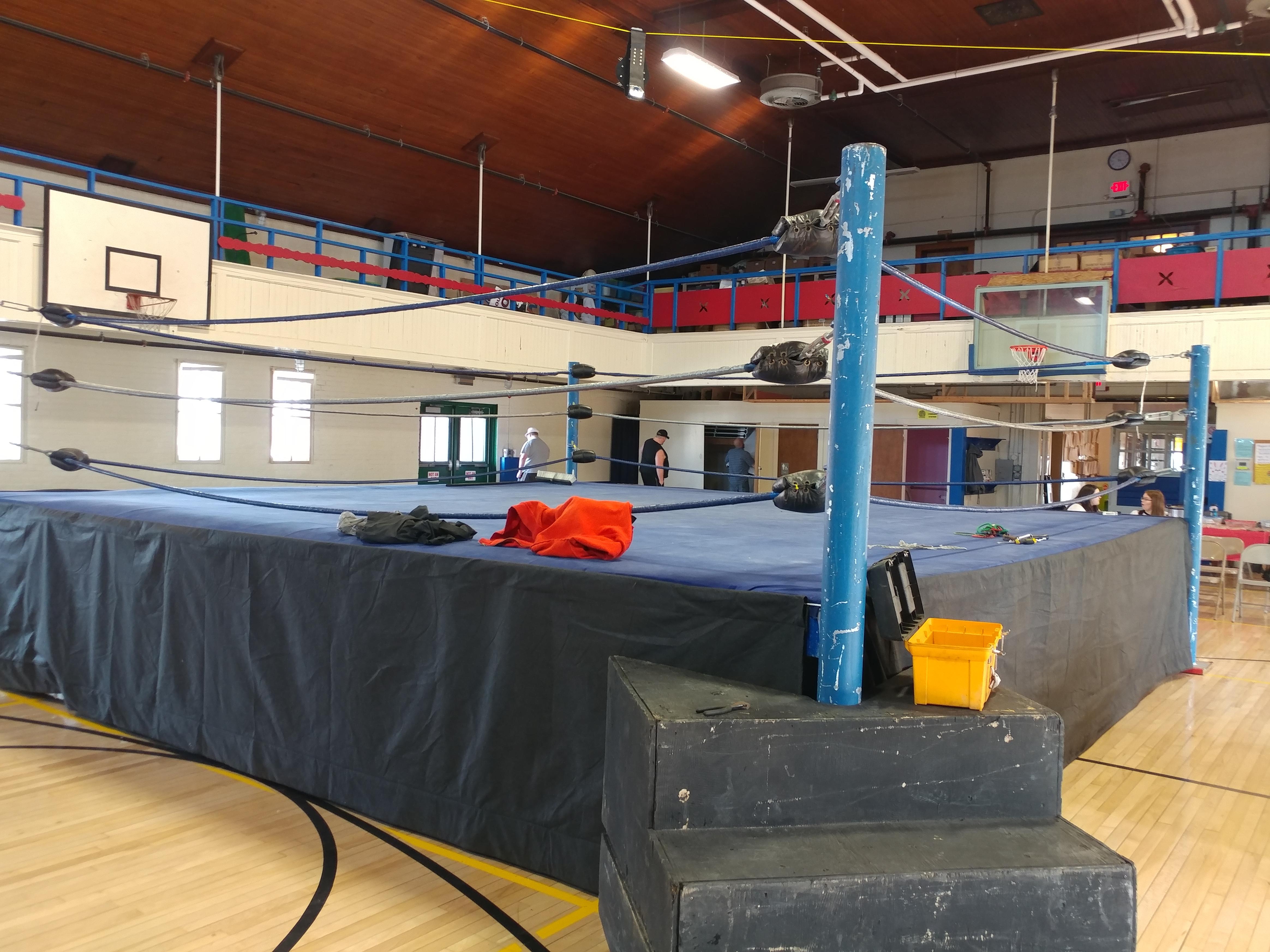

newfoundmass Posted May 13, 2019 Author Share Posted May 13, 2019 I'm looking for something that picks up pretty much all the noise, from the action in the wrestling ring / to the crowd. I want the viewer to feel like they're there in the building. While the camera mics aren't terrible for this, I would like something better. Link to comment Share on other sites More sharing options...

newfoundmass Posted May 13, 2019 Author Share Posted May 13, 2019 In a prefect world I'd have the crowd, the ring and under the ring mic'd up, but that's just not feasible for a variety of reasons. I'm not looking for the best, given the circumstances and the budget, but hopefully something that gives fuller and richer sound than the camera mics. What I have now is the announcers going into a recorder and, sometimes, a Zoom H1 recorder I'll put under the ring to make the "bumps" sound more impressive. Ideally the stereo mics on the hard camera and my ringside camera would get better sound than I currently am getting. In terms of sound I'm already ahead of most of the people in my niche field, but I'd love to improve it more. 5 minutes ago, webrunner5 said: Hell your mike is more important than the camera. I don't see why people get their panties up about DR. Silly shit on here. I don't give a shit about your story if I can't hear it. I'm definitely not concerned with DR, especially in the venues we run! webrunner5 1 Link to comment Share on other sites More sharing options...

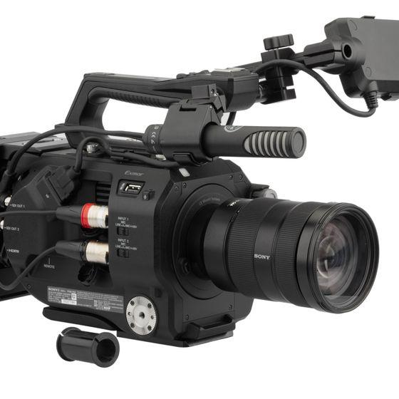

Mako Sports Posted May 13, 2019 Share Posted May 13, 2019 If your camera has dual XLR inputs you could try the Senal MC5-MS or Sony ECM MS 2 newfoundmass 1 Link to comment Share on other sites More sharing options...

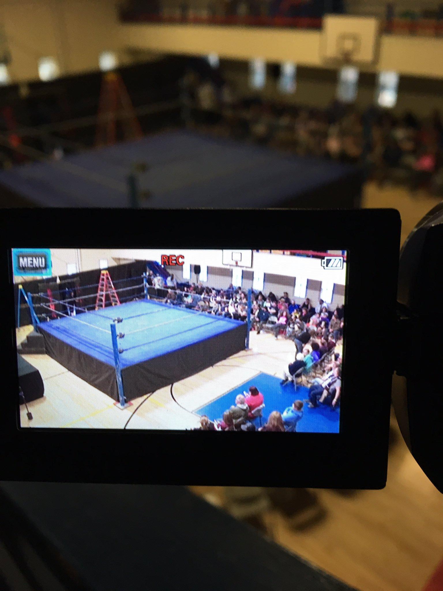

newfoundmass Posted May 13, 2019 Author Share Posted May 13, 2019 I should've noted I use a GH5 and G85. I also set up a Sony handy cam (pictured above) just as a back up. Link to comment Share on other sites More sharing options...
