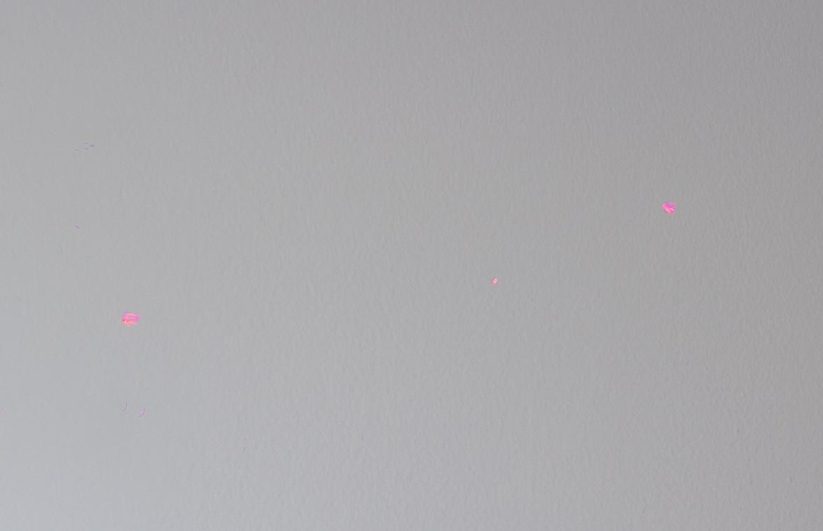

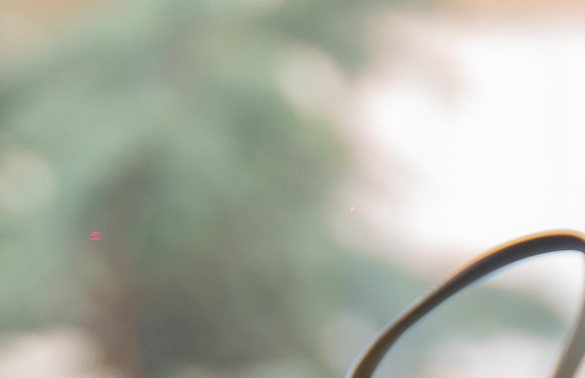

heart0less Posted May 31, 2019 Share Posted May 31, 2019 Hi! I decided to try out the (in)famous NX1 and managed to buy one in a kit with 16-50 f/2-2.8 S for a 1000€ on eBay. I got it today and immediately took some test photos. Unfortunately, I noticed some strange blobs near the upper border of the image. 100% crops: Are these stuck pixels? They are on every photo I took, always in the same place. However, when I took a body cap photo, I couldn't spot them no more. The photo is pitch black. Both camera sensor and lens are clean, they have no dust, scratches, etc. I didn't drag the shutter. The blobs appear even at 1/250th I performed a couple of Sensor Cleaning in-camera, didn't notice any difference. Followed this thread: https://***URL removed***/forums/thread/3911003 - no help, at all. Any ideas? I can always return it, the seller is a great, nice guy. Thanks. Link to comment Share on other sites More sharing options...

KnightsFan Posted May 31, 2019 Share Posted May 31, 2019 I'd return it. The first NX1 I bought had stuck pixels that looked like that right in the center of the screen and they messed up the focus peaking. But they weren't always there either. I tested the camera maybe 5 times and only saw the stuck pixels 4 of them. There's probably some remapping algorithm to compensate for bad pixels (all cameras have them) which sometimes works and sometimes doesn't. It might also be ISO dependent whether they are visible or not, I vaguely remember the bad pixels being worse at high ISO. I returned that NX1 and got a different one, which also has a bad pixel like the middle one in your 100% crops. I suppose it could be a lens problem, but it doesn't look like it, and you can easily check by trying a different lens. Link to comment Share on other sites More sharing options...

Mokara Posted June 4, 2019 Share Posted June 4, 2019 Quote May be damage to the sensor filter as well. Link to comment Share on other sites More sharing options...
heart0less Posted June 5, 2019 Author Share Posted June 5, 2019 I checked it with some manual lenses and the blobs are still there. Bill from dpreview.com (https://***URL removed***/forums/thread/4397924) conducted some tests and concluded that it's most likely laser damage. Nonetheless, I managed to come to an agreement with the seller and got a quite substantial discount - 350 €. That's 650 € for a body and 16-50 S. I decided to keep the camera and it already proved useful - I shot a live studio session yesterday and will share some stills as soon as my issues with Resolve are solved. ( : Link to comment Share on other sites More sharing options...
