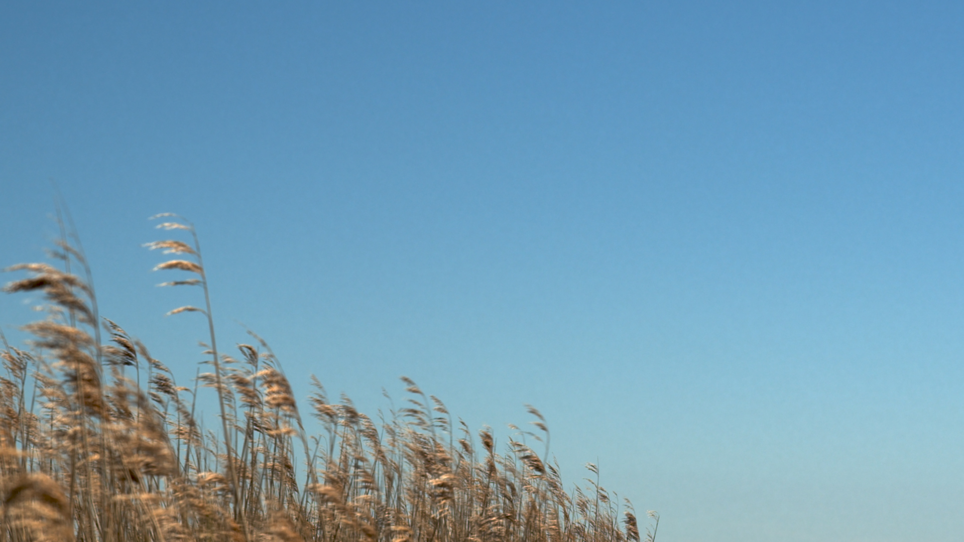

The ghost of squig Posted July 1, 2019 Author Share Posted July 1, 2019 8 hours ago, thebrothersthre3 said: I'd love to see some comparison footage. Wasn't expecting the Pocket to be significantly better than the Fuji. Its a very tempting option right now along with a hacked 5D mark 3. How does prores compare to the HEVC on the Pocket? https://drive.google.com/open?id=1bTrb4QlNxZRQW2dZPMQ5_7U5b0jMxrQ5 I haven't shot any ProRes, been quite content recording Braw to a T5 drive and UHS-1 Sandisk extreme pro cards. The P4K pairs better with the 5D than the X-T3, much easier to match in post. Keeping in mind I've been working on doco with no control of the lighting, the X-T3 would do a lot better with controlled lighting. 8 hours ago, Geoff_L said: I am exactly thinking the same... For still + video, could be a good combo. Lenses and batteries can be shared, even if it appears to be better going external on the BM. Given the prices of the used 5D, it roughly makes the pack at the same level of the others hybrids (if keeping the BM accessories to a minimal). I wonder something, maybe @The ghost of squig has an answer : I see everybody rigging the bmpcc4k (with quite big rigs for some), which is, given its purpose as a cinema camera, a logical thing. But, what if you try to use it with the minimal accessories, e.g only a smallrig cage (+ a t5 ssd, or only a fast sd card) and a little mic ? I believe the battery life is only 20min, but if you have 4 or 5 canon batteries with you and a powerbank to charge them in an emergency, could it work to avoid the big external powering solutions ? I know it depends on the shooting style and the type of work, but, still, I wonder ? I wouldn't bother with LP-E6 batteries, the run-time is too short. I haven't bought a cage, I have it rigged to 15mm rails with the Sony L battery hanging off the back of the rails and the T5 mounted to the rails under the lens. If you're booming you can mount the L battery on the top thread. I have v-mounts and powerbanks, but I'm satisfied with the Sony L setup for now. It's probably the cheapest option, and I only have to charge 2-3 of them at the end of the day. Geoff_L 1 Link to comment Share on other sites More sharing options...

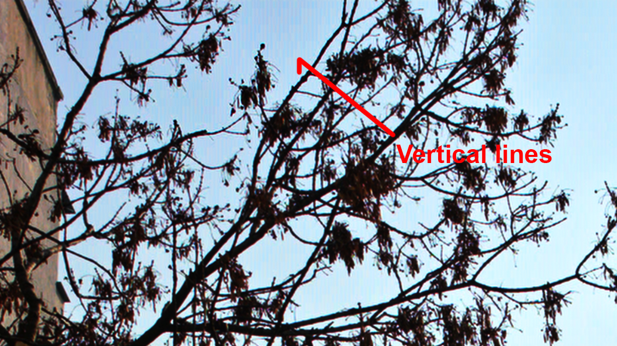

Anaconda_ Posted July 4, 2019 Share Posted July 4, 2019 @Mattias Burling The easier way to see it is film directly up at blue sky then boost the saturation way more than you ever normally would and then get upset about it. This isn't my image, but here's a shot that most are using as an example of the 'problem'. This isn't an issue with Braw specifically, people say it's also apparent in ProRes, but IMO it's still cleaner than this image, which is from 4:1 DNG... if blue skies never bothered you with DNG, they also won't with Braw. Link to comment Share on other sites More sharing options...
The ghost of squig Posted July 4, 2019 Author Share Posted July 4, 2019 2 hours ago, Mattias Burling said: Since Ive so far never seen the "pixelation blue sky issue", can someone tell me what it is I have to do to provoke it? Could be good to see it first hand and how it came about in order to avoid it. Format, type of exposure etc? I'm still trying to figure it out, so far I'm thinking underexposure could be what makes it visible, but I have to do some more tests to confirm that hypothesis. And no I didn't "boost the saturation way more than you ever normally would and then get upset about it" on my initial test. However, on a later test I did have to push the grade to an extreme level to break it. Adding filmconvert grain is a big no no, it makes it much more visible. Link to comment Share on other sites More sharing options...
thebrothersthre3 Posted July 4, 2019 Share Posted July 4, 2019 Yeah 2 hours ago, Anaconda_ said: @Mattias Burling The easier way to see it is film directly up at blue sky then boost the saturation way more than you ever normally would and then get upset about it. This isn't my image, but here's a shot that most are using as an example of the 'problem'. This isn't an issue with Braw specifically, people say it's also apparent in ProRes, but IMO it's still cleaner than this image, which is from 4:1 DNG... if blue skies never bothered you with DNG, they also won't with Braw. If you look at The ghost of squig's test, he compared it to the Fuji XT3 and 5D MK3. None of them had a big sat boost but only the BM Pocket 4k had this issue. At least to me it also did stand out quite a bit. I don't shoot blue skies much so I guess it doesn't matter. Still concerning to me though. Link to comment Share on other sites More sharing options...
Anaconda_ Posted July 4, 2019 Share Posted July 4, 2019 35 minutes ago, thebrothersthre3 said: Yeah If you look at The ghost of squig's test, he compared it to the Fuji XT3 and 5D MK3. None of them had a big sat boost but only the BM Pocket 4k had this issue. At least to me it also did stand out quite a bit. I don't shoot blue skies much so I guess it doesn't matter. Still concerning to me though. 1 hour ago, The ghost of squig said: And no I didn't "boost the saturation way more than you ever normally would and then get upset about it" on my initial test. However, on a later test I did have to push the grade to an extreme level to break it. Sorry, that was supposed to be tongue in cheek, but reading back, it just looks snarky, my bad. While I'm rectifying my previous post, the DNG image isn't from the P4k, it's from an Ursa 4.6k (not sure if pro or not, you can read more about it here: https://forum.blackmagicdesign.com/viewtopic.php?f=2&t=69405&p=387660) Link to comment Share on other sites More sharing options...
The ghost of squig Posted July 4, 2019 Author Share Posted July 4, 2019 3 minutes ago, Anaconda_ said: Sorry, that was supposed to be tongue in cheek, but reading back, it just looks snarky, my bad. While I'm rectifying my previous post, the DNG image isn't from the P4k, it's from an Ursa 4.6k (not sure if pro or not, you can read more about it here: https://forum.blackmagicdesign.com/viewtopic.php?f=2&t=69405&p=387660) No worries. Some of the examples on the BMD forum were super-saturated. Link to comment Share on other sites More sharing options...
