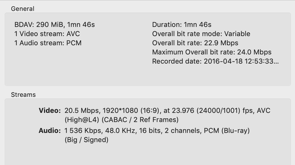

Benjamin Hilton Posted July 14, 2019 Share Posted July 14, 2019 That would explain your two in every three frames then, must have been 60fps. User 1 Link to comment Share on other sites More sharing options...
User Posted July 14, 2019 Author Share Posted July 14, 2019 2 hours ago, Benjamin Hilton said: That would explain your two in every three frames then, must have been 60fps. Hi Ben, I checked the original files and they were shot at 23.976 as can be seen in the attachment. I'm thinking @Andrew Reid could answer this in a flash. Andrew? Link to comment Share on other sites More sharing options...

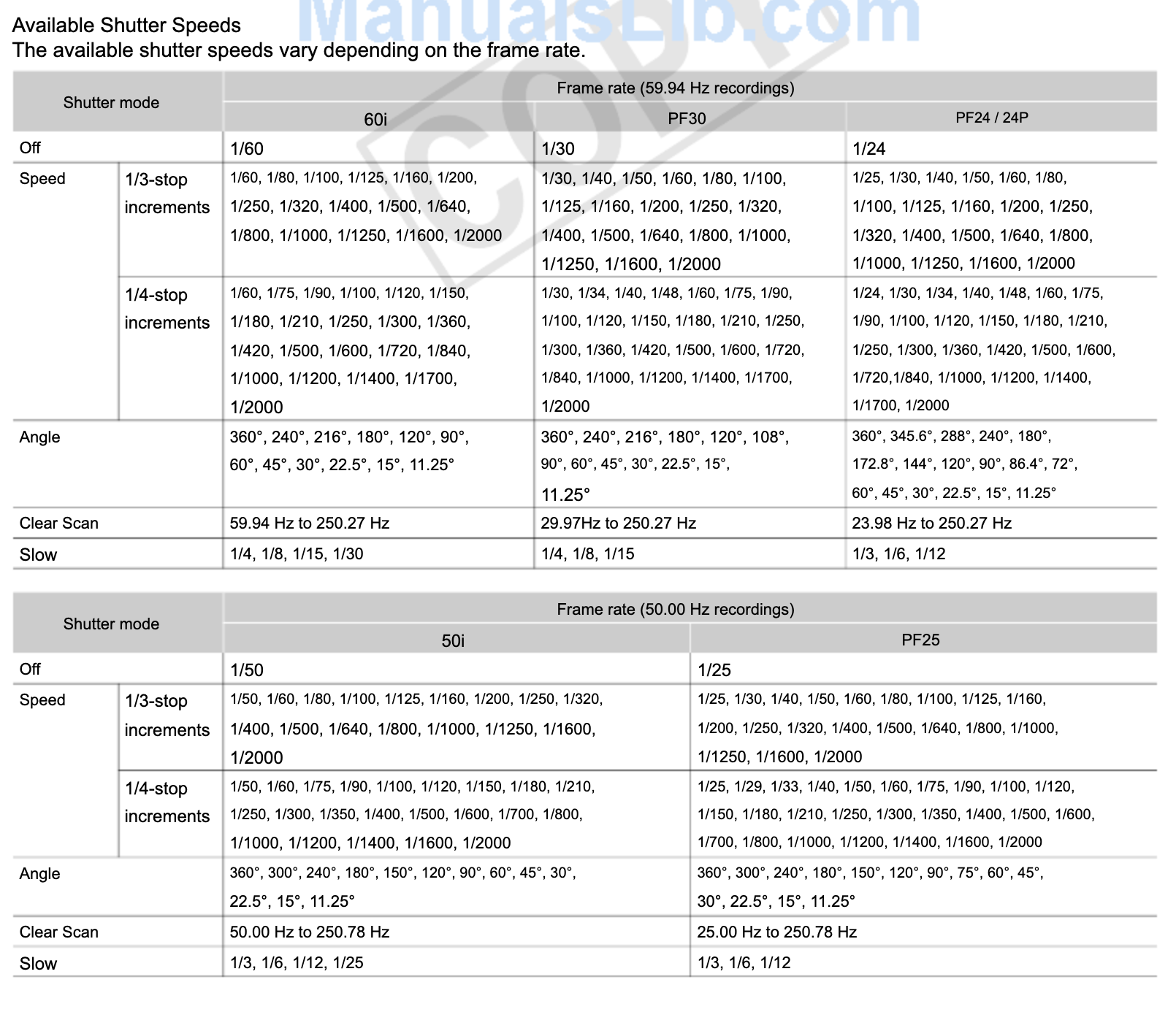

User Posted July 14, 2019 Author Share Posted July 14, 2019 23 minutes ago, KnightsFan said: You shouldn't be getting duplicated frames unless your shutter speed is actually slower than your frame rate. You should be able to shoot 1/38 shutter with 24p just fine. So that's probably not it. You didn't transcode the footage at any stage, did you? If you are 100% sure of the camera settings, 23.976 fps with 1/38 shutter, then my guess is that there is something wrong with your computer playing the files. If you can upload an original clip from the camera, we can verify. I mounted the original storage hard drive, and Media Info also indicates that the files are 23.976fps. I posted the attachment. The C100 menu did not have a shutter speed that I could select that was below 1/24. I'm almost positive I chose 1/34 because the others (1/24, 1/30, 1/40 were causing flicker. I was shooting in a PAL region but the camera was set to NTSC. I have other files from the same location that are shot at 23.976 1/48 and are just fine. Link to comment Share on other sites More sharing options...
User Posted July 14, 2019 Author Share Posted July 14, 2019 44 minutes ago, KnightsFan said: You didn't transcode the footage at any stage, did you? Edit: Is your footage interlaced? Could it be a problem with deinterlacing? 2 of every 3 frames are doubled in both the original material and the transcoded ProRes material. Material is from the C100 shot progressive. * My edit: The C100 menu did not have a shutter speed that I could select that was below 1/24. I'm almost positive I chose 1/34 because a couple(?) of the others (1/24, 1/30, 1/40) caused flicker. I was shooting in a PAL region but the camera was set to NTSC. Can anyone explain why my comment is not viable? I think it has something to do (like Ben mentioned) with fitting slower refreshed shutter images (1/34) into a 23.976 frame rate... and since the 1/34 images are refreshing slower than the 1/48 images, every second image is 'doubled' so that it can keep up with the frame rate. Link to comment Share on other sites More sharing options...
User Posted July 14, 2019 Author Share Posted July 14, 2019 Alrighty. I just did some test and my memory just ain't what it use'ta could... too many carbon monoxide w/ benzene sandwiches. You guys were right on the money in that the only shutter speeds lower that the frame rate will cause the issue. Somehow I forget this. And somehow the camera was shooting at a shutter speed of 12fps at 23.976fps for these double images. Man. Thanks again folks. Link to comment Share on other sites More sharing options...
