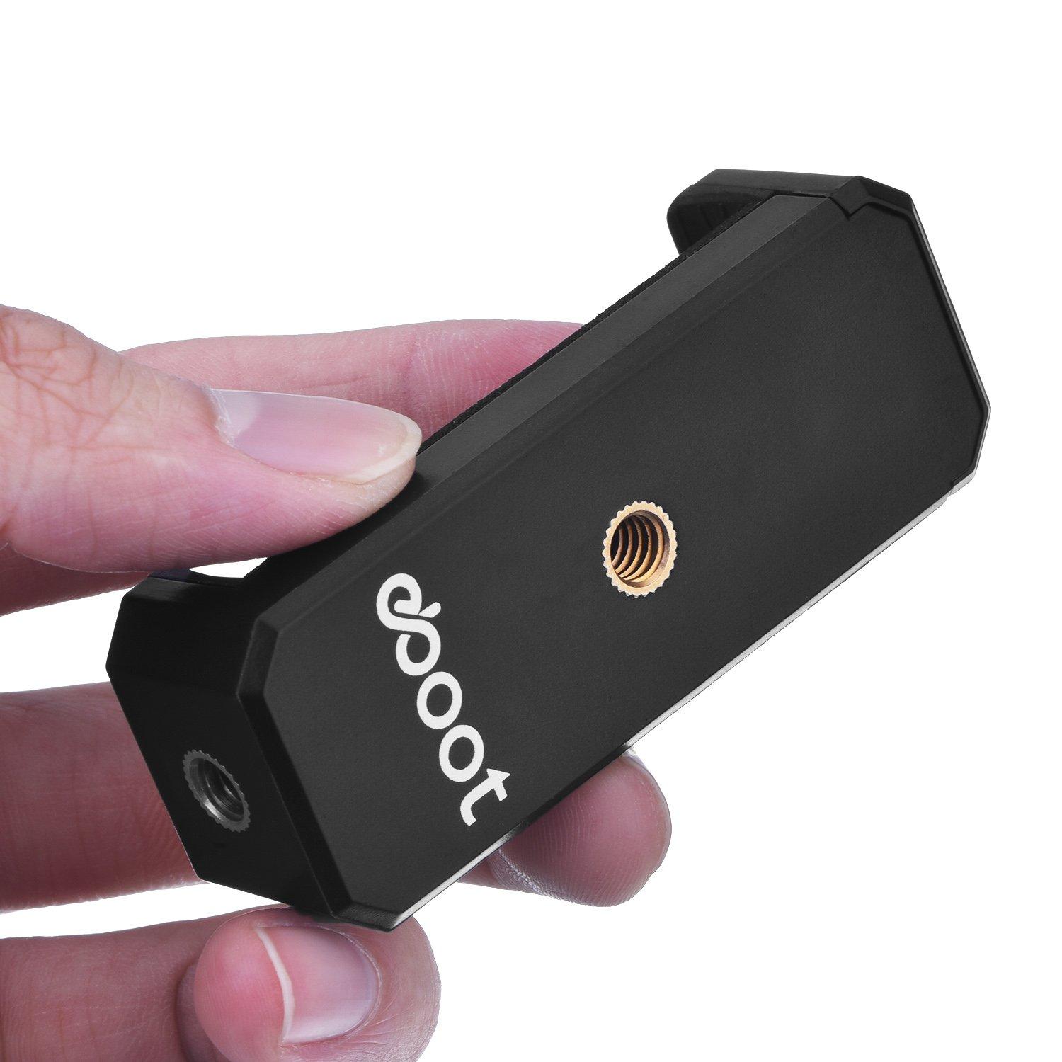

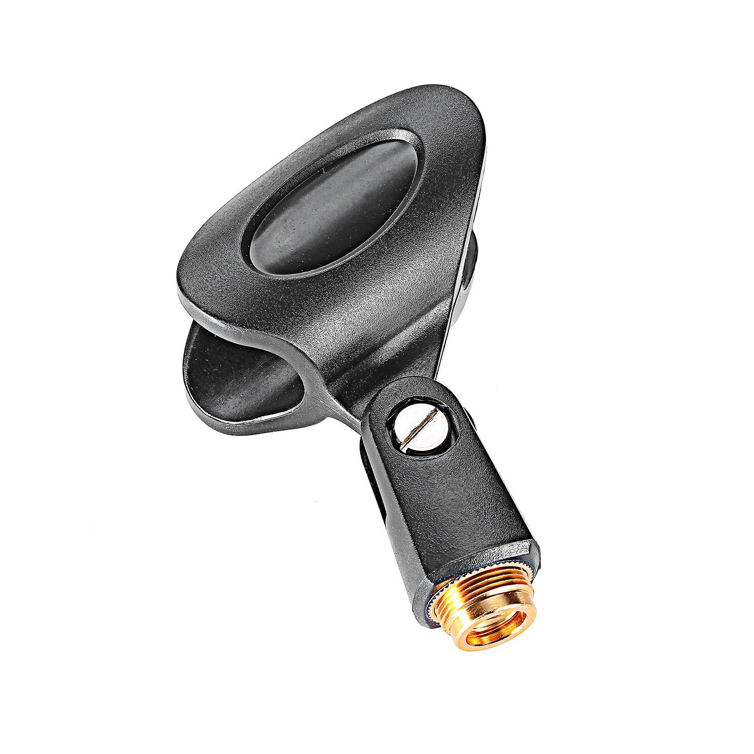

Super Members BTM_Pix Posted July 15, 2019 Super Members Share Posted July 15, 2019 2 hours ago, MrSMW said: I would like to attach one of my Rode Wireless Go transmitters to preferably a typical audio speaking mic, at a stand that they do not touch. The simplest way to attach something to a mic is to just use an additional basic mic holder further up the body of the mic. That will give you an adjustable arm to then attach to something that will hold the transmitter. Then unscrew the brass mount and put one of these thread adapters in the base of the holder. This will give you a standard 1/4" 20 screw which you can use to attach this expandable phone grip into which you can put the transmitter. Now, the snag to this is that the minimum opening size of the phone will likely be too wide to hold the transmitter. My one for example has a minimum opening of 52mm which is 8mm too wide for the transmitter. However, this is an easy and permanent fix as you can just glue (or epoxy for maximum DIY hacking cred ) additional padding material to either end of the jaws to reduce this minimum opening distance. You can use anything but some cut foam or polystyrene will be ideal. If you add 8mm of material at each end then you will have reduced the minimum opening to 36mm which will mean that the expandable jaws will then clamp the transmitter tight. Total cost is about £9 (£4 for the mic holder, £1 for the thread adapter and £4 for the phone holder). Link to comment Share on other sites More sharing options...
