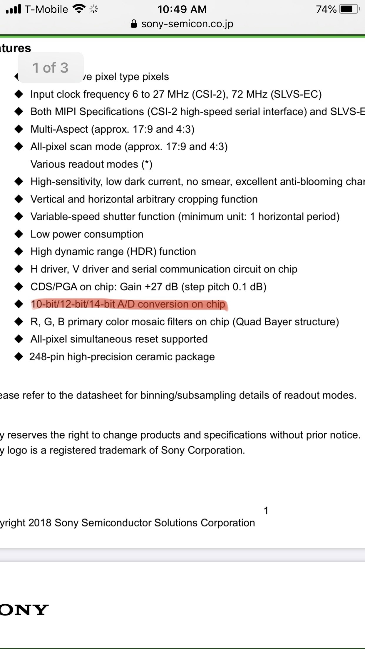

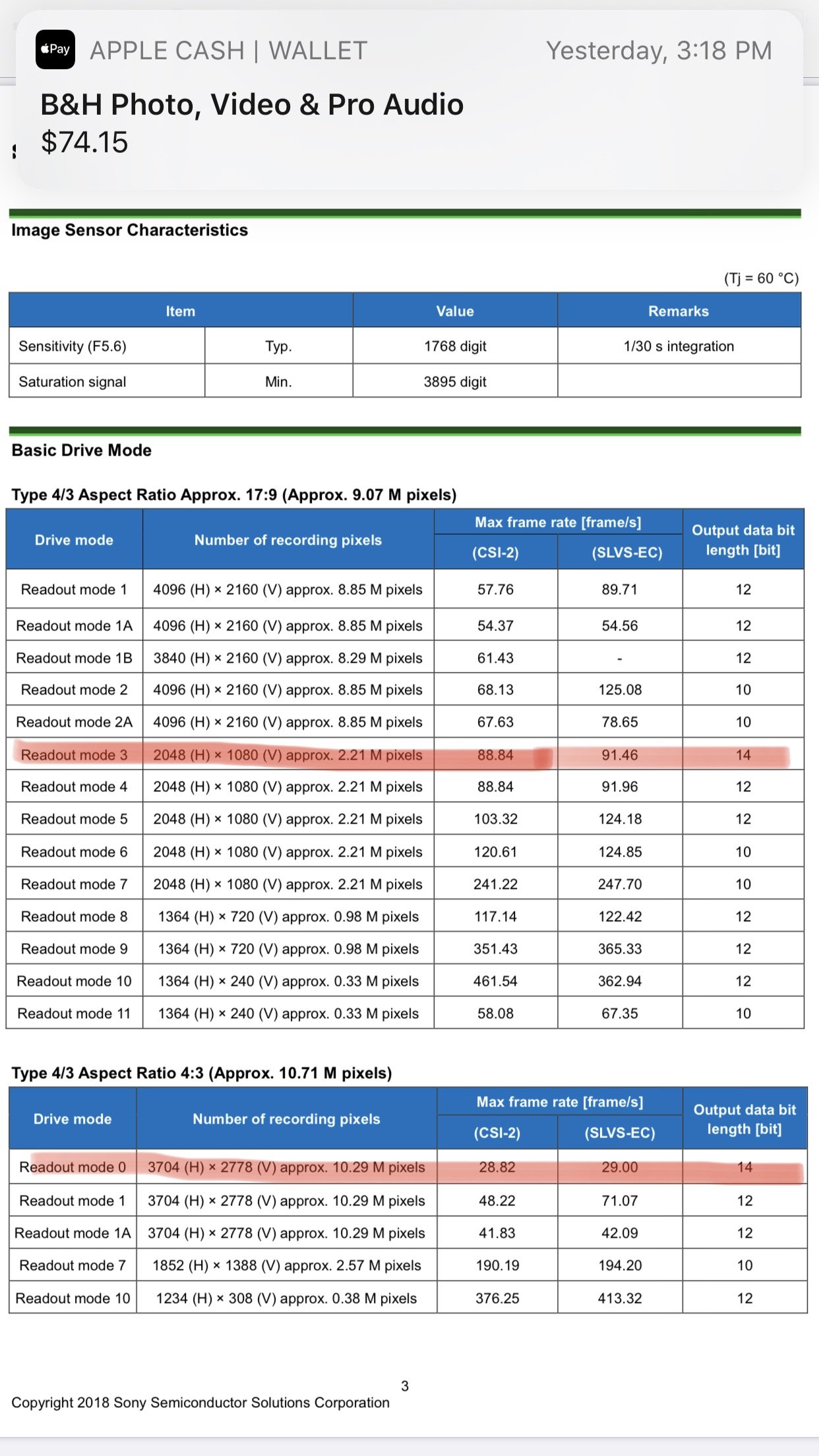

Video Hummus Posted December 24, 2019 Share Posted December 24, 2019 On 12/21/2019 at 9:58 AM, androidlad said: Other than ADC bitdepth, ISP can affect DR as well - by applying noise reduction. So, I’ve always kinda wondered in the back of my mind...based on the spec sheet for the IMX299CJK (GH5S sensor). It says it offers 10/12/14-bit ADC output and of course I take 14-bit raw photos with it. It lists 14-bit video outputs. Why does the GH5S seem to have the same dynamic range as a GH5? Purely ISP limited? I’m still hoping maybe we get ProRes RAW on the GH5S. Link to comment Share on other sites More sharing options...
androidlad Posted December 24, 2019 Share Posted December 24, 2019 7 minutes ago, Video Hummus said: So, I’ve always kinda wondered in the back of my mind...based on the spec sheet for the IMX299CJK (GH5S sensor). It says it offers 10/12/14-bit ADC output and of course I take 14-bit raw photos with it. It lists 14-bit video outputs. Why does the GH5S seem to have the same dynamic range as a GH5? Purely ISP limited? I’m still hoping maybe we get ProRes RAW on the GH5S. None of the current Sony sensors are capable of 14bit ADC readout for 4K at video framerates. Plus, higher ADC bitdepth comes with higher power consumption. GH5S has full one stop DR advantage over GH5: Link to comment Share on other sites More sharing options...
Video Hummus Posted December 24, 2019 Share Posted December 24, 2019 53 minutes ago, androidlad said: None of the current Sony sensors are capable of 14bit ADC readout for 4K at video framerates. Plus, higher ADC bitdepth comes with higher power consumption. GH5S has full one stop DR advantage over GH5: Ok, so what does the following actually (hi lighted in red) mean in the spec sheet. Thanks for the help in understanding these tech sheets. What do you look at that specifically on these PDFs to get an idea. With my limited knowledge it appears like it does offer 14-bit output in video modes at useable FPS. Also, for the eagle eyed, I didn’t realize I captured my last minute Christmas purchase from B&H. Lol. Peak design capture clip V3, yay! Link to comment Share on other sites More sharing options...
androidlad Posted December 24, 2019 Share Posted December 24, 2019 5 minutes ago, Video Hummus said: Ok, so what does the following actually (hi lighted in red) mean in the spec sheet. Thanks for the help in understanding these tech sheets. What do you look at that specifically on these PDFs to get an idea. With my limited knowledge it appears like it does offer 14-bit output in video modes at useable FPS. Also, for the eagle eyed, I didn’t realize I captured my last minute Christmas purchase from B&H. Lol. Peak design capture clip V3, yay! It means what it says, 14bit readout for 2048 x 1080. Zcam used the 10bit readout mode for 240fps. Link to comment Share on other sites More sharing options...
Video Hummus Posted December 24, 2019 Share Posted December 24, 2019 13 minutes ago, androidlad said: It means what it says, 14bit readout for 2048 x 1080. Zcam used the 10bit readout mode for 240fps. So, I can infer the GH5S is capable approaching 14 stops of dynamic range in a FHD 1:1 pixel recording mode? I guess because they chose to oversample in FHD and so are limited to the 12-bit output. Ol, makes sense. Thanks! Link to comment Share on other sites More sharing options...
