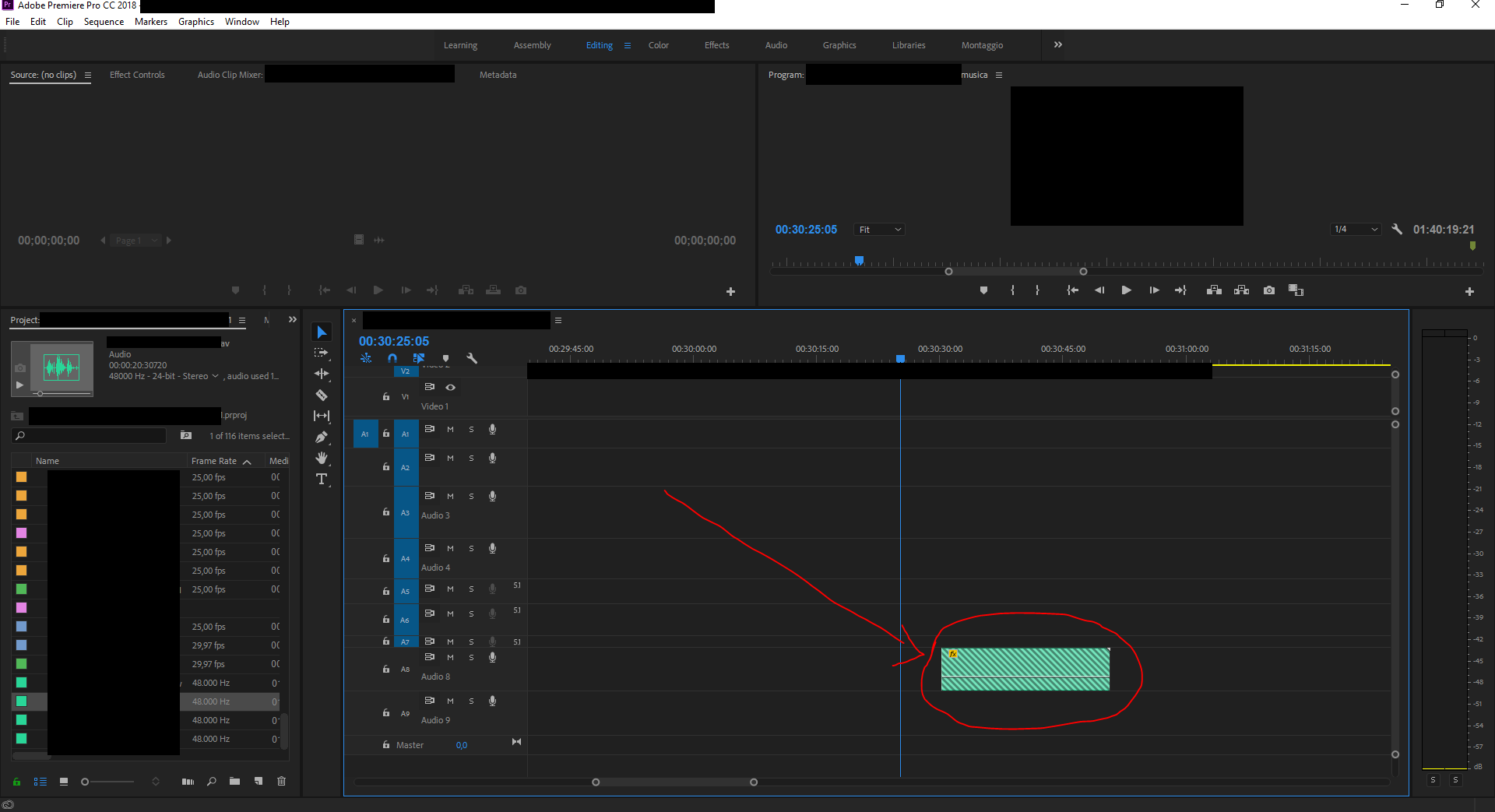

Dan Wake Posted July 23, 2019 Share Posted July 23, 2019 Hi I opened a Premiere project made by someone else. There is this audio clip, I do not know why it doesn't sound. It's completely muted, and there are weird oblique lines on the clip that I don't know the meaning. How to enable that clip to make it sound please? Link to comment Share on other sites More sharing options...
Anaconda_ Posted July 24, 2019 Share Posted July 24, 2019 I think those lines mean that the source clip isn’t as long as the clip shown in the timeline. For example, if you nest some footage, and put the nest in a sequence, then delete half the footage from the nest, the clip in your main sequence will show those lines from the last usable frame until the end of itself - does that make sense? it could be for whatever reason, Premiere can’t read the original file, so is marking it in a similar way. Strangely, it’s not the offline graphic warning, so I would investigate the original file, and try opening it in other software to fine out what it is. (Right click>Show in Finder) Link to comment Share on other sites More sharing options...
Adam Kuźniar Posted July 24, 2019 Share Posted July 24, 2019 To add to what was said above, it could be also that you had two files named the same way, and Premiere mistakenly linked the wrong one Link to comment Share on other sites More sharing options...
Dan Wake Posted July 24, 2019 Author Share Posted July 24, 2019 thx for help I solven in another way I opened the same exact xml in Adobe audition and this problem were not there.... mah Link to comment Share on other sites More sharing options...
