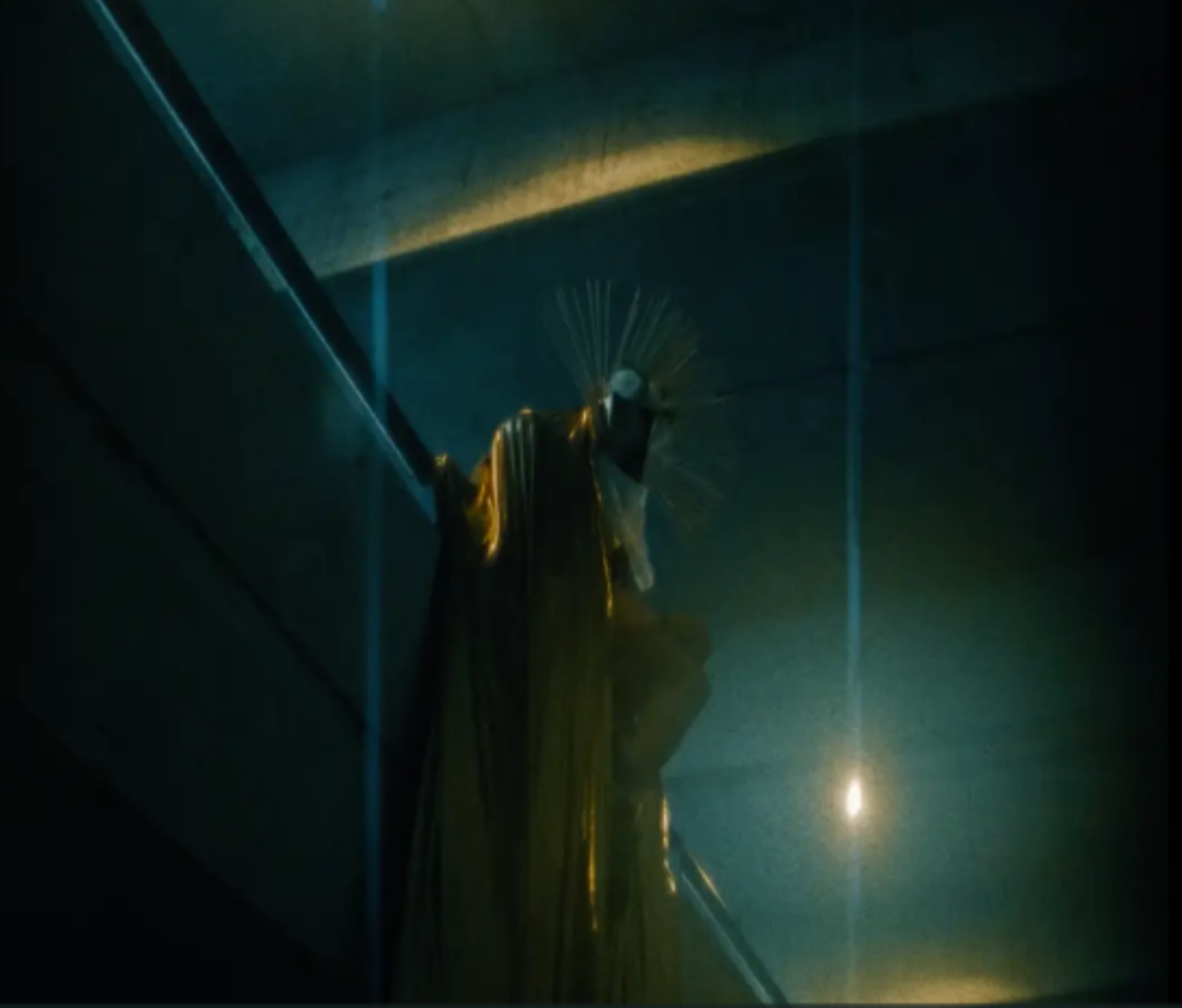

Remember that an anamorphic adapter in a sideway position will give you vertical flares like this:
Screenshot_20190729-121057_Via_Browser.thumb.png.b1b7cb96b24322b8d672c704a354bf82.png
(still extracted from: https://vimeo.com/326643814
