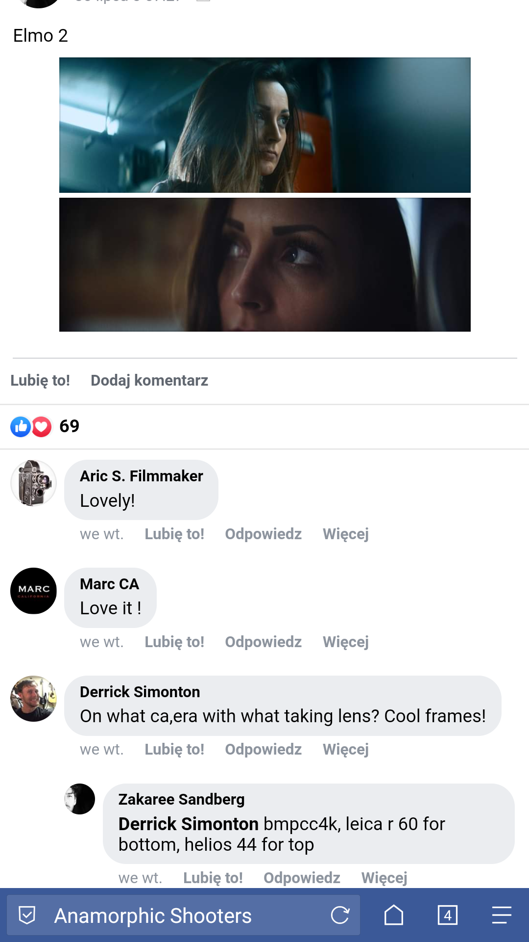

heart0less Posted August 2, 2019 Share Posted August 2, 2019 This one was shot with BMPCC4K, Helios 44 and Hypergonar S. T. O. P. https://m.facebook.com/story.php?story_fbid=381338402710980&id=196512047679611&refid=18&ref=content_filter&__tn__=*s-R Another one from BMPCC4K and Helios. This time Elmoscope II was used: Even though I'm not a big fan of Facebook groups, I have to admit that Anamorphic Shooters group (apart from everyday 'just showing how my gear looks like' posts) is a great source of knowledge and inspiration. webrunner5 and TurboRat 2 Link to comment Share on other sites More sharing options...
webrunner5 Posted August 2, 2019 Share Posted August 2, 2019 Great song , really good camera work. Link to comment Share on other sites More sharing options...
DanielVranic Posted August 5, 2019 Author Share Posted August 5, 2019 Wow!! I need that look. Was the Helios or MIR Speedboosted? Link to comment Share on other sites More sharing options...
