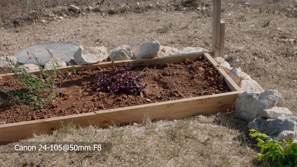

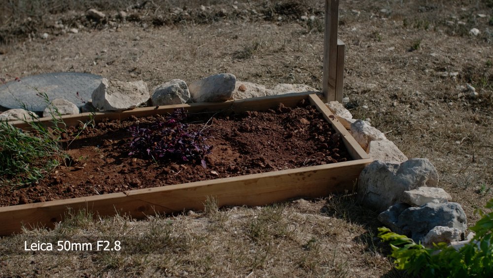

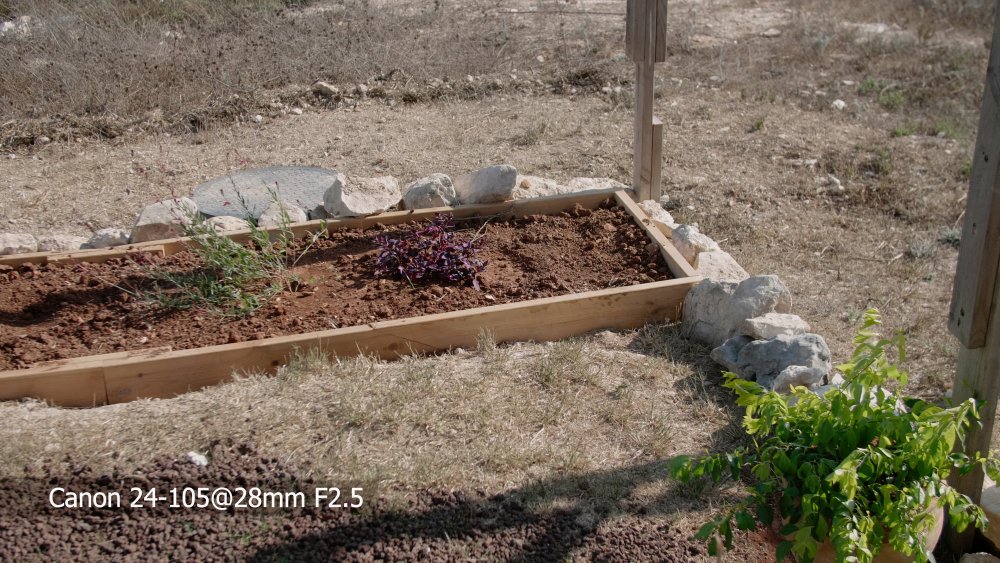

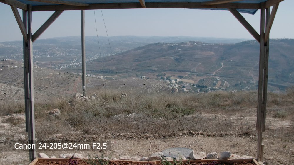

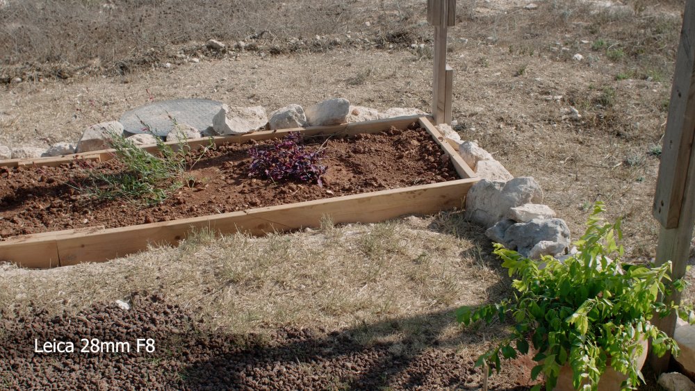

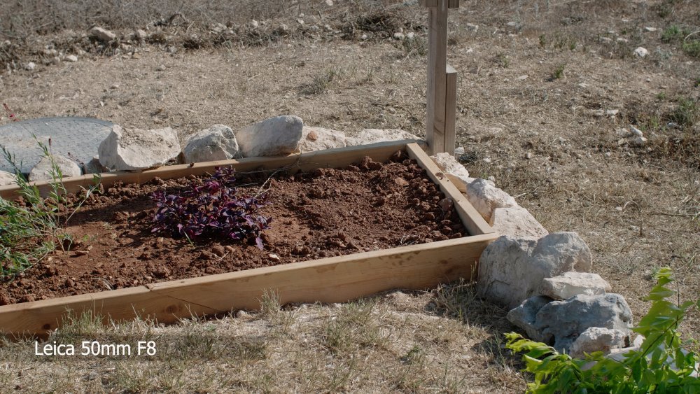

Benjamin Hilton Posted August 14, 2019 Share Posted August 14, 2019 So I've been curious recently. I've been shooting with the GH4/5 Canon L 24-105 Metabones speedbooster for a good couple of years now, and have been pretty happy with the usability, color etc. One problem though, I don't think my images are as detailed as they could be. Digital sharpness is there, kind of native to the GH processing, but the detail seems lacking. I've always put this down to the compression of my final render output, but I think there is something else going on. I assumed the 24-105 would be tack sharp, even at F4 as I've never seen anything amiss with DSLR photos and this lens combo. So, I did this quick test yesterday, comparing different focal lengths of the Canon to some Leica Primes, and also the Helios 56mm I believe it is. Nothing too scientific, just a quick cycle through apertures pointing at the same background. The focus point is the same double checked for each lens, and the exposure was just eyeballed using shutter speed to keep ND out of the equation. The Helios isn't too helpful for comparison as it couldn't focus far enough to match the other lenses, so take that one as you might. To add even more confusion, I labeled the Canon by the F number on the back of the GH5 screen (after the speed booster stop gain) and the Prime lenses are labeled by what was marked on the lens. So the F2.8 on the Leica would really be closer to a F1.9 after the speed booster, as compared to the Canon F2.5. Anyone have any experience with these lenses or thoughts on the test or sharpness in general? KnightsFan 1 Link to comment Share on other sites More sharing options...
Adam Kuźniar Posted August 14, 2019 Share Posted August 14, 2019 I think you should eliminate the speedbooster from this comparison first. Whether it impacts the sharpness (and the amount of so) or not, it's a variable that makes this comparison canon+speedbooster vs leica, not canon vs leica. Link to comment Share on other sites More sharing options...

KnightsFan Posted August 14, 2019 Share Posted August 14, 2019 3 hours ago, Emanuel said: Photography depends on variables. There are no soft nor sharp tools per se ; ) just soft or sharp combinations, respectively. That is so true. Even on paper, you have to look at combinations and not individual pieces. Leica uses a very thin filter stack on their sensor, whereas the standard MFT filter stack is very thick. So a lens designed for maximum sharpness on a Leica digital camera will not be as sharp on a MFT sensor. Canon is somewhere in the middle. (LensRentals has a lot of nice articles about it https://wordpress.lensrentals.com/blog/2014/06/sensor-stack-thickness-when-does-it-matter/) Link to comment Share on other sites More sharing options...
