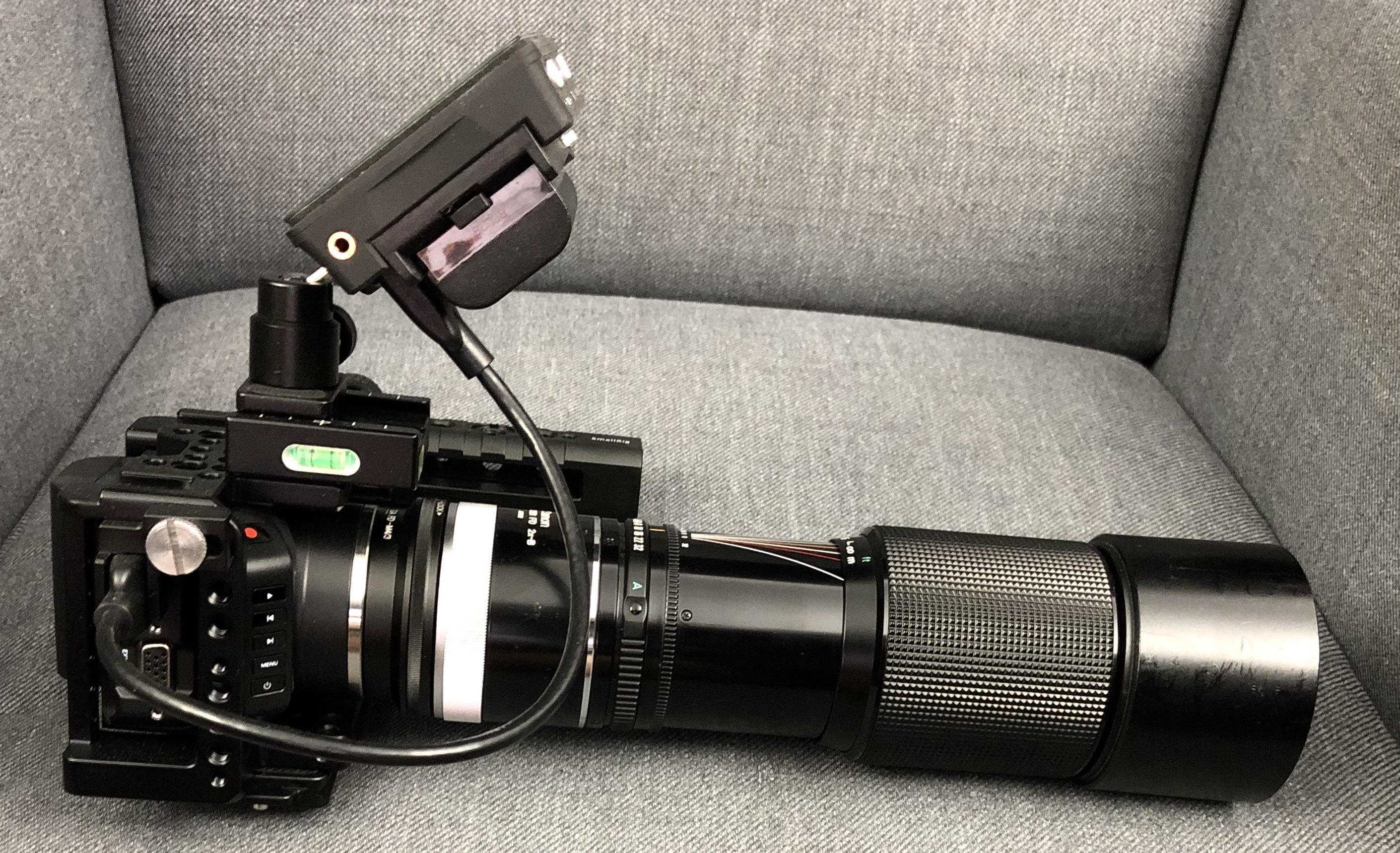

kye Posted June 15, 2020 Share Posted June 15, 2020 And here is my entry for most ridiculous Micro rig, the competition that no-one asked for and no-one will find useful. Micro, FD-MFT adapter, Canon 2x TC, Canon FD 70-210 f4. Might be one of the cheapest ways to get 1210mm 60p RAW that exists. Beyond that, not so useful! BenEricson, billdoubleu and PannySVHS 3 Link to comment Share on other sites More sharing options...
