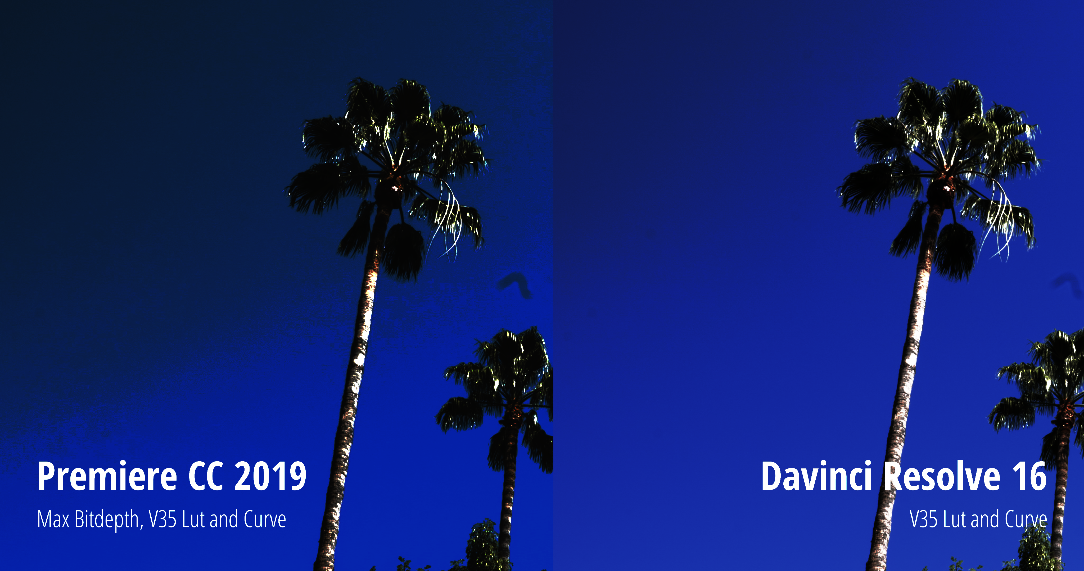

deezid Posted October 14, 2019 Share Posted October 14, 2019 Just now, thebrothersthre3 said: Would be pretty easy for any given person to prove as long as you have premiere. Just download the free copy of davinci and compare. Free version doesn't decode 10 bit H264/H265 footage. Here's a screenshot with some extreme "corrections". It looks even worse in motion. Link to comment Share on other sites More sharing options...

Jonathan Bergqvist Posted October 15, 2019 Share Posted October 15, 2019 9 hours ago, deezid said: Free version doesn't decode 10 bit H264/H265 footage. Here's a screenshot with some extreme "corrections". It looks even worse in motion. It looks like the premiere version has a much harsher correction though? The corrections should be identical, otherwise its hard to draw conclusions. Link to comment Share on other sites More sharing options...
deezid Posted October 15, 2019 Share Posted October 15, 2019 3 hours ago, Jonathan Bergqvist said: It looks like the premiere version has a much harsher correction though? The corrections should be identical, otherwise its hard to draw conclusions. It's basically the same, used the same adjustment layer. You can clearly see the artifacts around the "gradients" though which don't appear in Resolve Link to comment Share on other sites More sharing options...

Jonathan Bergqvist Posted October 15, 2019 Share Posted October 15, 2019 2 hours ago, deezid said: It's basically the same, used the same adjustment layer. You can clearly see the artifacts around the "gradients" though which don't appear in Resolve Just fooling around with the picture (that I understand is in 8bit on the web), maybe the same blockiness is in there if the more extreme contrast is applied in resolve. You can see in your example that the dust/whatever it is on the right is much more contrasty in your premiere example than resolve, so obviously the premiere example is more contrasty (which will make the image brake up more than resolve's)... I just think these kind of allogations that premiere can't handle 10 bit should be investigated further and tested correctly if we should draw conclusions. Just my 5.. Link to comment Share on other sites More sharing options...
