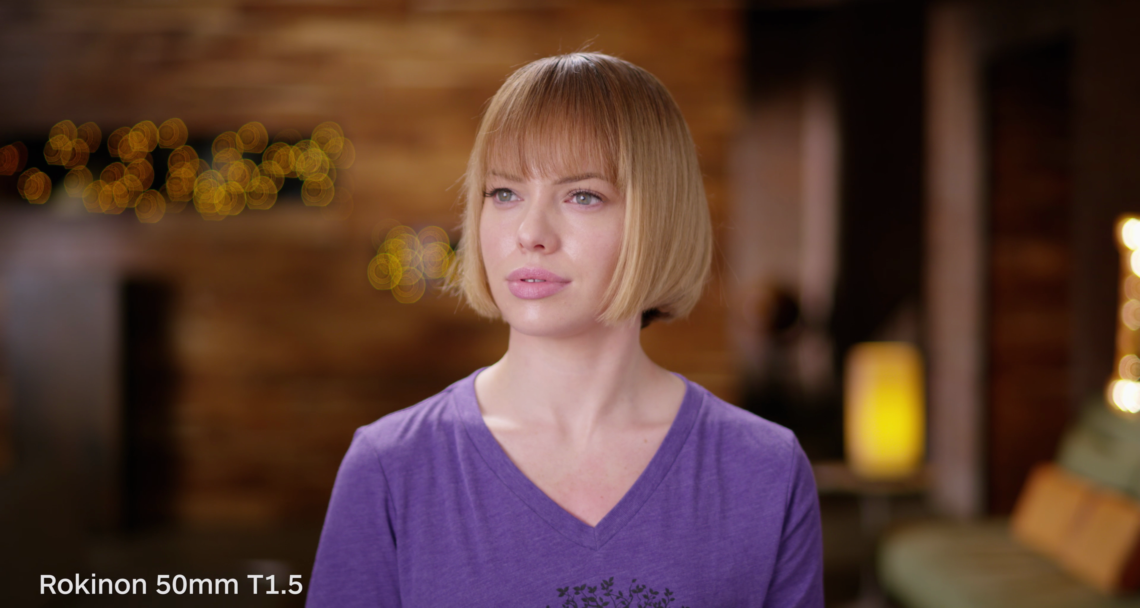

Take the excellent Rokinon 50mm T1.5 lens for example.  Here's a frame of it wide open, saved as a 4K 5MB PNG file vs a 1080p 700K Jpeg file, and there's barely any perceptible difference in resolution (there is a shift in colour though as photoshop seems to have changed the colours for some reason):
Also, note the small amount of CA on the models right upper-shoulder where you can see some green fringing on the edge.  Note that it's still visible on the 1080 version, and it's also still slightly visible on the 720p frame I didn't bother to upload.
I did the same comparison on the spectacularly expensive Master Prime and there is a decent difference between 4K and 1080p with that lens, however there is still a minor amount of CA visible in the same location.  This is a weakness on a $40K lens that would be visible on any budget 4K sensor, and as it is visible over a band 4 pixels wide on the 1080p downscale of that image, will also be visible on a 1080p camera too.
