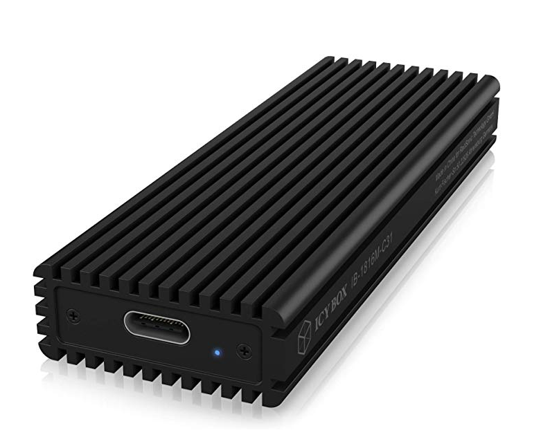

Lars Steenhoff Posted November 18, 2019 Share Posted November 18, 2019 Time to buy some ssd soon https://www.eurogamer.net/articles/2019-11-18-these-early-black-friday-ssd-deals-start-at-under-gbp90 AndI wonder if this fits under the camera: https://www.amazon.co.uk/ICY-BOX-Enclosure-USB-C-Aluminium/dp/B07JJXCSC4/ref=pd_sbs_23_6/259-6578831-3731332?_encoding=UTF8&pd_rd_i=B07JJXCSC4&pd_rd_r=b4280426-078f-4369-b526-edaf86434aa7&pd_rd_w=u8Jet&pd_rd_wg=u3GEr&pf_rd_p=cc188cba-1892-42b3-956f-6c67d0ab7a00&pf_rd_r=2Q7Y9GVDF0J1BS63E13M&psc=1&refRID=2Q7Y9GVDF0J1BS63E13M Link to comment Share on other sites More sharing options...

Brian Williams Posted November 19, 2019 Share Posted November 19, 2019 On 11/18/2019 at 5:08 AM, Lars Steenhoff said: Time to buy some ssd soon https://www.eurogamer.net/articles/2019-11-18-these-early-black-friday-ssd-deals-start-at-under-gbp90 AndI wonder if this fits under the camera: https://www.amazon.co.uk/ICY-BOX-Enclosure-USB-C-Aluminium/dp/B07JJXCSC4/ref=pd_sbs_23_6/259-6578831-3731332?_encoding=UTF8&pd_rd_i=B07JJXCSC4&pd_rd_r=b4280426-078f-4369-b526-edaf86434aa7&pd_rd_w=u8Jet&pd_rd_wg=u3GEr&pf_rd_p=cc188cba-1892-42b3-956f-6c67d0ab7a00&pf_rd_r=2Q7Y9GVDF0J1BS63E13M&psc=1&refRID=2Q7Y9GVDF0J1BS63E13M I’m curious to know which SSDs will work with the camera; I know Sigma said only the Samsung T5’s greater than 250gb’s would be officially supported at this point, but I’m sure others can work. Link to comment Share on other sites More sharing options...
Lars Steenhoff Posted November 19, 2019 Share Posted November 19, 2019 I'm pretty sure the nvme ssd's should work, they are much faster than the samsung t5, so I don't see any problems. Link to comment Share on other sites More sharing options...

Lars Steenhoff Posted November 19, 2019 Share Posted November 19, 2019 I read on amazon : Read and write speeds of over 850 MBps, when connected to a Thunderbolt 3 or USB 3.1 Gen 2 port. Over 40% faster read speeds and over 200% faster write speeds than leading SATA SSD external enclosures and USB 3.0 flash drives, make long wait times a thing of the past. https://www.amazon.com/Protection-Enclosure-Innovative-Connecting-Thunderbolt/dp/B07Q7H5QLX This is the big B meaning megabytes your stating it in megabits 850 megabytes equals 6800 megabits Link to comment Share on other sites More sharing options...
Cinegain Posted November 20, 2019 Share Posted November 20, 2019 Wonder if this thing really is up to snuff: https://www.kickstarter.com/projects/2124504218/warpdrive-high-speed-portable-ssd/description Lars Steenhoff 1 Link to comment Share on other sites More sharing options...
rawshooter Posted November 20, 2019 Share Posted November 20, 2019 The question still is: What is the power consumption of this solution? It may be fast and affordable but drain the battery much faster than a T5. Link to comment Share on other sites More sharing options...
