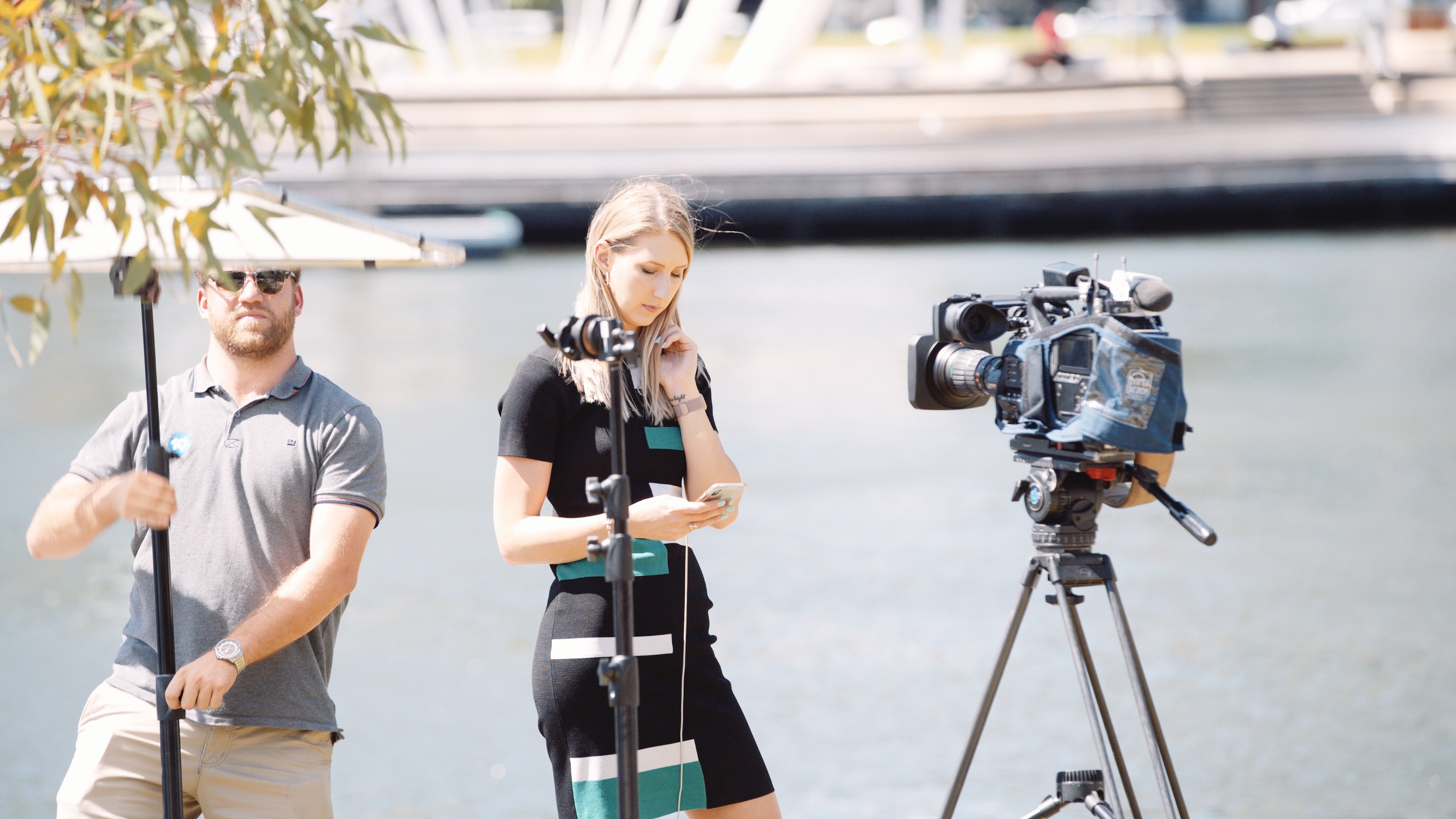

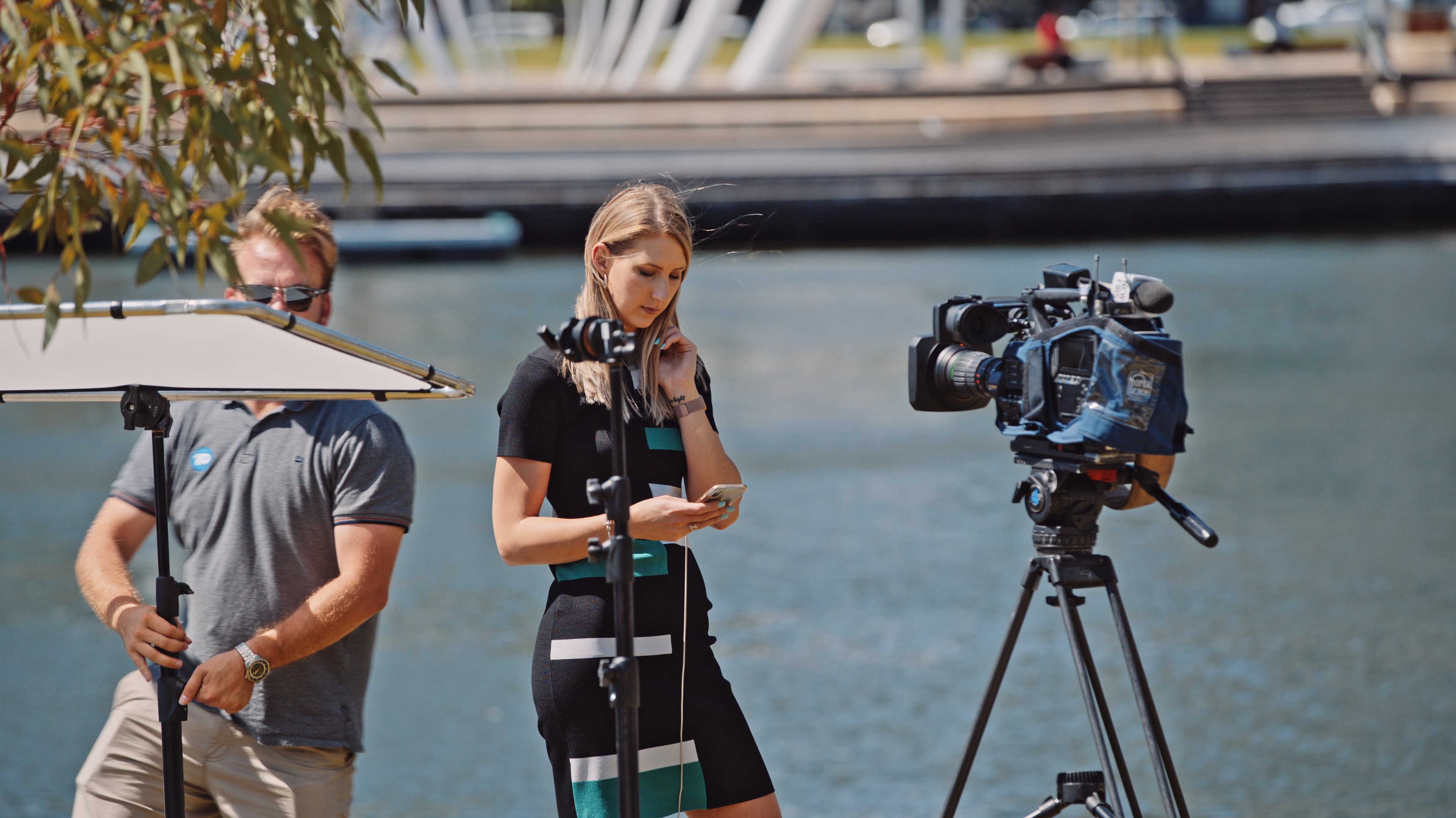

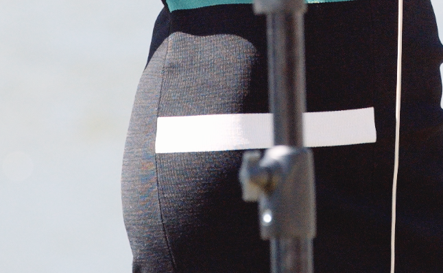

mercer Posted December 1, 2019 Share Posted December 1, 2019 2 hours ago, Lars Steenhoff said: I downloaded the shot with the girl next to the water and when I push the exposure a bit you can clearly see moire in the dress around her hip. good thing I plan on using some vintage lenses that are not that clinically sharp. I'm happy with highlight recovery in resolve, it gets back some very hot spot on her arm. If you look at the shadowed part of her dress, it looks like chroma noise to me. You'll see it with ML Raw with underexposed shadows, but this shot is hardly underexposed. Hmm. Link to comment Share on other sites More sharing options...
Lars Steenhoff Posted December 1, 2019 Share Posted December 1, 2019 It's moire, Its more obvious when playing the whole clip. The dress has fine lines that create this effect. https://www.dropbox.com/s/newx1n59ihz0lbl/moire.mov?dl=0 Here' the full clip, I developed it with sharping quite high because I wanted to see what was going on I did notice that when I open the files in adobe camera raw the moire effect is almost gone, so it may also be something todo the way resolve handles this Link to comment Share on other sites More sharing options...
paulinventome Posted December 1, 2019 Share Posted December 1, 2019 The charts and the sharpness tests are tough metrics and not real world either. AFAIK the downsampling is in some way to minimise moire because there is no OLPF. You can't really have an OLPF in a camera that switches modes or does stills. I've seen plenty of shots ruined because of that from some quite well known 'prosumer' cameras as well. And BMD is quite notorious for this. They score well on tests but not so much in real world. But the sigma image is quite soft. What the slashcam shows though is a difference between crop and normal and that's interesting. So full frame is downsampled but then it's also fair to say the downsampling isn't an even number and maybe that's why we're seeing these kind of results whereas the S35 mode might actually be putting the sensor into a windowed mode and that's worth looking at more. The 12 bit footage - i strongly think if you are recording 12 bit linear to push the image as high as you can and bring down. Because that really is linear, the brightest stop of light will show nearly 2000 steps of gradation. So push as far as you can to take advantage of the tonality. Of course that's not always possible. The 8 bit footage less so because they are reshaping the data so that top stop takes much less space. Again i'd really hope for 10 shaped bit from 12 bit linear. I do believe if this is the IMX sensor then there is a 4K 14bit crop mode which would be awesome. But with no OLPF then as an overall format you'd see much more aliasing. Lightroom is quite a bad debayer - i see artefacts all over the palace. Resolve is a bit better. SpeedGrade was poor. And nuke used to have some really good options in there (but those got 'upgraded') Motion RAW is quite a bit more difficult than stills RAW and i don't think there is a good DNG option for debayering out there. It would be possible to use temporal debayer but i am no aware of anything like that which exists... Also the reason why it seems better to push the shadows that bring the highlights down is something that just occurred to me on a long drive back. The 12 bit is just truncating the top stops. The whole camera exposure is the same for stills vs cine. So same settings like for like, but the cine has the 2 bits chopped off. So therefore the expectation is for there to be highlights compared to mid grey and it's not quite there. That 14 bit 4K mode would be perfect! cheers Paul Lars Steenhoff 1 Link to comment Share on other sites More sharing options...

paulinventome Posted December 3, 2019 Share Posted December 3, 2019 On 12/1/2019 at 4:15 PM, mercer said: If you look at the shadowed part of her dress, it looks like chroma noise to me. You'll see it with ML Raw with underexposed shadows, but this shot is hardly underexposed. Hmm. IMHO most likely crappy debayering combined with some serious 'clarity' adjustments in that last shot. Whilst i'm all for destruction testing images i also have to balance with i don't shoot like that. I'm more interested in the things that do show all the time, tonality and range. If you ever get to push lightroom around on high contrast edges check some really odd debayering artefacts - and this is supposed to be pro-stills level. The beauty of debayering is the ability to choose different algorithms depending on scene - of course no one actually offers that... cheers Paul mercer 1 Link to comment Share on other sites More sharing options...
Lars Steenhoff Posted December 3, 2019 Share Posted December 3, 2019 You can try this app https://mlv.app You still need to convert first the dng to mlv https://www.magiclantern.fm/forum/index.php?topic=24631.0 It allows you to choose different debayering methods. paulinventome 1 Link to comment Share on other sites More sharing options...
