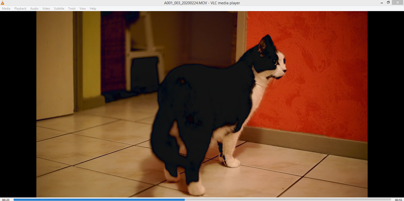

A screenshot from one of the first videos I took with my fp; what could have caused this blown-out black on my cat ? Everything black or dark in the video has this weird shiny cast.
Are you able to upload or send the DNG?
This looks like a workflow issue more than a camera one. Or was this shot in the first place with a .mov format? If it is then it would be a bug by the look of it unless VLC is doing something odd. Does it look the same in other applications?
cheers
Paul
In fact, this issue only happens on my laptop, the video played on my desktop at work is fine. My laptop or VLC must have a calibration problem.

19 hours ago, Mallard said:
In fact, this issue only happens on my laptop, the video played on my desktop at work is fine. My laptop or VLC must have a calibration problem.More important is my issue with the non-functioning AF on stills, as I mentioned upthread:I also had an issue with a stuck red pixel on the screen of my new fp, and other red pixels randomly blinking. Fortunately, the store I bought it at is going to replace it.
Is Sigma guilty of some sloppy quality control ? Because even with my cheapest point-and-shoots in the past, I didn't have those problems.
VLC on Mac is a bit odd to say the least. I would highly recommend 'Screen' for mac as an awesome player (although VLC does attempt more formats). I would point the finger at VLC in this case.
