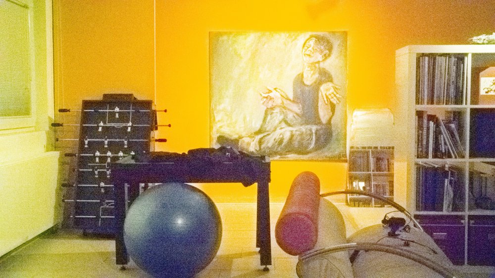

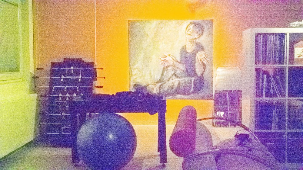

Noli Posted March 11, 2020 Share Posted March 11, 2020 So I've done some ISO flicker testing and got some strange results to share. 100-250 / 500-2.000 / 5.000-10.000 / 16.000-25.600 all with no flicker. 320-400 / 2.500-4.000 / 12.800 show flicker. Overall quite okay compared to what @Scott_Warren tested a few pages ago. So is the flicker issue different for each camera?? I have tried finding the flickering DNG files and opening them in Camera Raw. Previously I got the impression the flicker was not present there, but during this test it showed up there aswell. At ISO 12800 black levels and colour changed for one, sometimes more frames. Theres also seems to be a bug where the first frame of a DNG sequence is overexposed. This occured in clips with and without flicker. In the 12800 sequence the first frame is the same exposure as the flicker that shows up later. In the 320 clip the first frame is a little brighter than the next 3 frames, then colour and brightness change for the whole clip and after 7 seconds flickering appears with colour and brightness of frame 2-4. Another interesting thing I noticed is that the noise going from ISO 10.000 to 12.800 and up changes a lot. Images pushed by 5 stops in Camera Raw. ISO 10.000 ISO 12.800 Link to comment Share on other sites More sharing options...

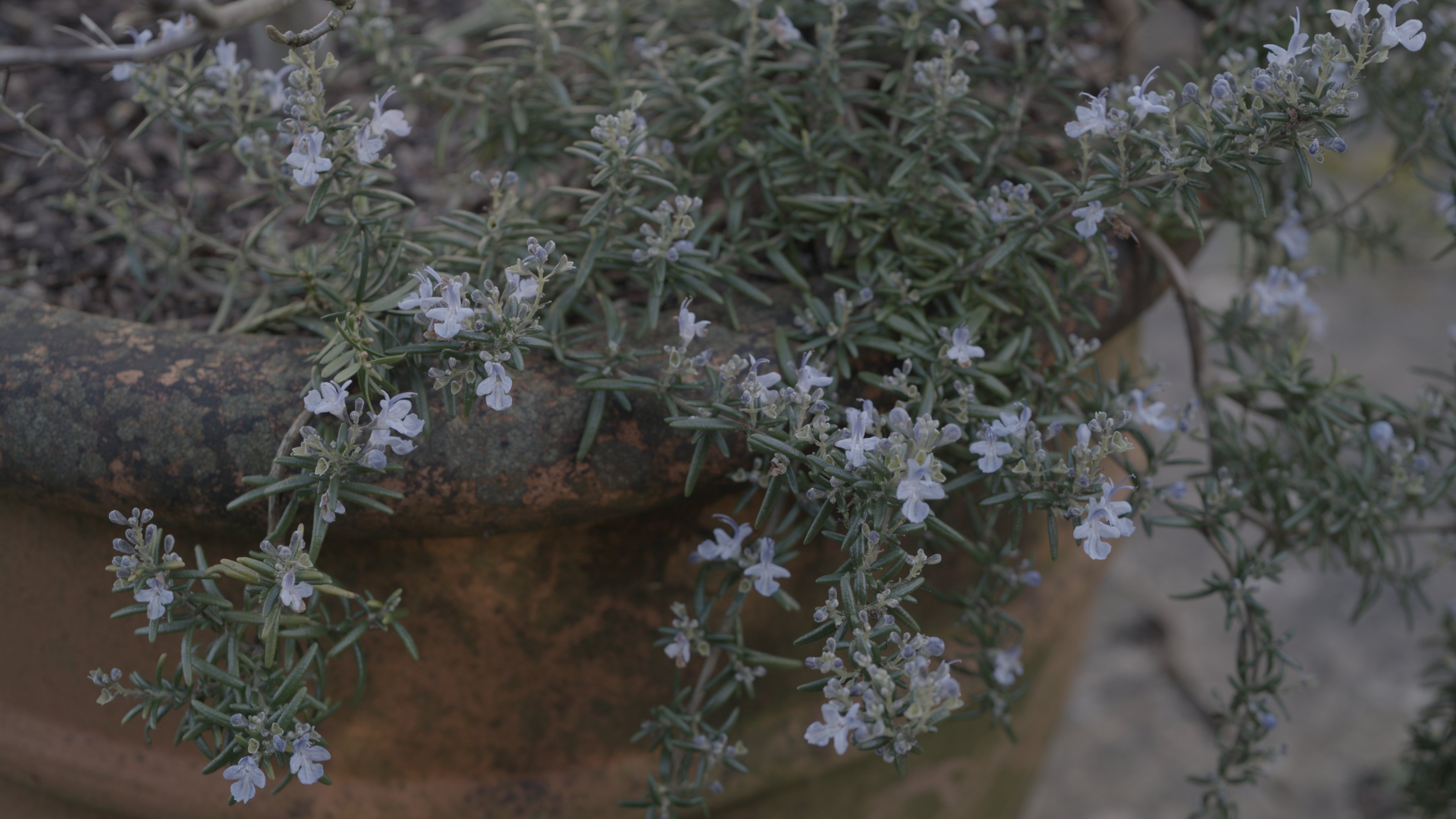

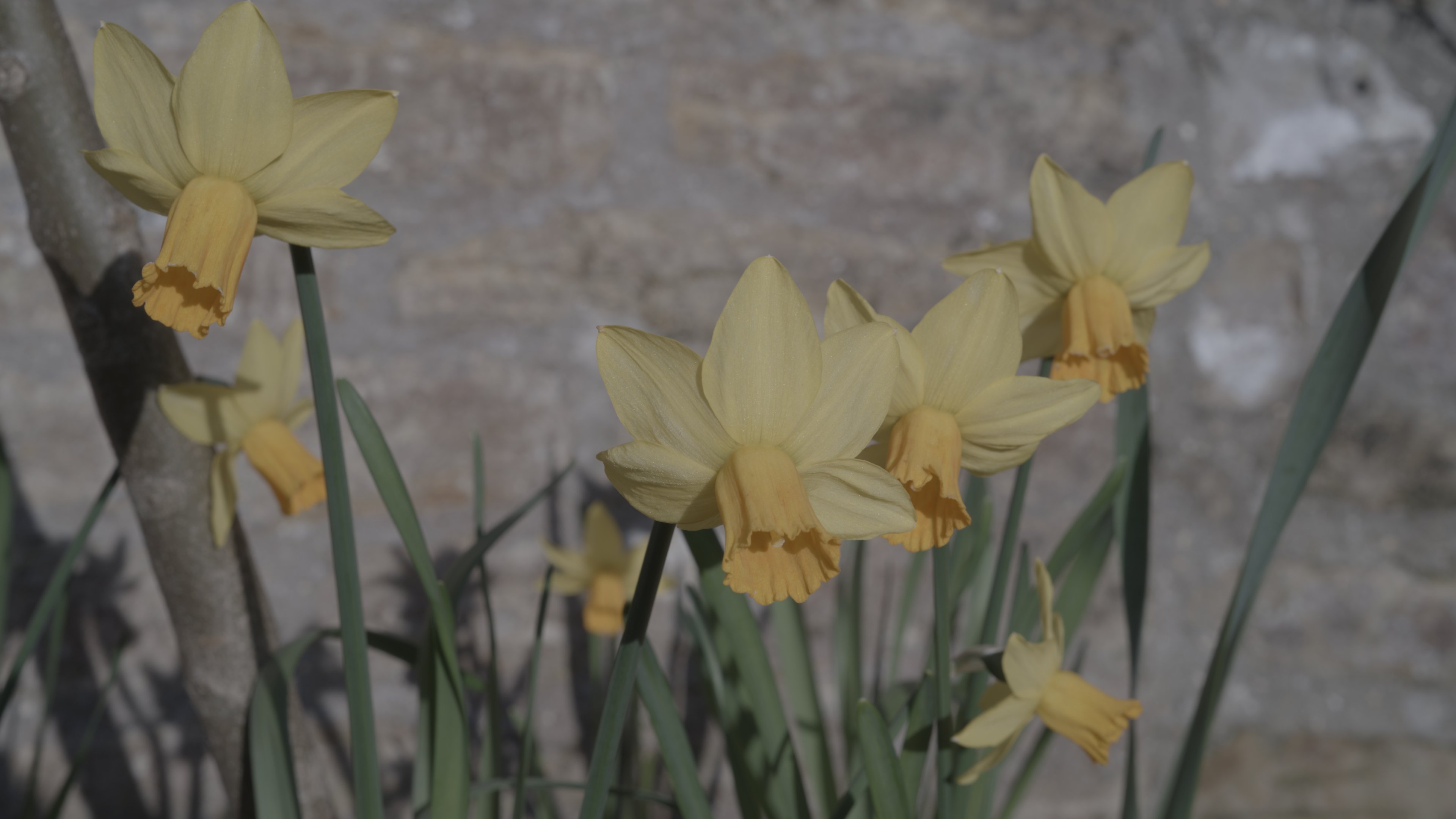

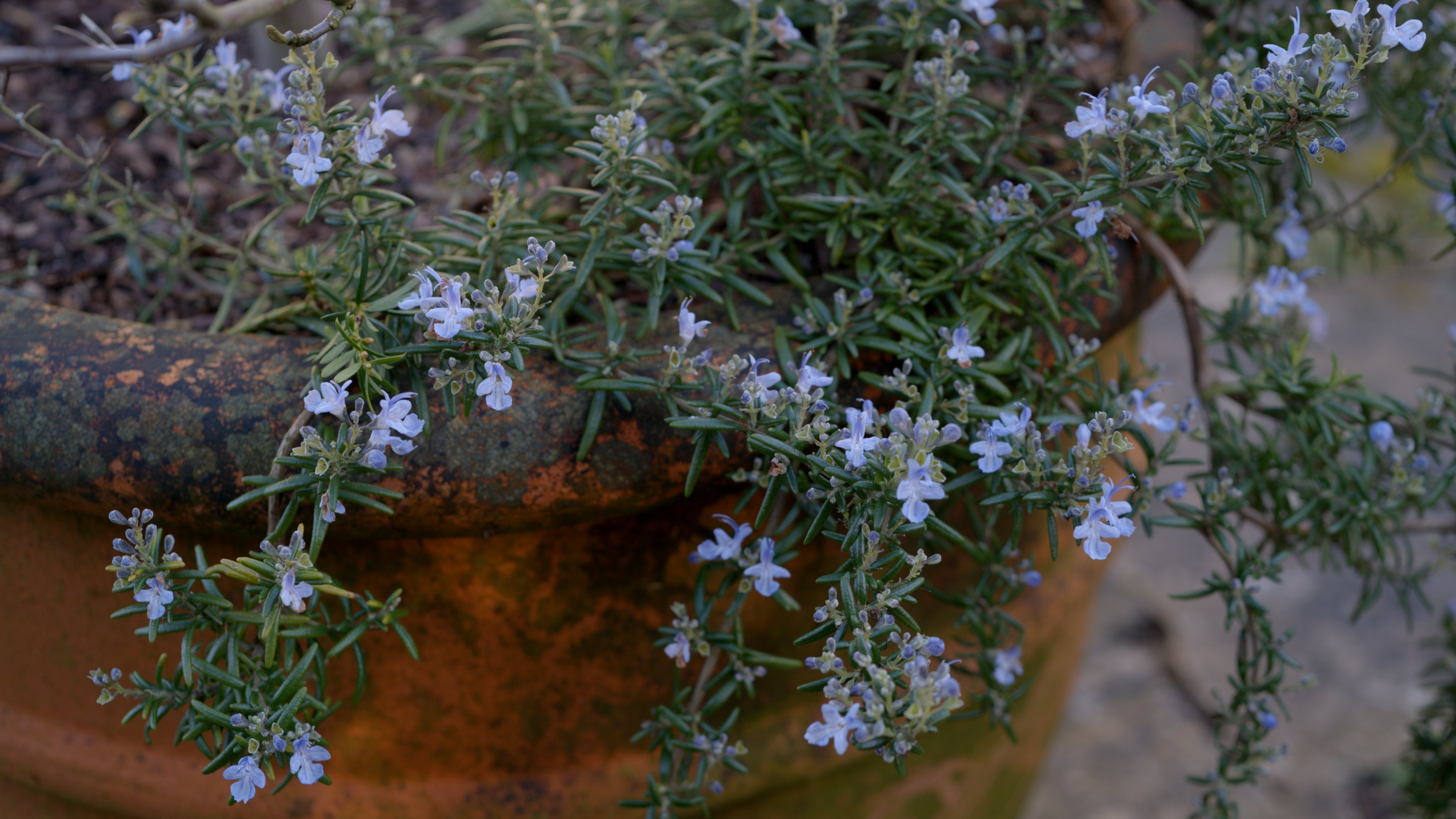

Chris Whitten Posted March 12, 2020 Share Posted March 12, 2020 Just test shot and I'm not getting any blown out first frames. All my frames look identical. Everything on the FP and lens set to manual. Here are 'still' exports from Resolve 16.2. The first frame of my footage. Shot at ISO200, 4K UHD 10 bit, using the Takumar 50mm, no filters. The first still is ungraded, just set clip to Blackmagic Film. Second still is the same frame (1) just adjusting the lift and gain a bit, adding some contrast and saturation. Link to comment Share on other sites More sharing options...
Chris Whitten Posted March 12, 2020 Share Posted March 12, 2020 The second stills are again first frame. Shot in a shadier area at ISO400. Same as before UHD 10bit, Takumar 50mm lens. First still is untouched other than setting clip to Blackmagic Film, second still is light grade by hand - adjust lift and gain, more contrast, more saturation. Link to comment Share on other sites More sharing options...

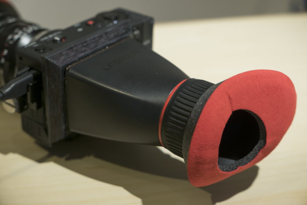

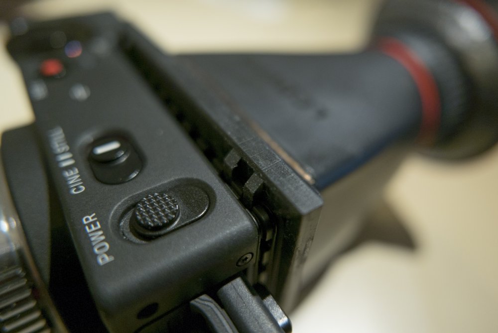

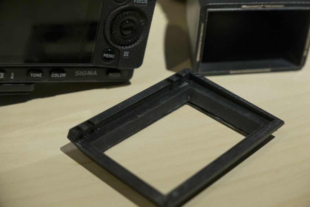

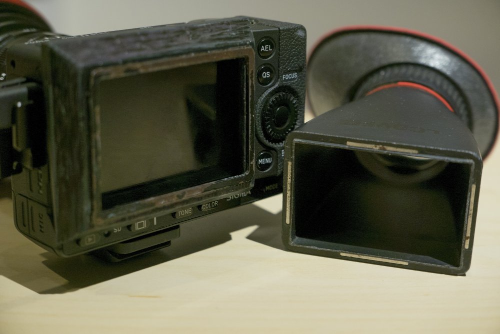

Noli Posted March 12, 2020 Share Posted March 12, 2020 2 hours ago, paulinventome said: Are you sure you are on the latest firmware? This was a bug in the first release but was fixed quite a while ago? cheers Paul Yes, I am on the latest firmware. The notes only mention that they fixed the first frames being enlarged. I have 3D printed a cheap viewfinder attachment that works with a 3.2" Display Loupe you can find on ebay for 20€. I don't know how long it will last but right now it sits pretty tight. It locks into the small vent holes at the top and you can still use all the buttons. If anyone is interested, message me and I can send you the blender file. paulinventome 1 Link to comment Share on other sites More sharing options...

paulinventome Posted March 13, 2020 Share Posted March 13, 2020 On 3/12/2020 at 11:06 AM, Noli said: I have 3D printed a cheap viewfinder attachment that works with a 3.2" Display Loupe you can find on ebay for 20€. I don't know how long it will last but right now it sits pretty tight. It locks into the small vent holes at the top and you can still use all the buttons. That's really cool! IMHO one of the biggest annoyances is the VF. I'd pay good money for an EVF but there are no small ones - portkeys and zacuto are the smallest but they are still too unwieldy. There is a collapsable VF from GGS Foto but having a very tough time getting any decent info about it. I wonder whether a VF with different optics to get it closer to the screen is possible... cheers Paul Link to comment Share on other sites More sharing options...
Super Members BTM_Pix Posted March 13, 2020 Super Members Share Posted March 13, 2020 44 minutes ago, paulinventome said: There is a collapsable VF from GGS Foto but having a very tough time getting any decent info about it. Is it this one ? http://www.ggsfoto.com/en/products/OCULAR.html Looks very smart with the Hasselblad 500CM styling ! I bought a (very) cheapo rubber collapsible loupe which was 3.2 inch and works well on the FP but I need to sort out a mount for it. Based on that, the Nikon D5 version of the Ocular would be the one to get as its the same screen size and the frame looks to be equal thickness on each edge. This is a UK dealer/distributor for it https://www.cameraclean.co.uk/products.php?cat=Ocular+Folding+Viewfinder+-+Black I've bought quite a few bits off them at the Photo/Video show at the NEC over the years and they were set to be there for this year's one until the cancellation which would have been an ideal time to have a hands on look at the Ocular. The stuff they pick up distribution for has always been decent quality though so, for me personally, that would maybe less of a risk of the unknown as a blind purchase if they are selling them. paulinventome 1 Link to comment Share on other sites More sharing options...
Noli Posted March 13, 2020 Share Posted March 13, 2020 The GSS Viewfinder seems to be very nice. This guy uses it in his video: https://youtu.be/phFyPS_uX4w?t=662 I thought about printing a smaller viewfinder frame in combination with a regular magnifing glas to get something more compact. It's really convenient that Sigma releasd the 3D Models for the FP and all acessories. Since I can 3D print for free at my University I think I will try some more stuff, currently working on a handgrip between the size of the small and large one from Sigma. Link to comment Share on other sites More sharing options...

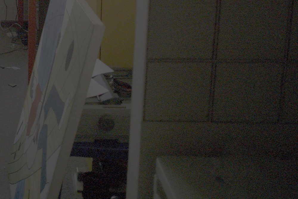

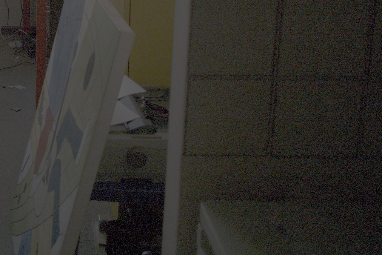

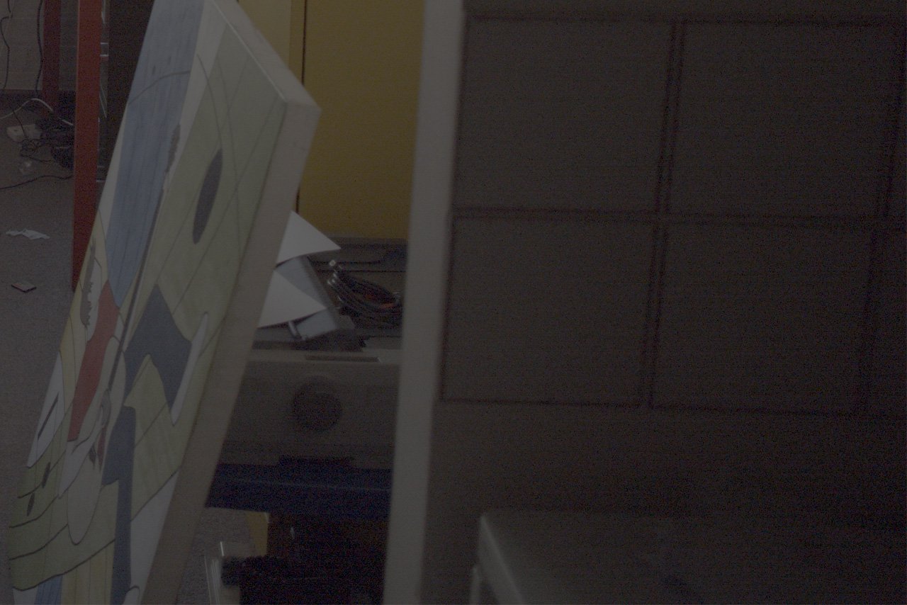

Roogii Posted March 13, 2020 Share Posted March 13, 2020 Great thankyou Paul. What pixel dimension is that 14b crop mode if you know? I will attach two still raw corner crops, one 12b the other 14b. Was at iso 100, a dynamic range stress test where i exposed the sensor to max highlight clipping point outside the window. As you can see, deep in the darkest noise of the sensor, 14bit keeps the noise finer and cleaner and smoother with more detail. In regards to base iso, i simply started at iso 100, exposed a scene to the sensors highlight clipping point, ramped up the iso whilst keeping exposure at that sensor clipping point. Then chose the cleanest image. ISO 100 and 200 are actually exactly identical for the sensor. If you take an image using iso 100, keep your shutter speed and aperture the same and repeat the image at iso 200 - then take those raw images into a program that displays raw histograms such as raw digger, you will see that 100/200 are the same. The camera will lie to you though, making you expose an extra stop for iso100. Not sure I read anywhere that iso100 is a trick/extended iso, but it appears to be. Link to comment Share on other sites More sharing options...
