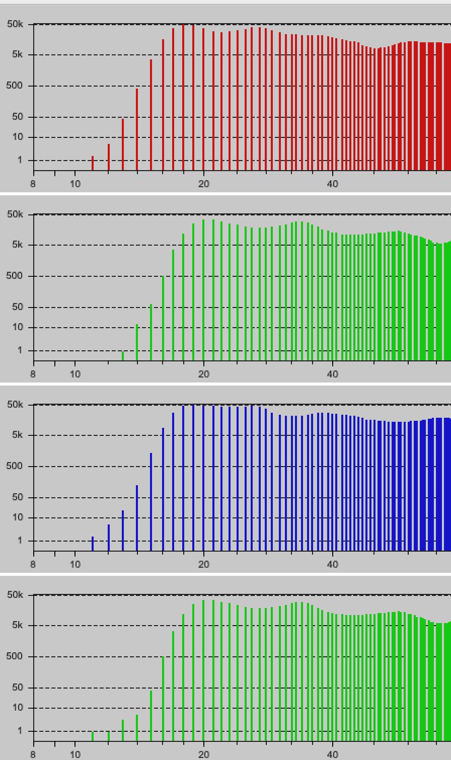

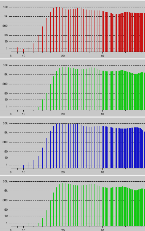

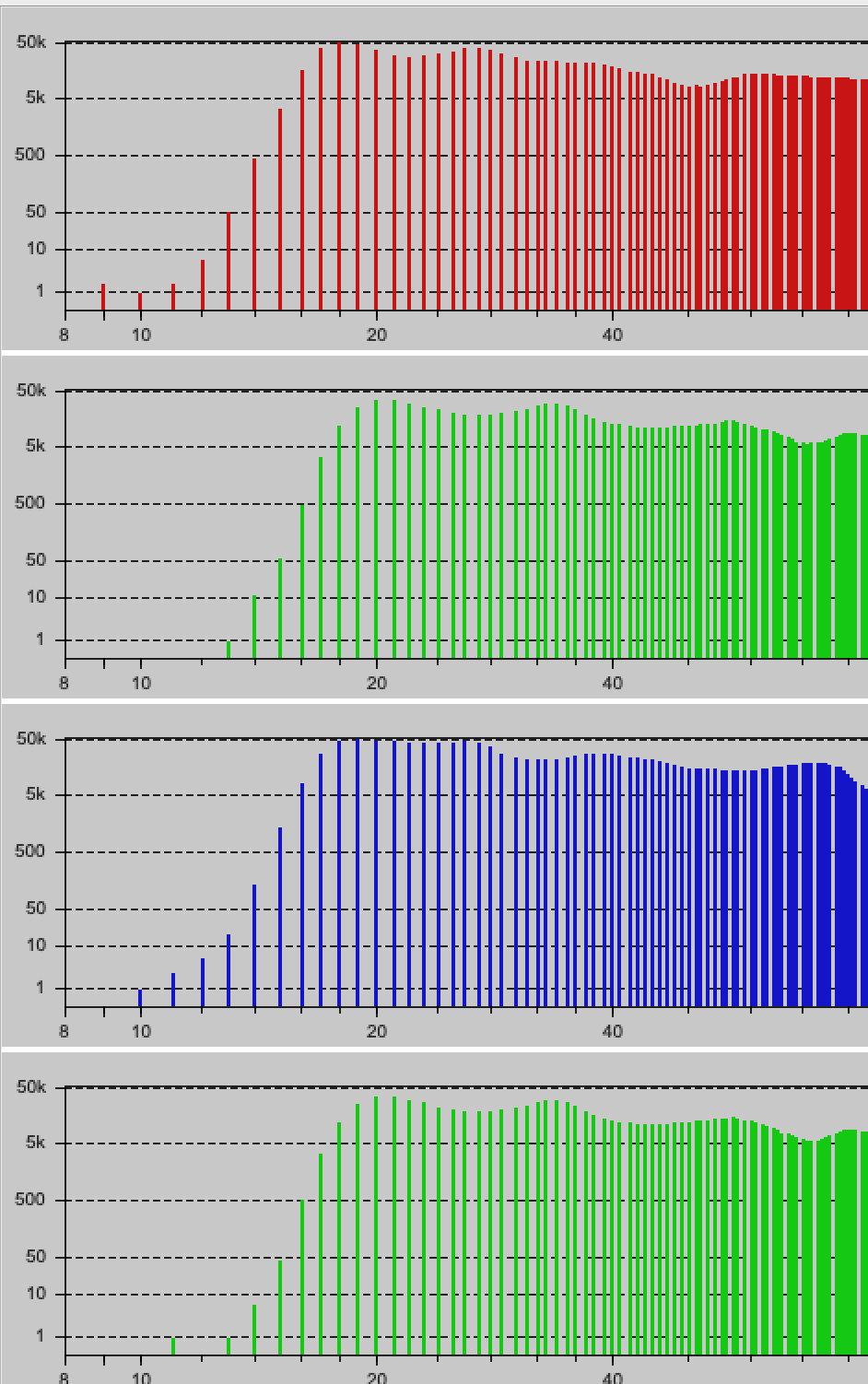

paulinventome Posted March 19, 2020 Share Posted March 19, 2020 19 hours ago, Scott_Warren said: Folder for ISO 320 with 24 frames, and a folder for ISO 800 with 24 frames. The flicker at 800 is pretty crazy so hopefully that's a treasure of information for you to dive into. Initially it reminded me of using canon lenses many years ago where the electronic aperture was not 100% accurate from frame to frame. But then further investigation shows that this just appears to be in the shadows. (Although it could just that it is more observable in the shadows). The two screens show the shadow data changing quite obviously. There are two 'modes' that it appears to be flicking between It doesn't appear to be an overall exposure change. So is this identical in 8 bit, 10 bit and 12 bit? Because one finger could point at the encoding. If it's the same on all of those i would have to suggest the body itself or it's something that we're all getting but not noticed (and i would notice this!) The fact that it doesn't do it in all the ISOs is unusual as well. Are you able to swap the body? Or borrow one to check? cheers Paul Quote Link to comment Share on other sites More sharing options...
Scott_Warren Posted March 19, 2020 Share Posted March 19, 2020 23 minutes ago, paulinventome said: Initially it reminded me of using canon lenses many years ago where the electronic aperture was not 100% accurate from frame to frame. But then further investigation shows that this just appears to be in the shadows. (Although it could just that it is more observable in the shadows). The two screens show the shadow data changing quite obviously. There are two 'modes' that it appears to be flicking between It doesn't appear to be an overall exposure change. So is this identical in 8 bit, 10 bit and 12 bit? Because one finger could point at the encoding. If it's the same on all of those i would have to suggest the body itself or it's something that we're all getting but not noticed (and i would notice this!) The fact that it doesn't do it in all the ISOs is unusual as well. Are you able to swap the body? Or borrow one to check? cheers Paul Heya Paul, I'm not able to swap the body for another one (I'm the only person I know with an fp in my circle of photography friends) but I could certainly try to see if this happens at 10bit and 8bit, as I've as yet only used 12bit for capture. Quote Link to comment Share on other sites More sharing options...

paulinventome Posted March 20, 2020 Share Posted March 20, 2020 1 hour ago, Chris Whitten said: When others posted their 'flickering' examples I often struggled to see it, but it's definitely not obvious to me in Resolve 16 and I definitely haven't had the issue with first frames. On a static scene it's clear. if you download Scotts DNGs it is very obvious, if you go into DNG and bump up the exposure it is even more so. You can see on the scopes that there are two modes that the images are flicking between - one with truncated blacks and one with more shadow detail. In the DNG there is a concept of a black level. This is subtracted from the data and i thought perhaps that was being incorrectly calculated. Because it's jumping between two seemingly fixed states - it does seem like a software thing but then we'd all be seeing it. If it's hardware then is it environment? Temp? I need to try a few things, because it looks like it's shadows only but then this is linear data so changes in shadows are going to be much more obvious than lights. Scott - do you have a macbeth chart? It would be interesting to have a scene with dark, mid and highlight greys and just shoot that with the lowest iso that flickers, Then we can look at the averaged data (to get around noise) and see if the values are linearly incorrect in the data. Also i don't see a reply from redepicguy....? Was it removed? cheers Paul Quote Link to comment Share on other sites More sharing options...
