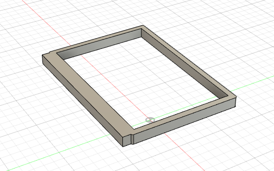

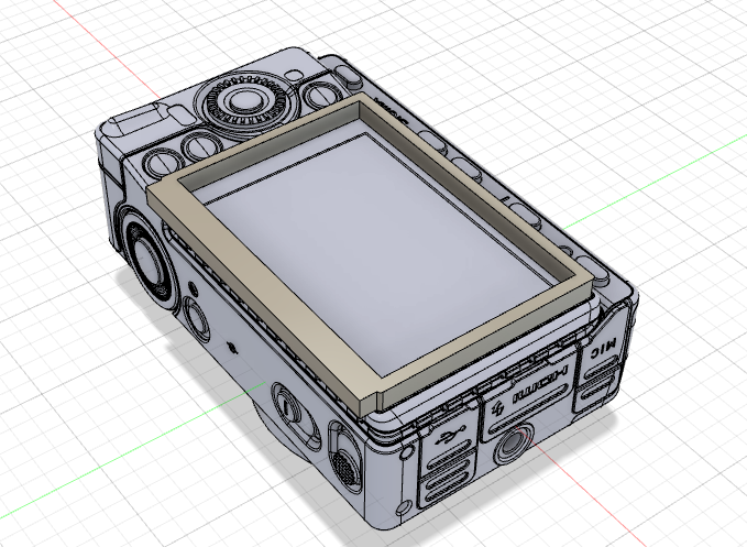

paulinventome Posted March 20, 2020 Share Posted March 20, 2020 23 minutes ago, BTM_Pix said: Sigma providing the 3D files makes it a lot easier to add your own parts. This is what your 0.5cm riser would look like and obviously you can then choose what to do with the top of it to make it marry to your preferred method of mounting. Oh that's awesome. I didn't know that. The small rig cage has a hotshot on it so i was thinking of something that could slide in and fix in there. Needs thinking about. I would need to use a service for 3D Printing here in the UK, there's no point in buying a printer really. I use Houdini and Modo for 3D, what are the normal formats these places accept - can you or anyone recommend any? Cheers Paul Fairkid 1 Link to comment Share on other sites More sharing options...
Super Members BTM_Pix Posted March 20, 2020 Super Members Share Posted March 20, 2020 8 minutes ago, paulinventome said: Oh that's awesome. I didn't know that. The small rig cage has a hotshot on it so i was thinking of something that could slide in and fix in there. Needs thinking about. I would need to use a service for 3D Printing here in the UK, there's no point in buying a printer really. I use Houdini and Modo for 3D, what are the normal formats these places accept - can you or anyone recommend any? Cheers Paul The Sigma files are on their download page here https://www.sigma-global.com/en/cameras/fp-series/download/ For 3D printing in the UK I would recommend this company without hesitation. https://www.3dprint-uk.co.uk You just upload a .stl file to their quote page and away you go. If you are tempted by getting a 3D printer, its definitely worth looking at the resin printers such as the Elegoo Mars which offer really high print quality for the money. The process is very different as its chemical based so there is a bit more of a learning curve but its worth putting the effort in based on the results they produce. The other upside of having a 3D resin printer that I can tell you from personal experience is that should the world suddenly find itself in the middle of a pandemic where access to surgical masks, gloves and isopropyl alcohol are essential items of personal protection then by dint of having one of these resin printers you will already have these items to hand Link to comment Share on other sites More sharing options...
paulinventome Posted March 20, 2020 Share Posted March 20, 2020 28 minutes ago, BTM_Pix said: The other upside of having a 3D resin printer that I can tell you from personal experience is that should the world suddenly find itself in the middle of a pandemic where access to surgical masks, gloves and isopropyl alcohol are essential items of personal protection then by dint of having one of these resin printers you will already have these items to hand I suspect that a purchase now probably doesn't include such niceties.. Good call though, the site looks great. I will try to knock something up and give it a go. Another angle is finding an optical element (or two) that makes for a much more compact VF. cheers Paul Link to comment Share on other sites More sharing options...

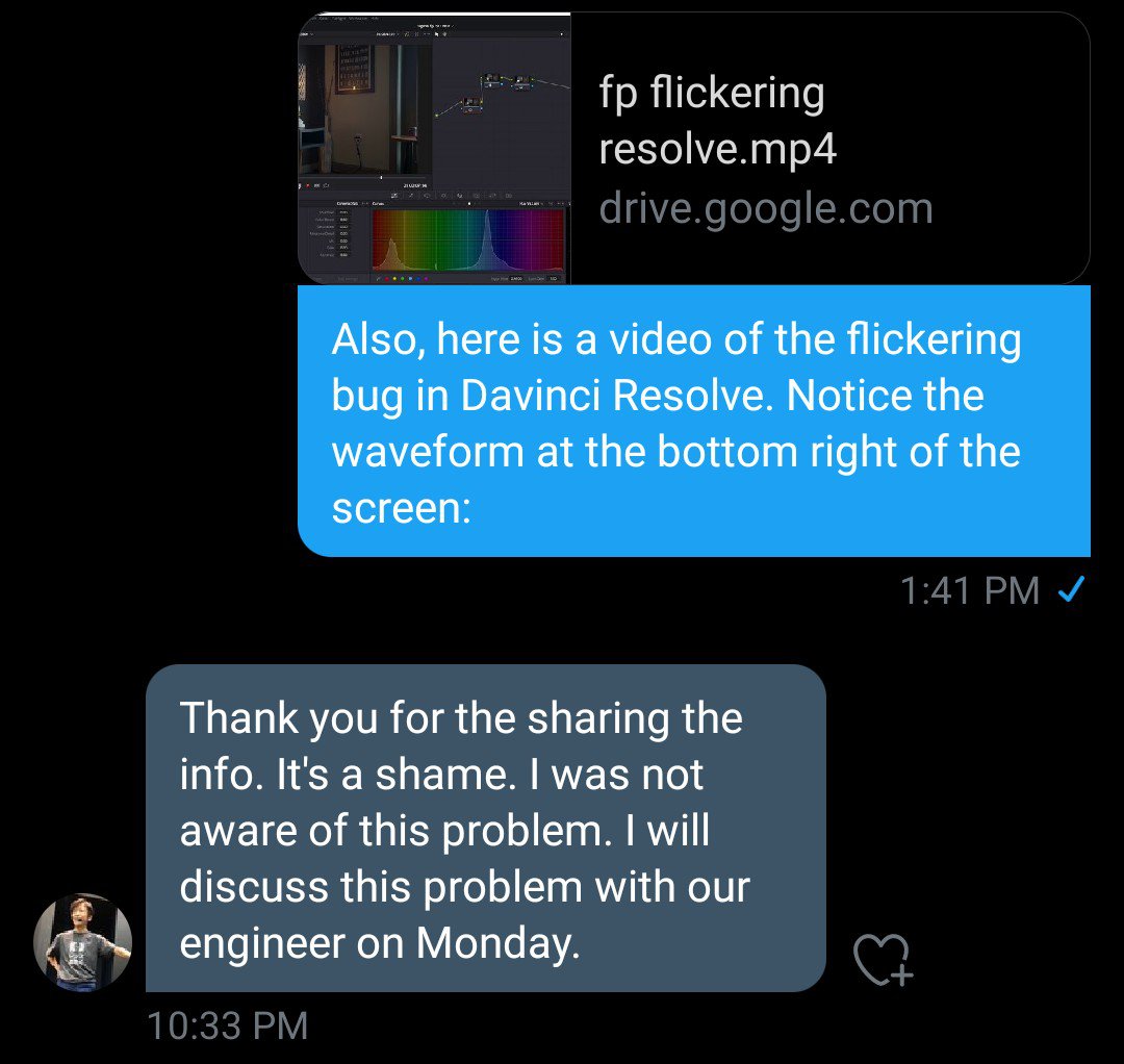

Scott_Warren Posted March 21, 2020 Share Posted March 21, 2020 I reached out to Mr. Yamaki on Twitter again and directed him to the previous page of this thread with everything we've found out so far as well as the capture of the flickering happening in Resolve. Fingers crossed kaylee and Lars Steenhoff 2 Link to comment Share on other sites More sharing options...

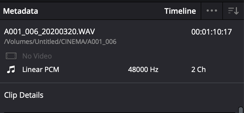

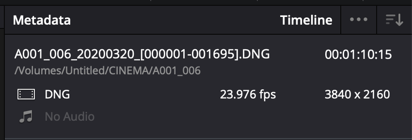

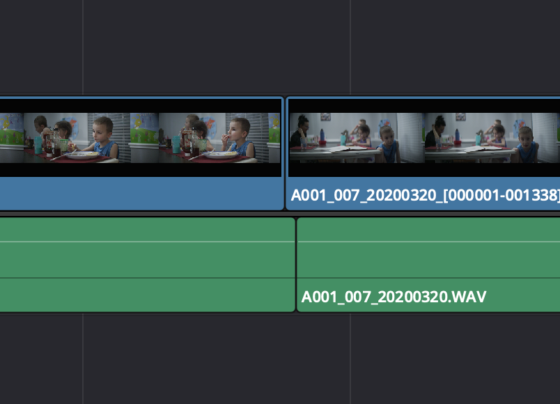

redepicguy Posted March 21, 2020 Share Posted March 21, 2020 Also...anyone else having issues when shooting CDNG...that the audio records 1-3 extra frames? This is a huge PITA. Happens at both 1080 and UHD. Link to comment Share on other sites More sharing options...
Django Posted March 21, 2020 Share Posted March 21, 2020 7 hours ago, Scott_Warren said: I reached out to Mr. Yamaki on Twitter again and directed him to the previous page of this thread with everything we've found out so far as well as the capture of the flickering happening in Resolve. Fingers crossed That's pretty neat you got a direct response from the CEO! Lotta bugs on this unit it seems. A shame considering its price point. Keep debugging / reporting issues, hopefully in couple months the FP will be solid. Haven't shot with it personally, but I really enjoyed the build quality.. Link to comment Share on other sites More sharing options...
