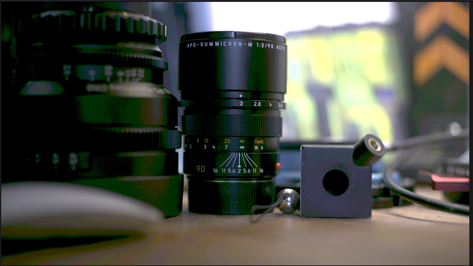

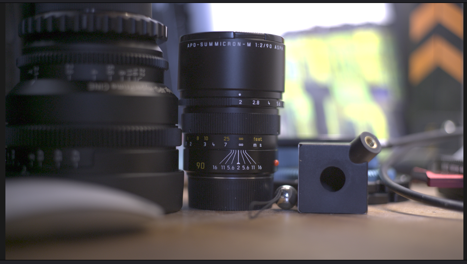

Chris Whitten Posted March 23, 2020 Share Posted March 23, 2020 I have recorded two short clips in 4K (UHD) 10 bit, 25fps. One at ISO125 and one at ISO320. The 125 clip I exposed dark, underexposed. The 320 clip I exposed as correctly as I could. Loading both into Davinci Resolve 16 and selecting > colour page: camera settings: clip: Blackmagic Design film. Both clips have the brighter first frame. I see no flickering. My scopes are static as the clip plays. I bumped up the ISO125 clip by 3 stops exposure. I see no green tinge or tendency to green. I am uploading the two clips to Dropbox and will share the link for anyone to download. You can send them to anyone else if it helps fix these matters (including Sigma). It is taking me 3hrs to upload 10 seconds of DNG to Dropbox (weeps), so bear with me. Link to comment Share on other sites More sharing options...
Scott_Warren Posted March 23, 2020 Share Posted March 23, 2020 On 3/23/2020 at 5:13 PM, Chris Whitten said: I have recorded two short clips in 4K (UHD) 10 bit, 25fps. One at ISO125 and one at ISO320. The 125 clip I exposed dark, underexposed. The 320 clip I exposed as correctly as I could. Loading both into Davinci Resolve 16 and selecting > colour page: camera settings: clip: Blackmagic Design film. Both clips have the brighter first frame. I see no flickering. My scopes are static as the clip plays. I bumped up the ISO125 clip by 3 stops exposure. I see no green tinge or tendency to green. I am uploading the two clips to Dropbox and will share the link for anyone to download. You can send them to anyone else if it helps fix these matters (including Sigma). It is taking me 3hrs to upload 10 seconds of DNG to Dropbox (weeps), so bear with me. Expand At least from what I've seen, the flickering will occur at ISOs just outside of that range. For whatever reason, 100-400 seems to be a fairly "safe" zone with no flickering. Why? Well... X-Files theme begins playing Link to comment Share on other sites More sharing options...
paulinventome Posted March 23, 2020 Share Posted March 23, 2020 On 3/23/2020 at 5:13 PM, Chris Whitten said: I have recorded two short clips in 4K (UHD) 10 bit, 25fps. One at ISO125 and one at ISO320. The 125 clip I exposed dark, underexposed. The 320 clip I exposed as correctly as I could. Loading both into Davinci Resolve 16 and selecting > colour page: camera settings: clip: Blackmagic Design film. Both clips have the brighter first frame. I see no flickering. My scopes are static as the clip plays. I bumped up the ISO125 clip by 3 stops exposure. I see no green tinge or tendency to green. I am uploading the two clips to Dropbox and will share the link for anyone to download. You can send them to anyone else if it helps fix these matters (including Sigma). It is taking me 3hrs to upload 10 seconds of DNG to Dropbox (weeps), so bear with me. Expand Great, although it is 400 that flickers for me!! Look forward to taking a look at those shadows. cheers Paul Link to comment Share on other sites More sharing options...

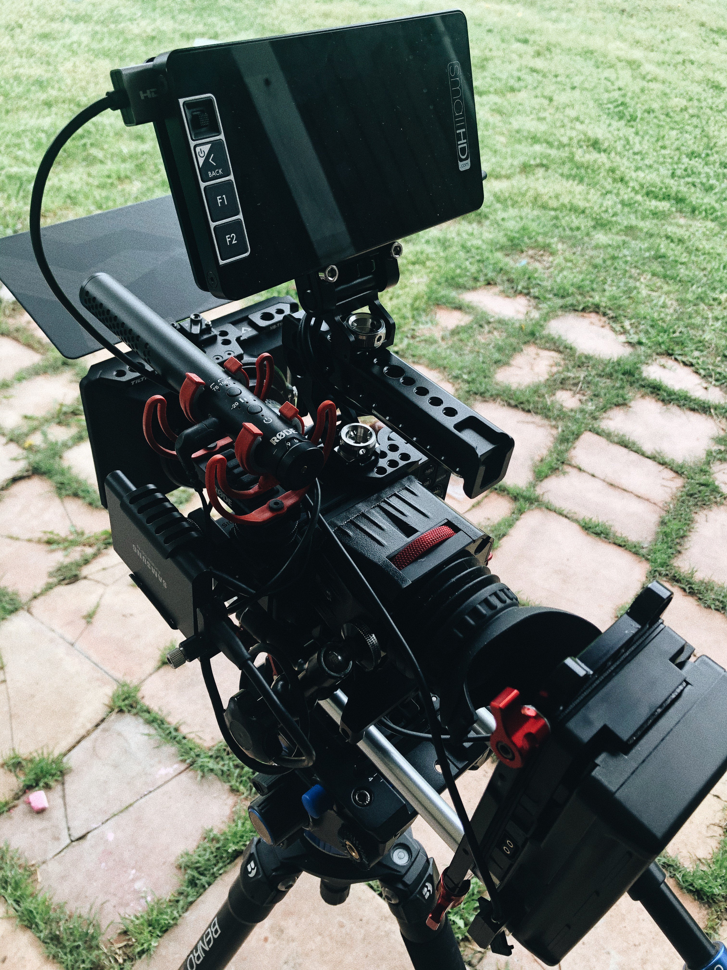

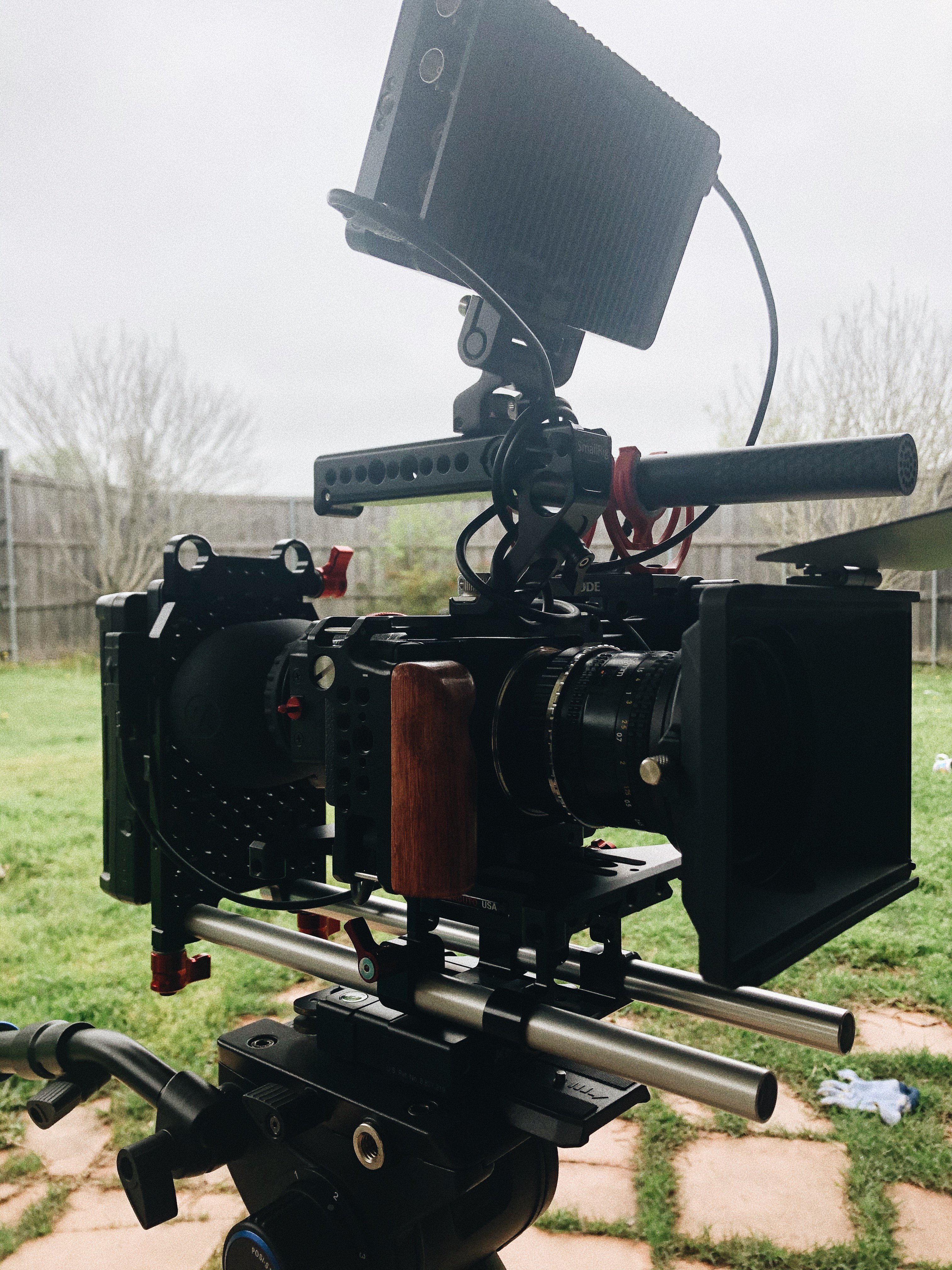

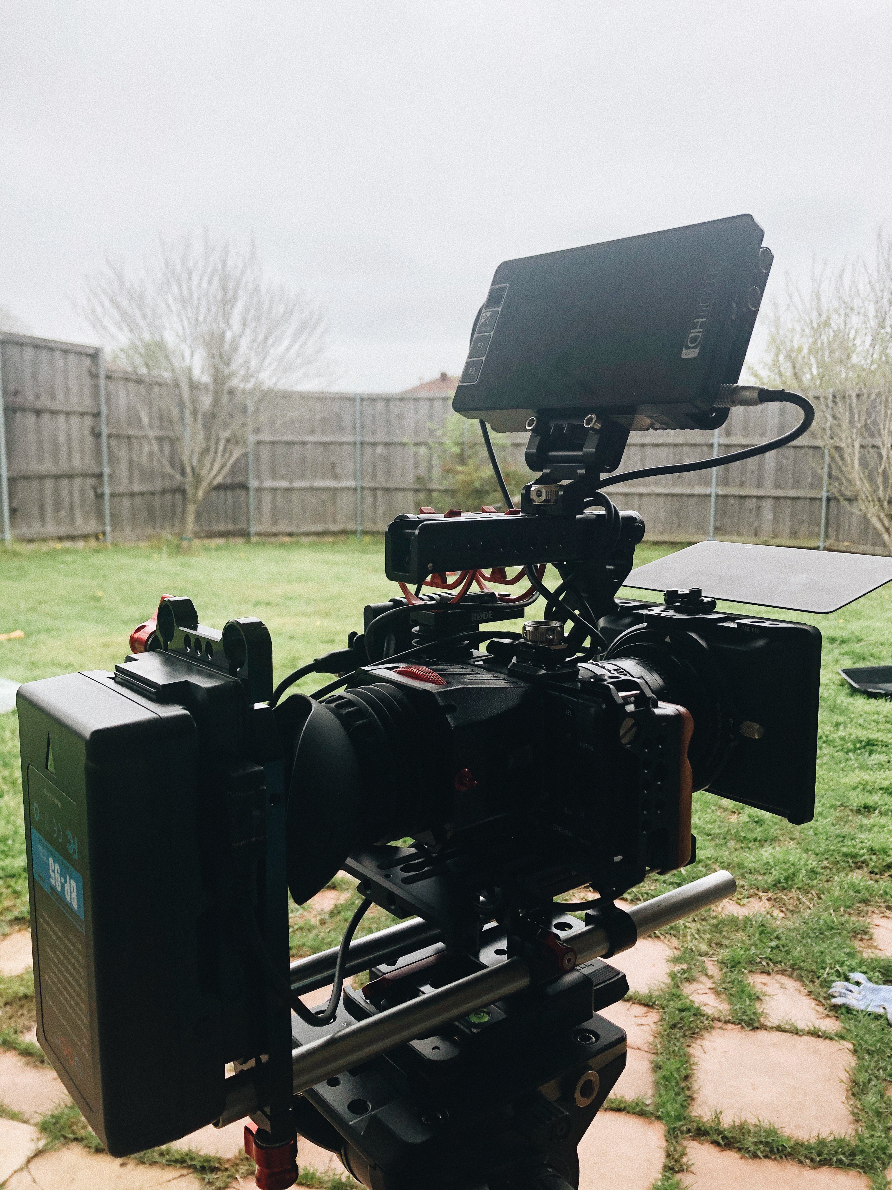

redepicguy Posted March 23, 2020 Share Posted March 23, 2020 Finally getting my rig finalized. Zacuto is sending me a new Zwiss plate (noticed this one is mounted upside down) since the rod receiver was tweaked...but I'm absolutely loving this setup. It allows for power all day and powering my SmallHD ultra bright monitor along with the camera and any other potential accessory I may attach down the road. It adds the weight to make things really stable handheld. The battery just goes right into my shoulder/chest area as I use the Smallrig grip with my right hand and pull focus with my left gripping the rods/lens. Leaving the Zfinder attached allows for quick mobility by removing system from rails (quick release plate) and going really discrete while still maintaining stability. The z-finder frame that originally was included sucked and popped right off, so I improvised. Works well and doesn't flop around at all. Will always be recording CDNG in 1080 or UHD 12 bit...don't see this cam being used any other way. If sigma can just fix a couple of the issues...I'd love it even more! heart0less and JJHLH 2 Link to comment Share on other sites More sharing options...

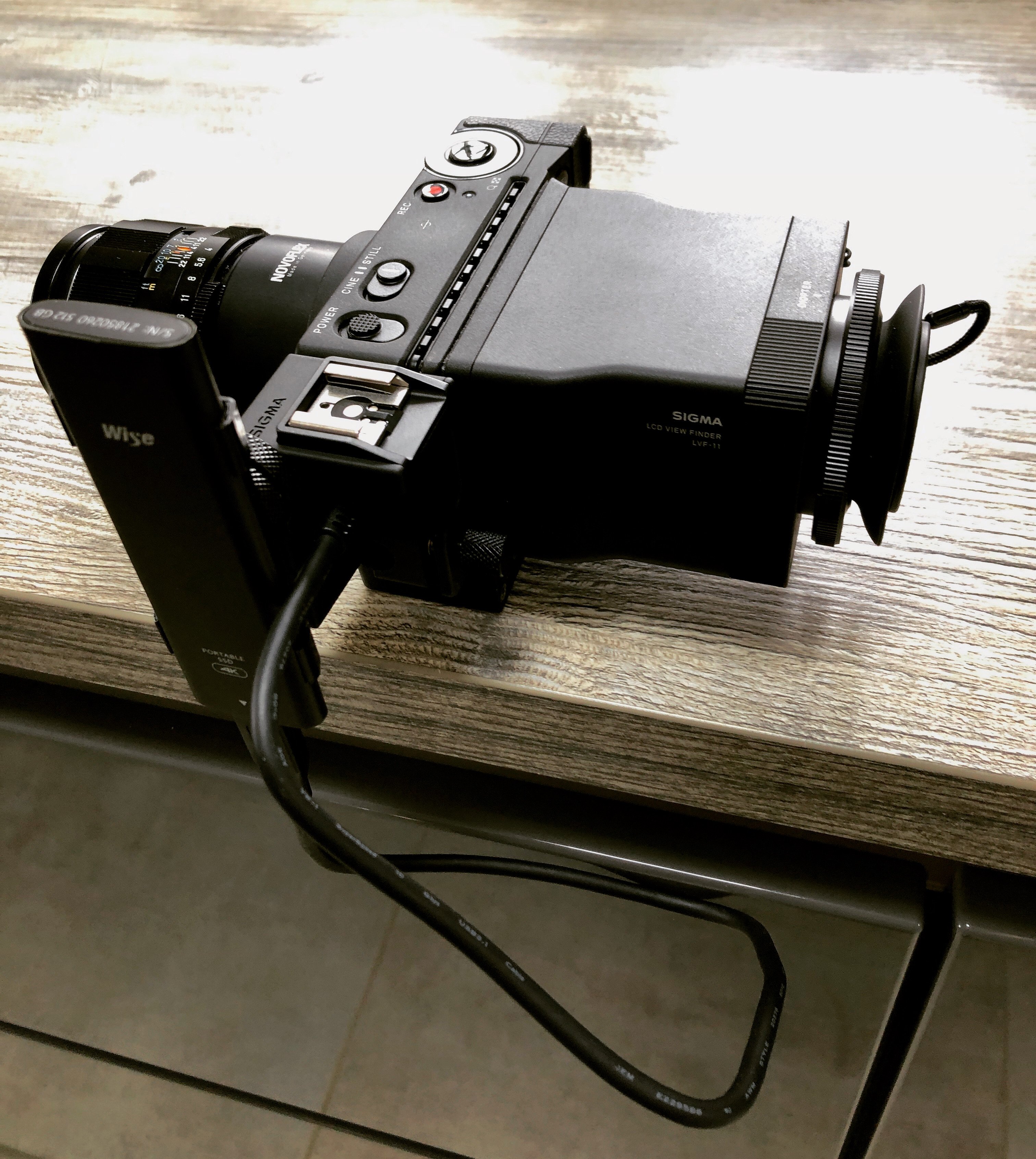

Chris Whitten Posted March 24, 2020 Share Posted March 24, 2020 MOV looks to be very poor compared to the UHD modes. My rig is very small using the Wise portable SSD attached to Sigma's included hot shoe attachment. Link to comment Share on other sites More sharing options...

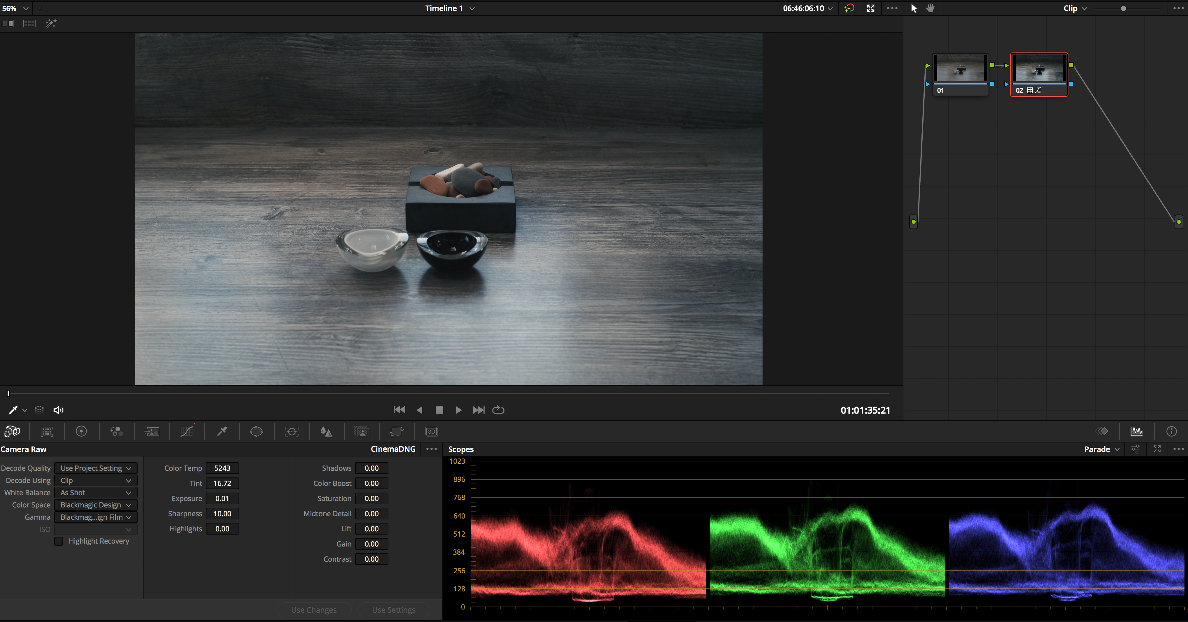

Chris Whitten Posted March 24, 2020 Share Posted March 24, 2020 I shot a short clip at 4K UHD 10bit 25fps. ISO 640 No first frame blowout. Absolutely definitely no flicker, the scopes are rock solid, not moving at all. No green tinge. Attached is a screen shot of the colour page with just LUT dropped on the clip (Crimson Engine Aries lut). I will try and upload the clip to Dropbox at some point today. ISO 640 seems clean and stable to me. Link to comment Share on other sites More sharing options...
paulinventome Posted March 24, 2020 Share Posted March 24, 2020 On 3/23/2020 at 5:13 PM, Chris Whitten said: I have recorded two short clips in 4K (UHD) 10 bit, 25fps. One at ISO125 and one at ISO320. The 125 clip I exposed dark, underexposed. The 320 clip I exposed as correctly as I could. Loading both into Davinci Resolve 16 and selecting > colour page: camera settings: clip: Blackmagic Design film. Both clips have the brighter first frame. I see no flickering. My scopes are static as the clip plays. I bumped up the ISO125 clip by 3 stops exposure. I see no green tinge or tendency to green. I am uploading the two clips to Dropbox and will share the link for anyone to download. You can send them to anyone else if it helps fix these matters (including Sigma). It is taking me 3hrs to upload 10 seconds of DNG to Dropbox (weeps), so bear with me. Expand Got them, thanks Can confirm all of that but you do have green shadows at the very bottom. The scene still has quite a bit of light even at 125 ISO but i can see from the enclosed screenshot where you have a green/magenta at very lower shadow step. You can see it on the left edge in the shadow under the object and also on the darker reflective horn thingy. In 10 bit if you shoot with something that is genuinely black in the scene and then shoot the same scene in 12 bit you can sometimes see by eye but if you raise the whole thing you can see very clearly (like my lenses one which was very very little light and high contrast). This shows the major difference between 12bit and the other modes - the shadow detail. Now you've been using BlackMagic Film and actually that is reducing it a little which is perhaps why you're not seeing it. I'm not using BMDFilm but using the matrixes in the DNG via the normal DNG setting. I don't believe you get the best out of the camera with that setting but i suppose i need to look it that in greater detail. Maybe it does make sense. BMD Film seems to drop the exposure and take some of that tint off but BMD Film is expecting the colorimetry from a BMD camera, not a Sony sensor. cheers Paul On 3/24/2020 at 7:19 AM, Chris Whitten said: MOV looks to be very poor compared to the UHD modes. My rig is very small using the Wise portable SSD attached to Sigma's included hot shoe attachment. Expand I wouldn't touch MOV with a bargepole. There are many better cameras which shoot MOV out there - this beauty is all about the RAW and no compression. cheers Paul JJHLH and Chris Whitten 2 Link to comment Share on other sites More sharing options...

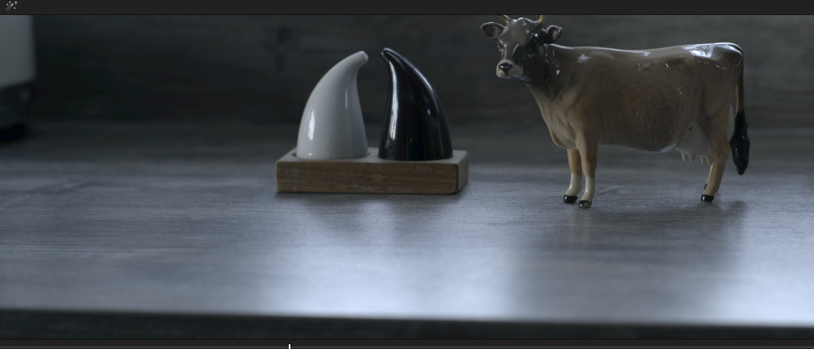

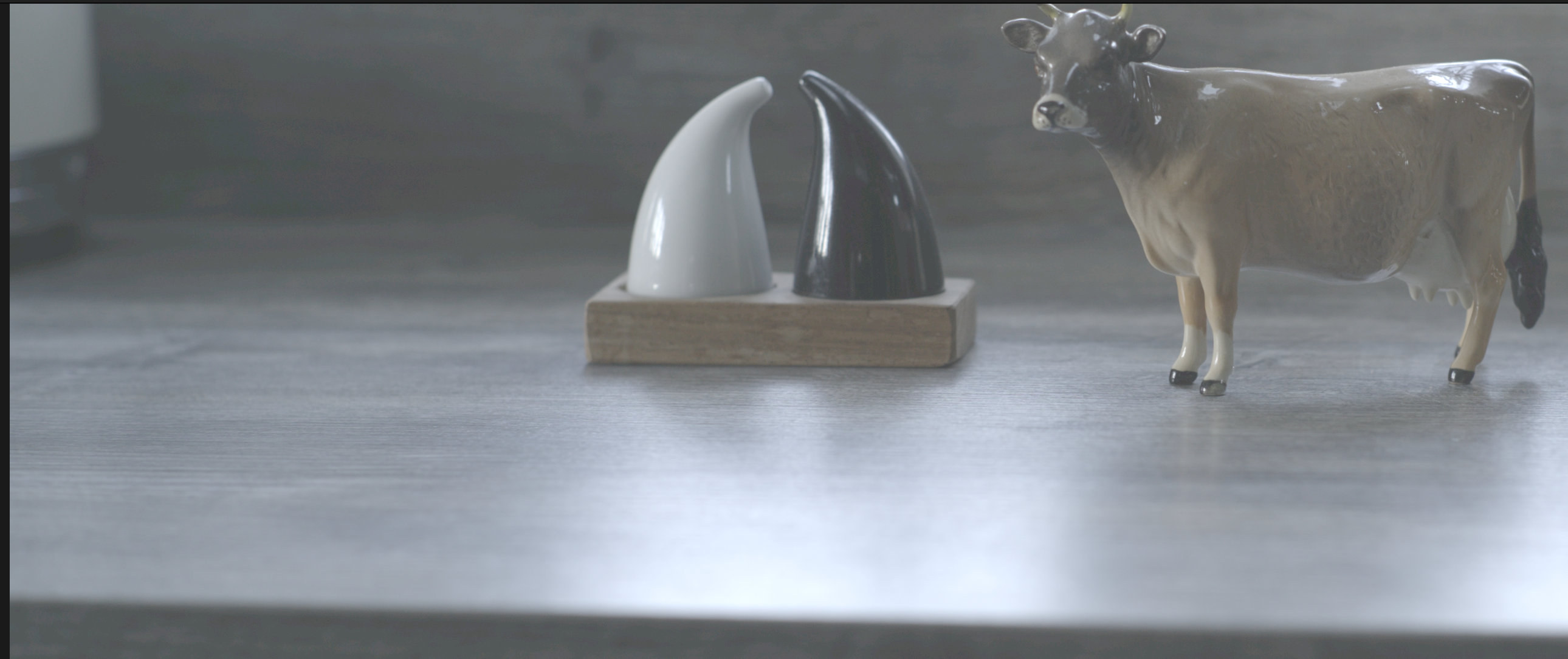

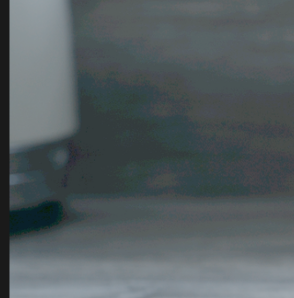

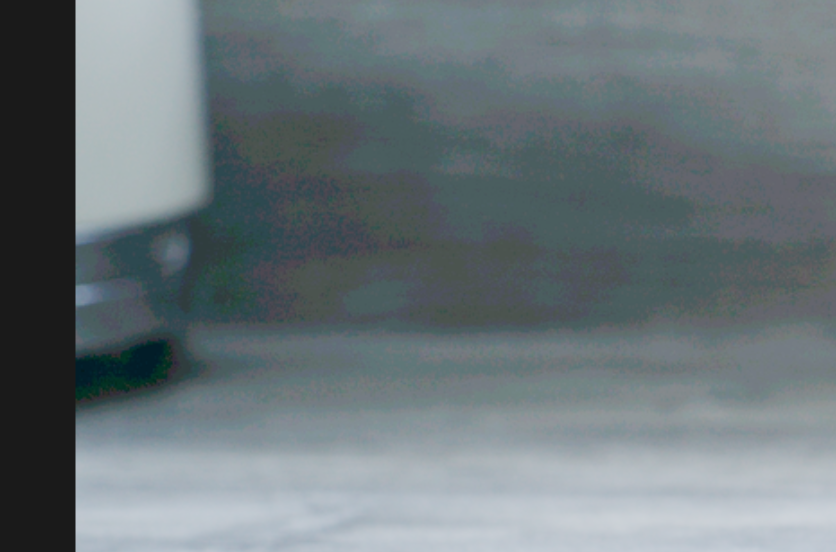

Chris Whitten Posted March 24, 2020 Share Posted March 24, 2020 On 3/24/2020 at 9:38 AM, paulinventome said: Can confirm all of that but you do have green shadows at the very bottom. The scene still has quite a bit of light even at 125 ISO but i can see from the enclosed screenshot where you have a green/magenta at very lower shadow step. You can see it on the left edge in the shadow under the object and also on the darker reflective horn thingy. Expand Tell me what settings you have in Resolve that are making the green visible. I wouldn't;'t be boosting the exposure that much normally. In the screenshot of my clip you posted I can see green and magenta all over the frame, even in the light grey areas. I have not seen that. It could be different equipment (computer OS, Resolve). It could be that I'm doing something wrong and therefore not creating the right conditions to see this issue. Link to comment Share on other sites More sharing options...

Chris Whitten Posted March 24, 2020 Share Posted March 24, 2020 I've just gone into Resolve and looked at my files in CinemaDNG and Blackmagic Film. If I push the exposure to the extreme (in my opinion) the blotchy green and magenta is there in both Resolve settings. If I have exposed the clip correctly, and graded it subjectively correctly, I don't think it's viewable, but it might be. Next I'm going to test with my IR Cut filter from there BMPCC4K. There was an issue with dark blacks and the BMD cameras. Link to comment Share on other sites More sharing options...
paulinventome Posted March 24, 2020 Share Posted March 24, 2020 On 3/24/2020 at 10:06 AM, Chris Whitten said: Tell me what settings you have in Resolve that are making the green visible. I wouldn't;'t be boosting the exposure that much normally. In the screenshot of my clip you posted I can see green and magenta all over the frame, even in the light grey areas. I have not seen that. Expand I run Davinci Colour Managed all set to 709 2.4 gamma In the DNG Settings it's Clip based on CinemaDNG. The Color Space and Gamma are greyed out in Davinci Colour Managed because it will do the 'right' thing. This is the 'native' image or as native as it can be. I see the same in RAW Digger for anaylsis of DNGs so i know it's an honest view. There is a little more shadow latitude this way but not enough to make anything of it. I run Davinci Colour Managed as part of a bigger workflow and pipeline so whatever i do is under that umbrella. And that umbrella also allows me to use IPP2 mapping which i think produces a lovely highlight roll off with DNG footage as well. Screenshots show BMD Film against the above. You can see a bit more detail in the above compared to BMD Film which has a lower exposure. IMHO BMD Film does seem wrong to me. The whole point of Resolve is that you're working in linear light space (photographic) and the purpose of that RAW tab is to move the camera data into linear data. If you choose BMD Film and it changes the curve (or rather it thinks the data coming from the camera has a specific tonality) then the camera isn't really being translated into linear. If you use the camera by itself and you're eyeballing then it doesn't really matter. But if you're using other cameras and need shots to match then it would be very difficult through BMD Film. Shot matching really needs all the cameras to be decoding in a single linear space so that exposure adjustments happen in the same way. And if you are doing any comping or vfx work then you *really* need to know that your data is linear. But i know i'm looking at it from my perspective, so it's really just a IMHO - if you like the look then go for it cheers Paul Link to comment Share on other sites More sharing options...
Chris Whitten Posted March 24, 2020 Share Posted March 24, 2020 Here is the ISO125 clip I shot underexposed. The first clip just has light exposure adjustment using the lift, gamma and gain wheels in Resolve. On the second clip I pushed the exposure to extremes, like 5 stops. The green, purple blotch is visible in both clips IMO, and dramatic in the pushed clip. paulinventome 1 Link to comment Share on other sites More sharing options...
