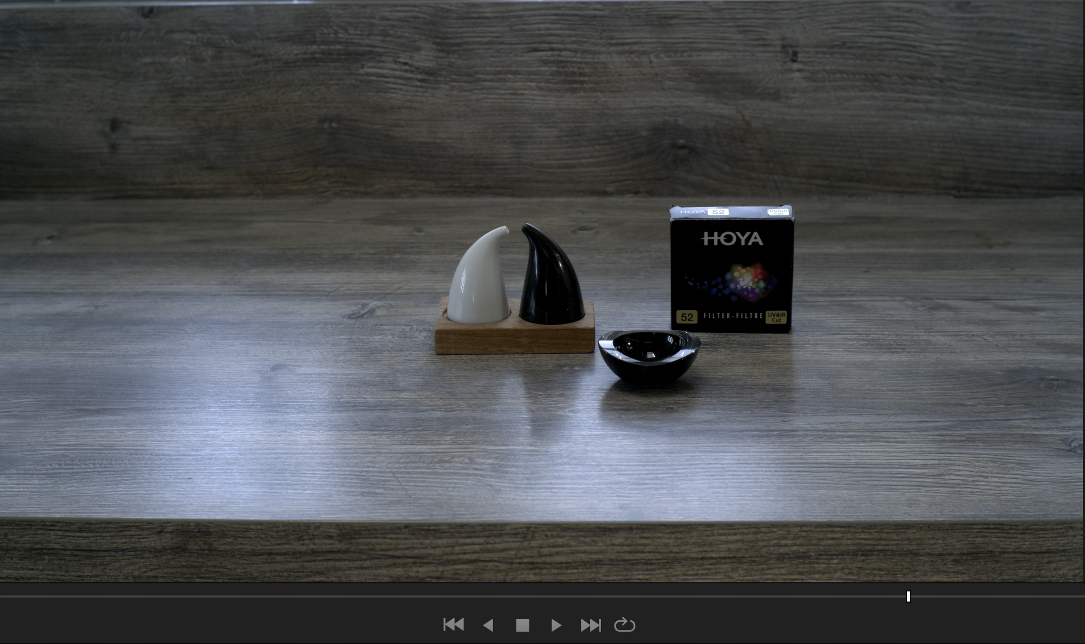

Chris Whitten Posted March 24, 2020 Share Posted March 24, 2020 My latest clip, correctly exposed in the camera IMO. Using the Cinema DNG setting in Resolve, then pushing the exposure to extremes, about 5 stops. Green and purple blotching. Link to comment Share on other sites More sharing options...

Chris Whitten Posted March 24, 2020 Share Posted March 24, 2020 I will try 10 and 12 bit. I really wanted to keep the file sizes down if possible. So I would rather use an effective 10 bit going forward. In addition, it easier to see this 'bug' when pushing the exposure to extremes. I would never want to do that in the real world. The issue is going to be, is the green/purple blotching in everything - well exposed clips, correctly graded, but just very hard to see. That would still be a bug IMO Link to comment Share on other sites More sharing options...

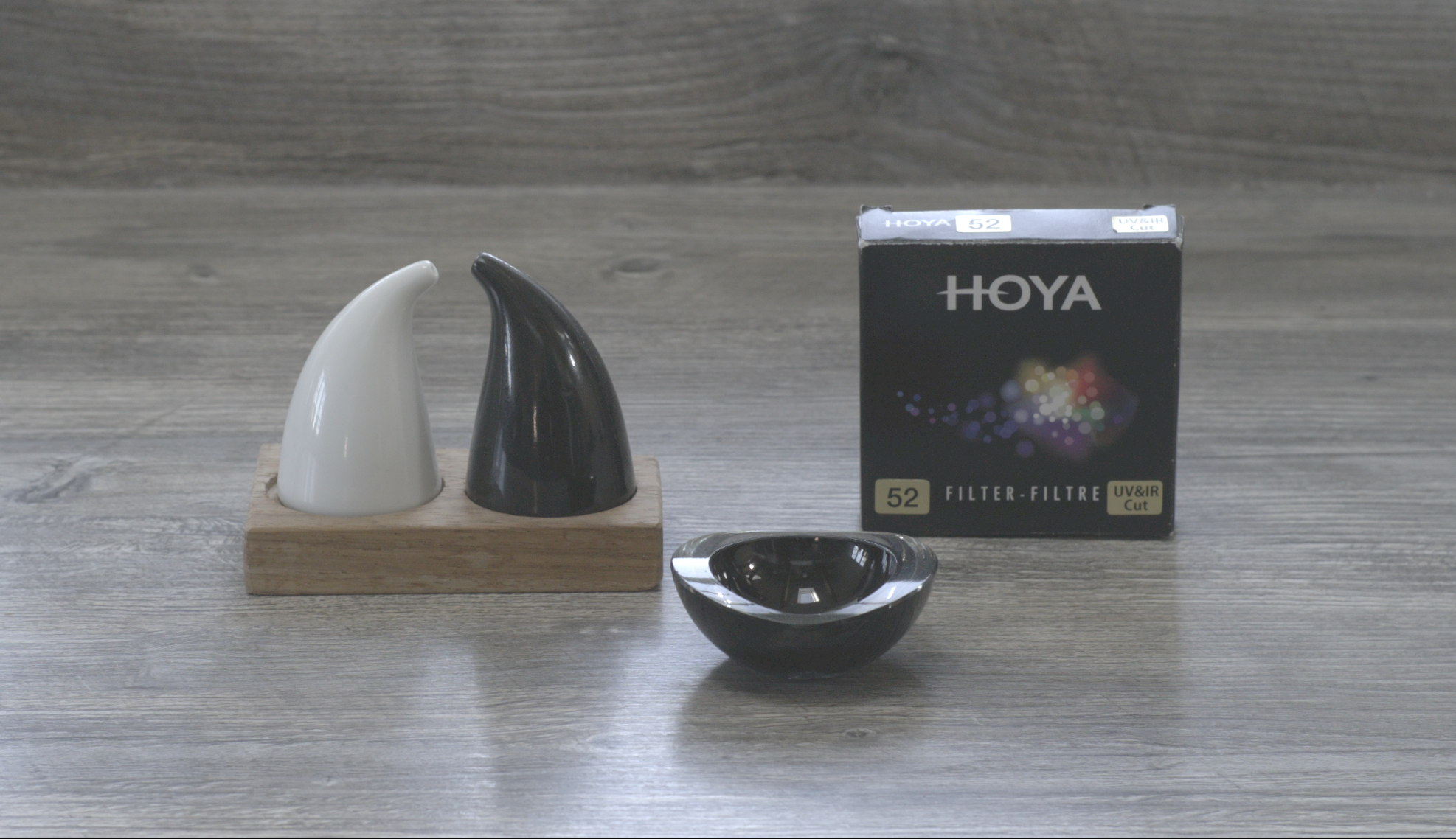

Chris Whitten Posted March 24, 2020 Share Posted March 24, 2020 Here is the latest test. Both ISO 640 4K 10 bit at 25fps with a HOYA IR Cut filter, exposure pushed to extremes in Resolve. Then 4K 12 bit at 23.95fps with the IR Cut and exposure pushed in Resolve. To me both of these look a lot cleaner, the 12 bit very clean. I would never push the exposure this much. To me, the IR Cut filter reduces the purple and green blotch by quite a lot. I mean the whole image looks rough by simply pushing the exposure by 4 or 5 stops. Properly exposed and graded I think you wouldn't see the purple and green issue? Link to comment Share on other sites More sharing options...
Chris Whitten Posted March 24, 2020 Share Posted March 24, 2020 The 10 bit clip with just a bit of lift, gamma, gain, a bit of contrast and a little added saturation. CinemaDNG default, no LUT, no other adjustments. I think it looks ok. No doubt the 12 bit looks even better. Link to comment Share on other sites More sharing options...

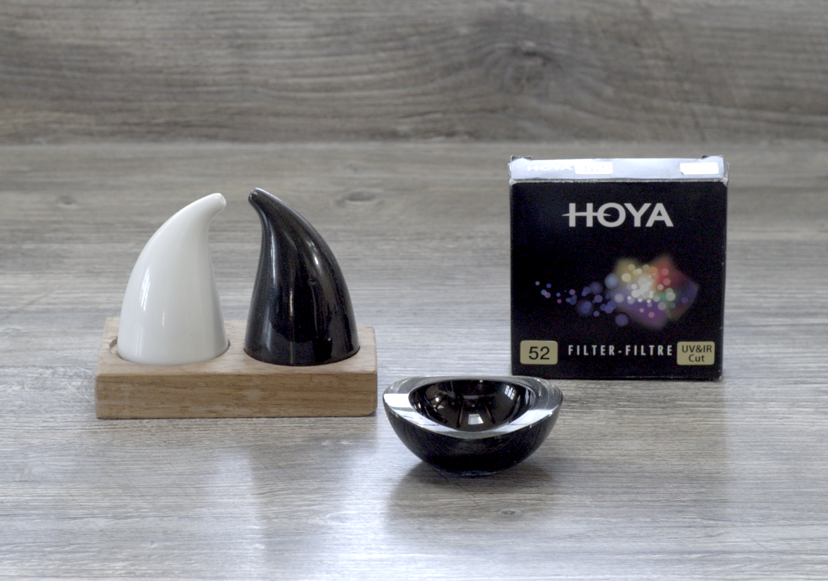

Chris Whitten Posted March 24, 2020 Share Posted March 24, 2020 In the ACES colour space and Cinema DNG Default settings I am not getting anything like the same pronounced purple/green blotchy pattern in the blacks after shooting with the IR Cut Filter. This is the 10bit clip with the exposure increased a lot using the wheels, and pulling up the 'shadows' value. paulinventome and BTM_Pix 2 Link to comment Share on other sites More sharing options...

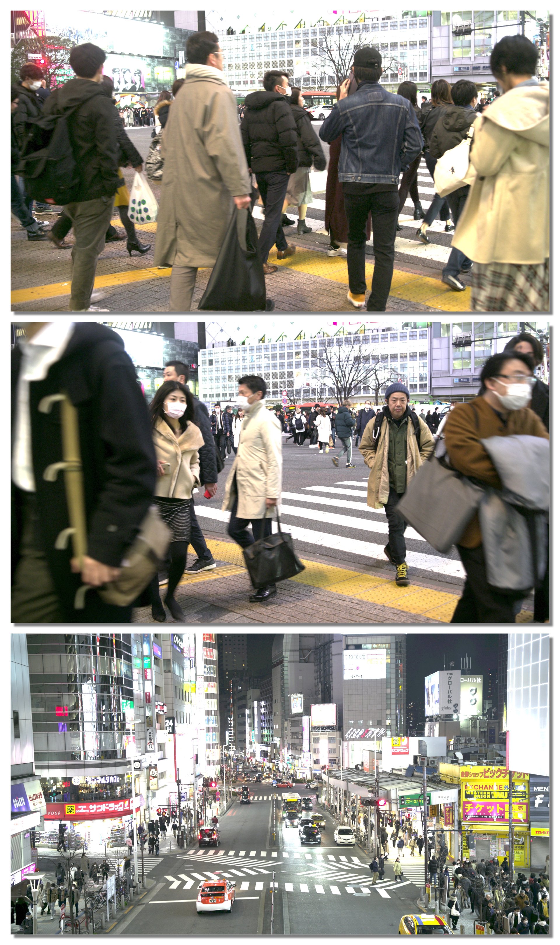

Super Members BTM_Pix Posted March 24, 2020 Super Members Share Posted March 24, 2020 I'm not sure how much this is going to add to the insight regarding the purple/green issue really as its not a particularly controlled test but here are some 8bit and 10bit (8bit on top) frames of mine that I've chosen that I would expect to show the issue as they contain a lot of dark fabric etc. Both of these have been pushed 3 stops and don't show the issue to my eye to any dramatic degree and seem pretty consistent between the two file types. For what its worth, all of my other Sigma cameras (including both the Merrill and Quattro variants of the Foveon sensor) exhibit this problem far, far more dramatically so I was very concerned when I saw it pop up in this thread that it might be carried over to their CMOS cameras ! However, the bottom frame is 8bit, again pushed 3 stops, and it is visible in the top right hand corner but as with the other two frames the whole image is obviously destroyed for all practical purposes anyway at that point so I can live with it. Link to comment Share on other sites More sharing options...
Scott_Warren Posted March 24, 2020 Share Posted March 24, 2020 On 3/24/2020 at 12:53 PM, Chris Whitten said: In the ACES colour space and Cinema DNG Default settings I am not getting anything like the same pronounced purple/green blotchy pattern in the blacks after shooting with the IR Cut Filter. This is the 10bit clip with the exposure increased a lot using the wheels, and pulling up the 'shadows' value. Expand Now this is interesting. I wonder why a colorspace change would have such a dramatic effect on shadow colors? I can't imagine the colorimetry of the BM sensors is THAT different from the fp's when it comes down to numbers. Of course I'm also not an engineer! Link to comment Share on other sites More sharing options...
paulinventome Posted March 24, 2020 Share Posted March 24, 2020 On 3/24/2020 at 12:53 PM, Chris Whitten said: In the ACES colour space and Cinema DNG Default settings I am not getting anything like the same pronounced purple/green blotchy pattern in the blacks after shooting with the IR Cut Filter. This is the 10bit clip with the exposure increased a lot using the wheels, and pulling up the 'shadows' value. Expand Your 640ISO doesn't flicker. That's correct right? I need to redo mine to double check that 320 was doing it all the time but 400 was the trigger factor on my camera. I think there are ways you can get around purple/green and most of them, like BMD Film, involve crushing the shadows and possibly desaturating them, so they're not so obvious. @Lars Steenhoff suggested incorrect black levels but it's not that. I suspect ACES is crushing a bit and an IR Cut filter may leech some colour out overall, you could desaturate the shadows in Resolve. The blotchiness is a factor of 10 bit shadows, each one of those blotches is a single shadow value. In most codecs and compressed formats you would never see this because noise is breaking it all up! But uncompressed shows you what's really there and of course you can add noise to break up the blotches should you want too. I don't want to keep repeating because i will sound like a broken record but if you take a 12 bit file and a 10 bit file that has the same grey point then what you will see in terms of actual finite values are: Stop 0 : 1 value Sopt 1 : 2 values Stop 2 : 4 values Stop 3 : 8 values Stop 4 : 16 values Okay, if 10 bit and 12 bit have the same 18% exposure brightness level (they do, in the DNG) what the 12 bit is giving you are 2 more stops of shadows. So a value in 10 bit which is at stop 2 is 4 values but that same stop in 12 is 16 values. This is why, when you compare 10 bit to 12 bit (look at my lens images) the shadows in the 12 bit are not blotchy, but a lot more tonality. Now if i pushed 12 bit a further two stops then i would see similar blotchiness but the colours are more accurate (not green/magenta) I hope that makes sense to anyone still wrapping their head around things.... cheers Paul Noli 1 Link to comment Share on other sites More sharing options...
