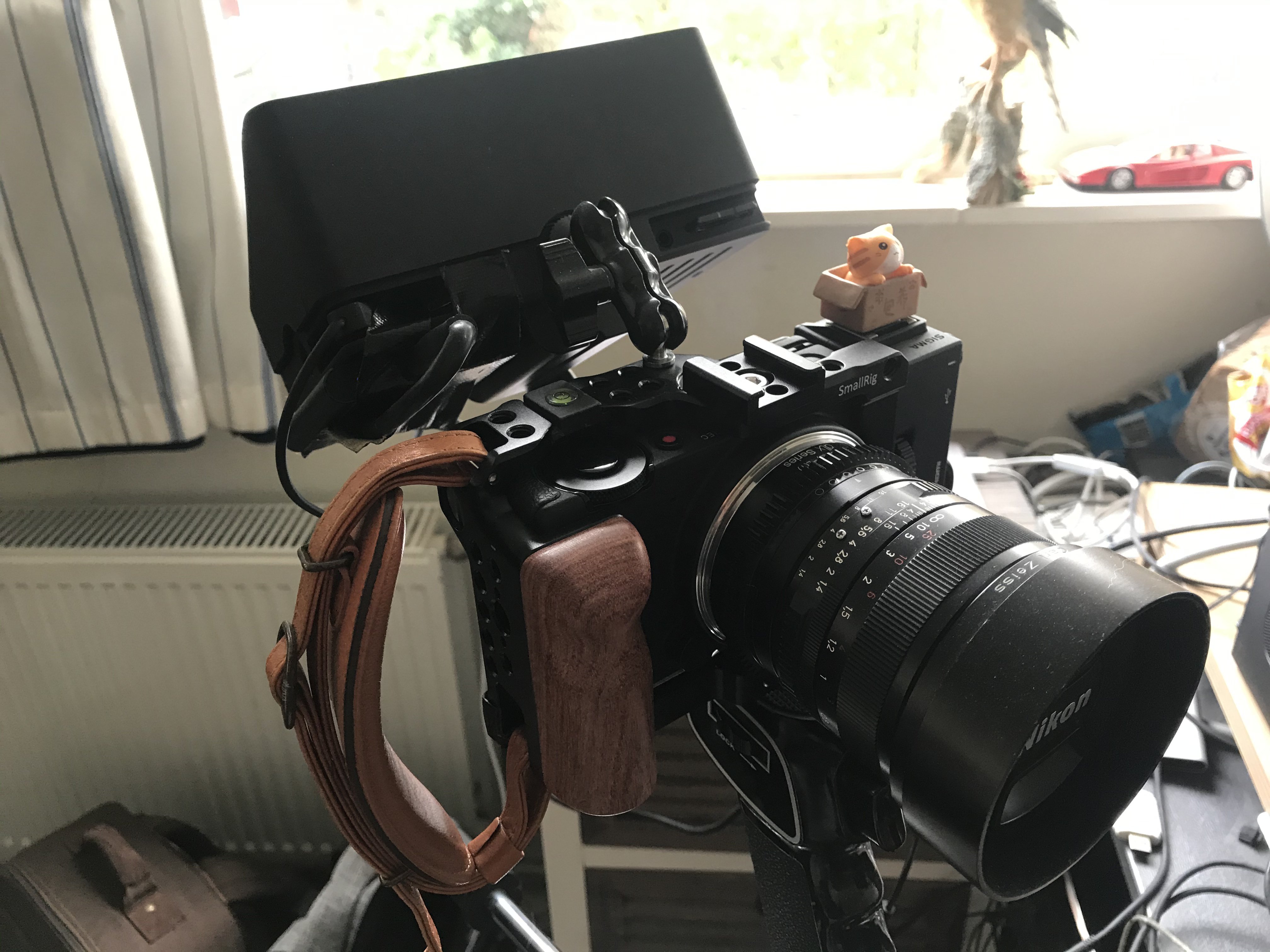

Lars Steenhoff Posted April 12, 2020 Share Posted April 12, 2020 Yes its the small rig cage, I'm happy with it I allows me to connect to the smallrig focus oled. Vintage Jimothy and Adept 2 Link to comment Share on other sites More sharing options...

Noli Posted April 13, 2020 Share Posted April 13, 2020 On 4/12/2020 at 4:31 PM, rawshooter said: This is interesting, because on your copy it says 7.4 volts while the specification for both the original Panasonic BLC12 and the Sigma BP-51 is 8.4 volts. If it's possible to power the camera with only 7.4 volts, then you could likely also connect the dummy batteries to Sony NP-F batteries (which have 7.2 volts) - and this would open up wholly new possibilities for using the fp on long shooting gigs. But I leave it here, because at this point all this is speculative and we need to see whether and how it works in real life. P.S.: Is this a SmallRig cage in the background? Does it work well for you on your fp? I'm using a Baxxtar NP-F970 and it definitly works. So far I only got the battery and no charger, once that arrives I will test for how long it will run, continuosly recording. Link to comment Share on other sites More sharing options...

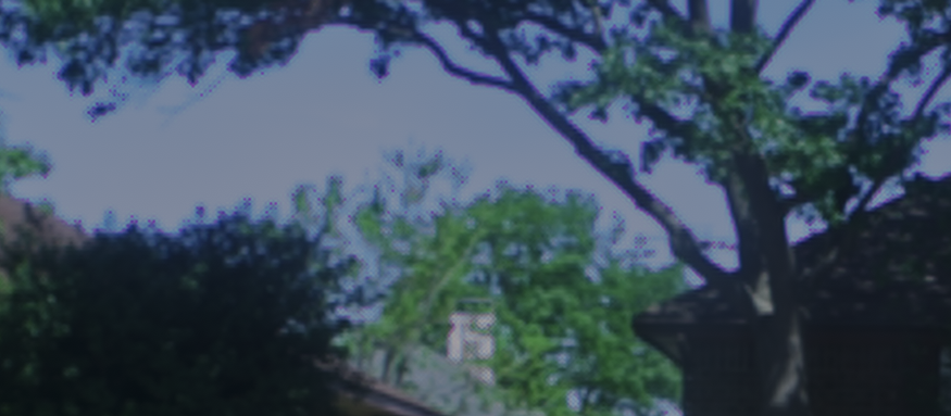

redepicguy Posted April 13, 2020 Share Posted April 13, 2020 Anyone seeing these weird purple artifacts around overexposure points? It doesn't look to be CA..it's something else entirely. This was shot around F8 12-bit CDNG 1080p. Link to comment Share on other sites More sharing options...
Administrators Andrew Reid Posted April 13, 2020 Author Administrators Share Posted April 13, 2020 Is it coronavirus? BenEricson 1 Link to comment Share on other sites More sharing options...
redepicguy Posted April 13, 2020 Share Posted April 13, 2020 12 minutes ago, Andrew Reid said: Is it coronavirus? I think so..it's gone savage! Link to comment Share on other sites More sharing options...
