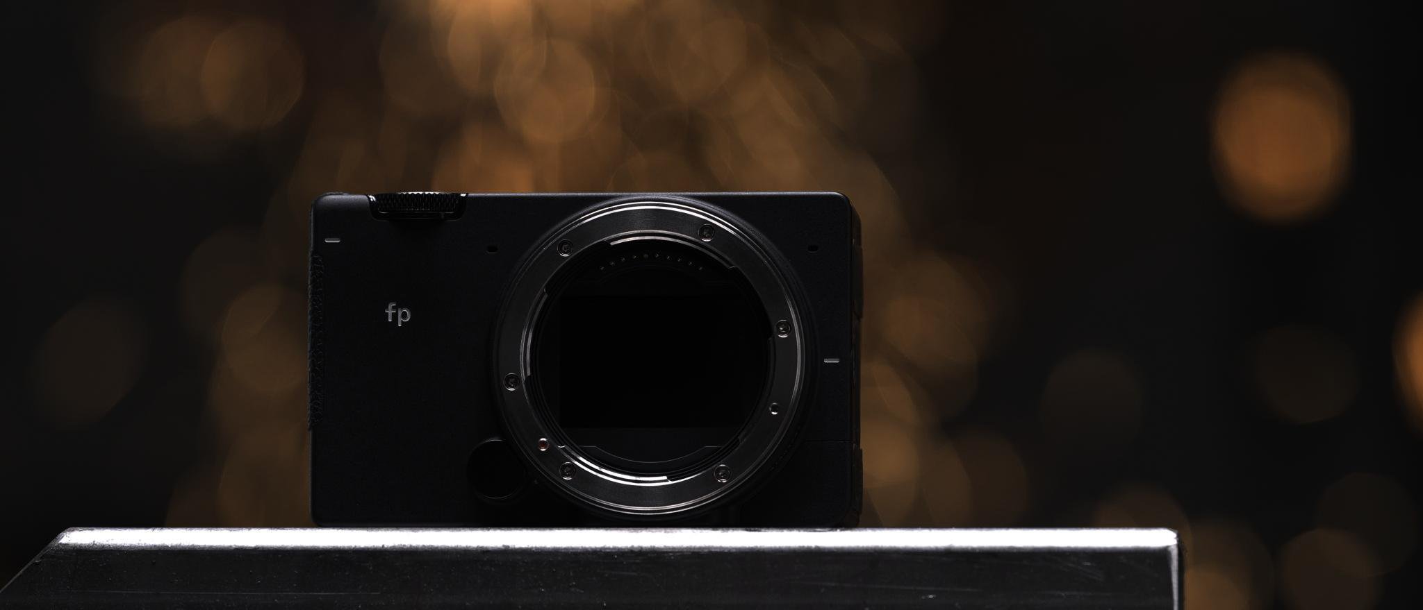

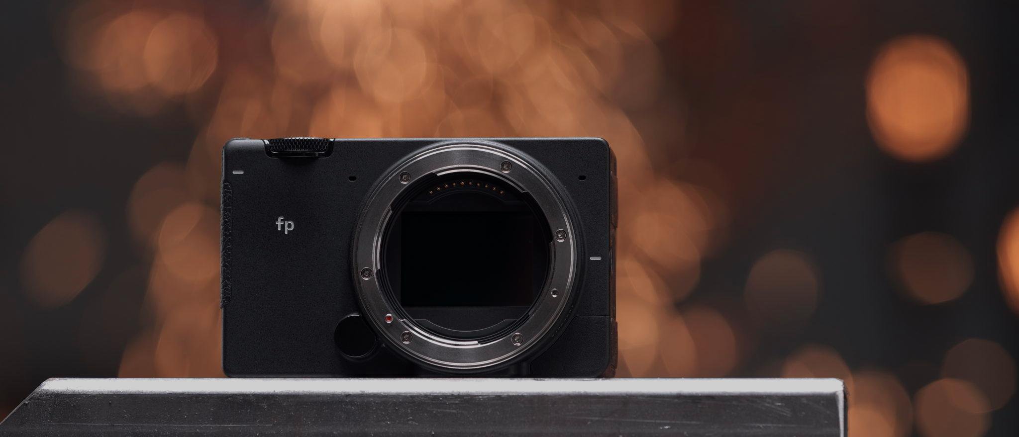

Llaasseerr Posted July 19, 2020 Share Posted July 19, 2020 Without details from Sigma, here's a quick look at perhaps making sense of footage shot with the new "none" profile, and how they could be used for internal raw monitoring. I grabbed the images from this page: https://blog.sigmaphoto.com/2020/the-sigma-fp-evolves-firmware-2-0-for-the-cinema-crowd/ I assumed they are linear 1.0 in a rec2020 type of gamut, but that they have had a rec709 curve applied. So I took them into Nuke in an ACES color managed script, and I inverted the rec709 curve so that they are again linear 1.0 gamma. I then transformed the rec2020 gamut to ACES. The default ACES rrt/odt film look is applied, and I rendered out jpegs in sRGB, which I'm attaching here. Of course the highlights are completely clipped, but the midtones can be useful for accurately exposing with a grey card. I'm not sure if they will display correctly in the browser window, but they look "correct" in Nuke. EDIT: they look too dark in a Chomium-based browser compared to Nuke, but it may be because my screen is currently set to P3D65. YMMV. mercer 1 Link to comment Share on other sites More sharing options...
Llaasseerr Posted July 19, 2020 Share Posted July 19, 2020 21 minutes ago, Llaasseerr said: EDIT: they look too dark in a Chomium-based browser compared to Nuke, but it may be because my screen is currently set to P3D65. YMMV. My bad, I forgot to apply the sRGB output transform to the two darker images. I wasn't able to edit the original post. Here they are uploaded again: mercer and meudig 2 Link to comment Share on other sites More sharing options...
