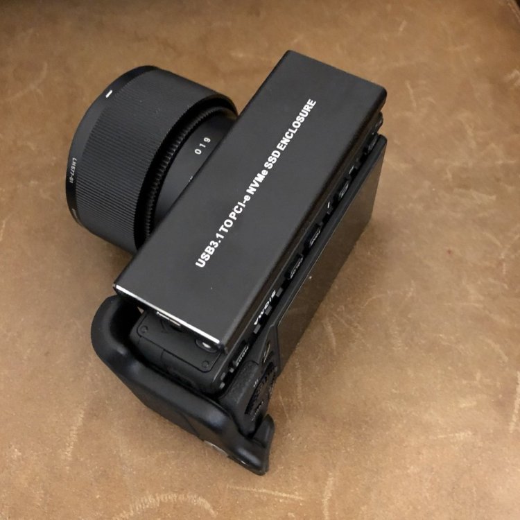

anton.zimin@gmail.com Posted January 10, 2021 Share Posted January 10, 2021 On 12/11/2019 at 6:34 PM, Brian Williams said: Btw, I got a slim SSD enclosure along with a Sabrent 1TB NVMe SSD and it works great, just need to figure out how to attach it to the bottom now. Which enclosure are you using? Link to comment Share on other sites More sharing options...

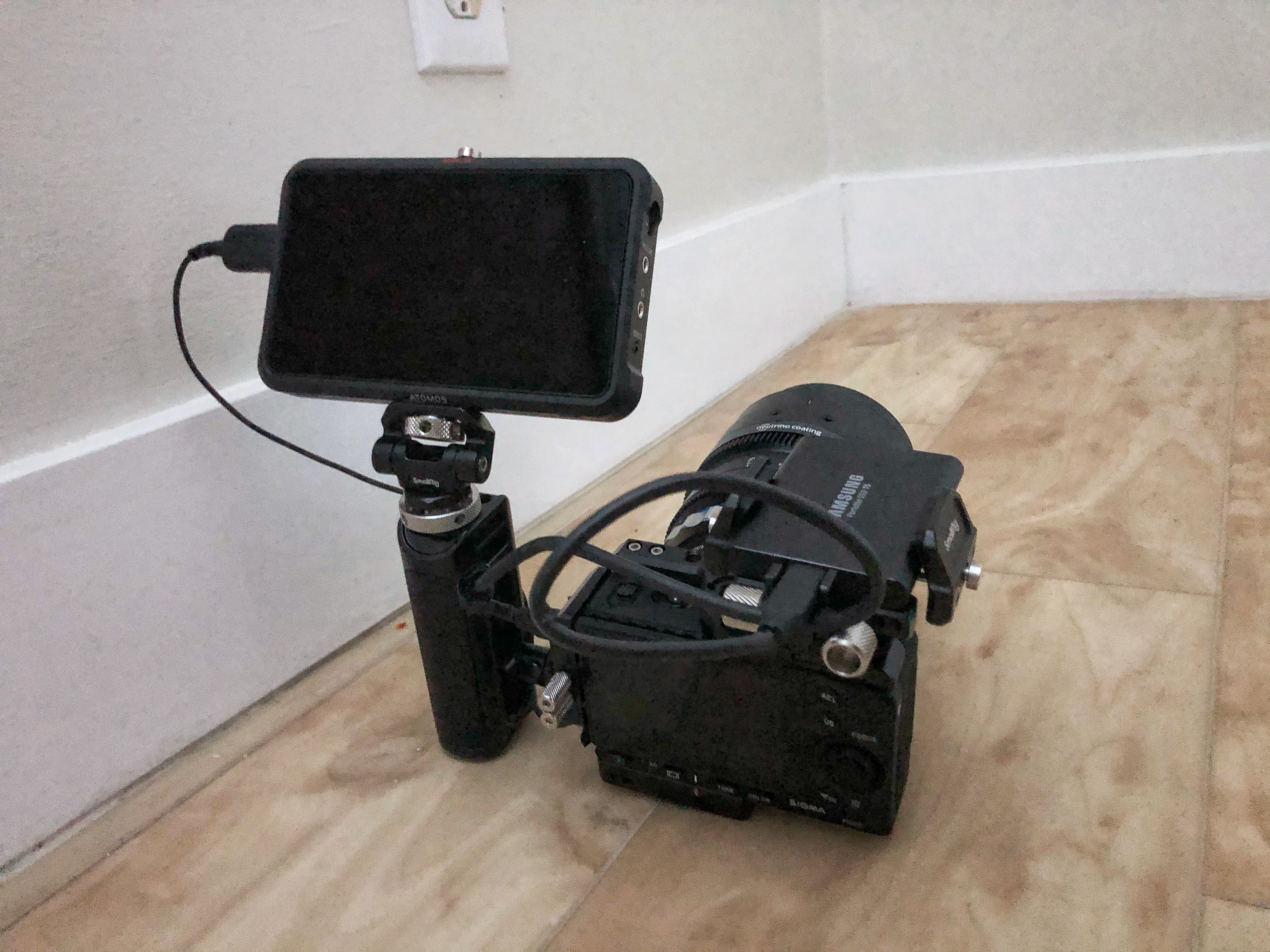

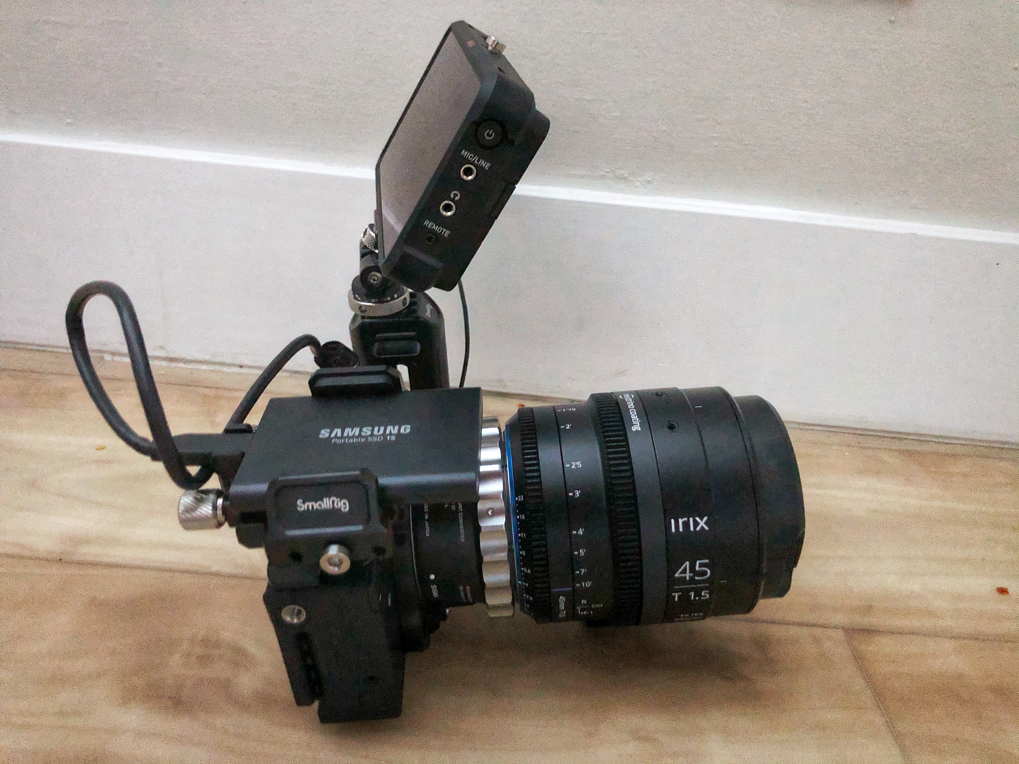

Alt Shoo Posted February 16, 2021 Share Posted February 16, 2021 Here is my preliminary setup. This little setup here is amazingly powerful. Thomas Hill, billdoubleu and josdr 3 Link to comment Share on other sites More sharing options...
