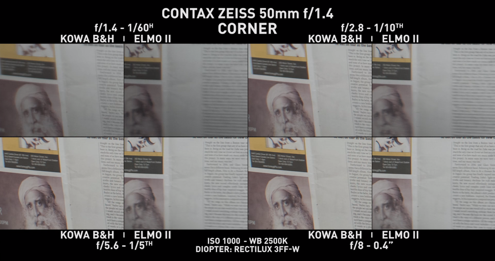

ken Posted September 25, 2019 Share Posted September 25, 2019 4 hours ago, davidivinci said: Thank you guys for the answers! I didn't start searching for kowa or other lenses because I've read that you can't shoot under f/5.6 for example. Low light performance is important for me, so I excluded kowa, sankor(am I wrong?) & SLR. As I understand, there are important differences in golden ISCO lenses with Ultra Star or Blue Star. I don't think so. Here are samples of Elmoscope II (=16H)with Canon 6D, 85mm f1.8 lens @f1.8. Link to comment Share on other sites More sharing options...
davidivinci Posted September 25, 2019 Author Share Posted September 25, 2019 Ok, thats interesting. It definitely has more character than an ISCO lense. Link to comment Share on other sites More sharing options...
ken Posted September 25, 2019 Share Posted September 25, 2019 I am pretty sure Kowa B&H, 16H, 8Z and Elmoscope II (there are other re-branded name too) have the same optical glasses. Only difference are rear diameter, distance marks(only Elmo use metric system, so I keep it) and coatings, actually two color amount them. Except 8Z, I owned all other three before. I don't know why B&H's price is higher. So I sold it. Its rear diameter is bigger, so unable to mount closer to some lens. I also like metric system. Link to comment Share on other sites More sharing options...
Rudolf Posted September 26, 2019 Share Posted September 26, 2019 Elmo II is top notch. Elmo built some very advanced projectors and good cameras. They were and are still used by pros. Tito just had a poor example for his test. For the looke I like Moeller even more but sadly the rear is smaller. Moeller is king! Had them all and sold them. I am an idiot... ken 1 Link to comment Share on other sites More sharing options...

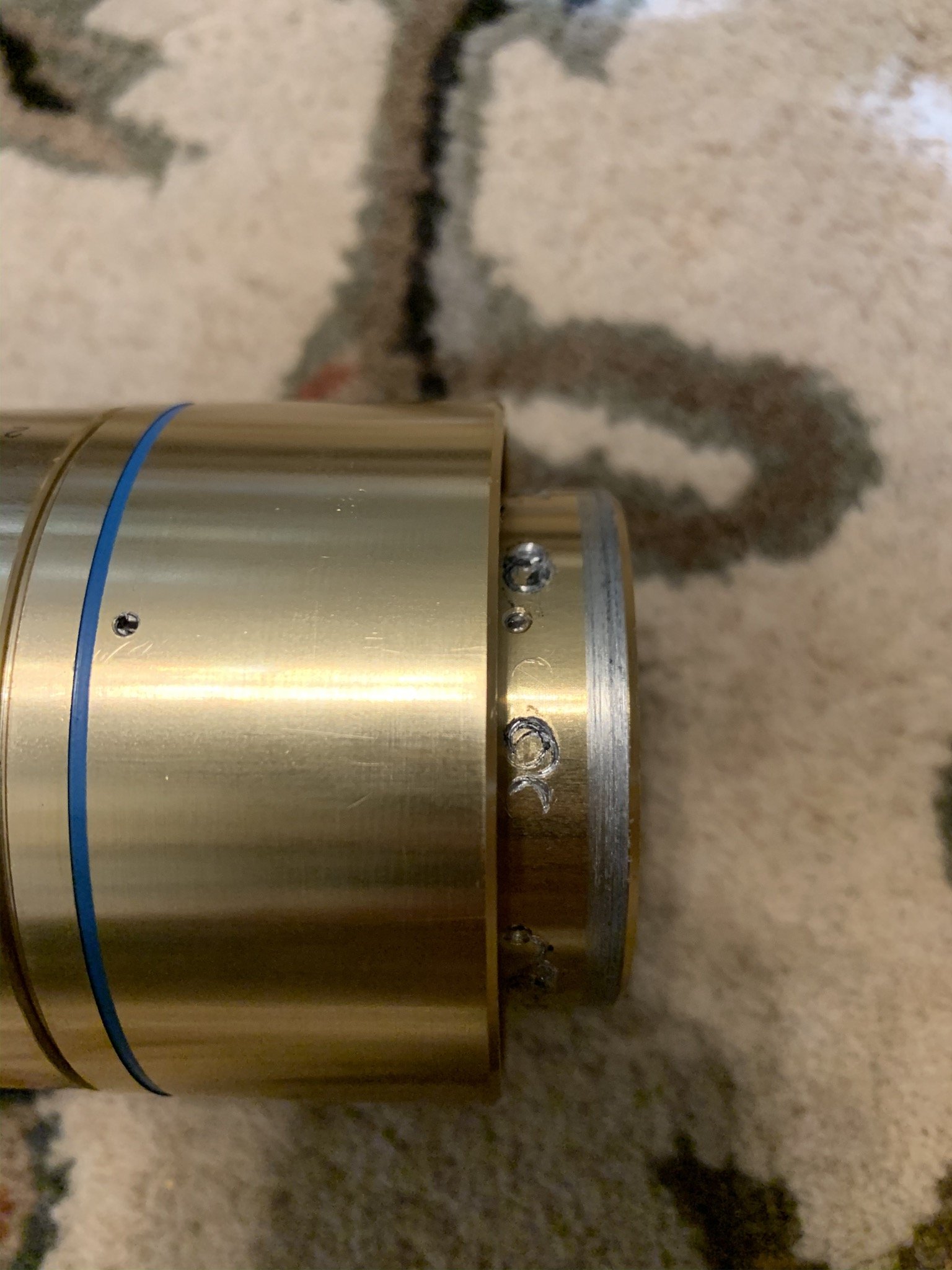

PeterA Posted October 9, 2019 Share Posted October 9, 2019 Hi guys. I'm new to anamorphic & would like to ask for your opinion about an Isco Ultrastar light gold (1st version) that I'm buying. According to the buyer, the focus ring does not turn & is fixed this way. It is set to infinity. Is there a version of this lens that is locked? Is this normal? Also, the rear end of the lens body has metal indentations due to the screw of the clamp digging in to the metal. If that is the case, is this something that will stop you from buying the lens. I'd really appreciate your thoughts on this. Thank you. Link to comment Share on other sites More sharing options...
ken Posted October 9, 2019 Share Posted October 9, 2019 10 hours ago, PeterA said: Hi guys. I'm new to anamorphic & would like to ask for your opinion about an Isco Ultrastar light gold (1st version) that I'm buying. According to the buyer, the focus ring does not turn & is fixed this way. It is set to infinity. Is there a version of this lens that is locked? Is this normal? Also, the rear end of the lens body has metal indentations due to the screw of the clamp digging in to the metal. If that is the case, is this something that will stop you from buying the lens. I'd really appreciate your thoughts on this. Thank you. Post a photo to have a look. Link to comment Share on other sites More sharing options...
PeterA Posted October 13, 2019 Share Posted October 13, 2019 Here's the lens and the metal indentations. Link to comment Share on other sites More sharing options...
Caleb Genheimer Posted October 13, 2019 Share Posted October 13, 2019 If the rear glass is not cracked I’d say those marks are fine. In the future I’d advise using a rear clamp that has plastic set screws though so as to not over exert force on the rear, or you’ll dig into it more, and possibly crack the glass inside too. Not sure if there are infinity only versions, but I doubt it. Most of these lenses have a way to lock the focus (since once installed in a theater for projection you wouldn’t want them to accidentally go out of focus.) It might be that the locking mechanism is seized. Not a big deal if it is truly at infinity, because for any practical purpose, you need a variable diopter to focus anamorphic projection adapter setups. With such setups, you put both the prime and anamorphic at infinity and leave them there. Link to comment Share on other sites More sharing options...
