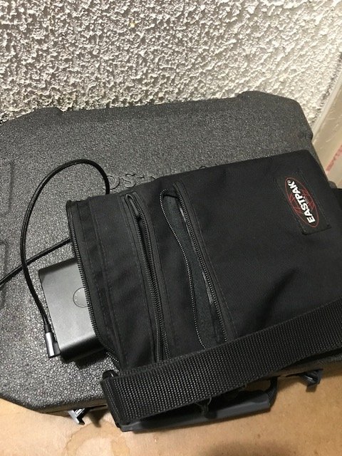

BrunoCH Posted October 18, 2019 Share Posted October 18, 2019 On 10/16/2019 at 2:49 AM, EphraimP said: I appreciated your warning this weekend. I tested it out and didn't lose any clips, so I used it on my weekend shoot. Definitely didn't lose footage, but it didn't keep my X-T3 powered for the whole shoot so I had to switch to my handheld rig with a v-mount battery. I do have an Anker power bank I've used with it before. Seems kind of clunky to gaff it to the gimbal though. Good news if you haven't had a problem with this technique. Now I have the rec triger fuji cable and I can't anyway power my XT3 with my Ronin. But I use a long 2m USB-C cable and I gaff a loop about 40-50cm on the SC's handle and I wear my anker in my pocket or in a small shoulder bag. Works fine and lightweight! Link to comment Share on other sites More sharing options...
