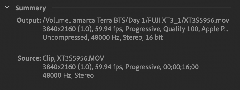

chadandreo Posted October 18, 2019 Share Posted October 18, 2019 I am using Adobe Media Encoder to transcode H.265 Fuji XT3 files to ProRes HQ and the audio is off on the transcoded footage. In Media Encoder, I selected the ProRes 422 HQ preset and selected match source. Also, most of the footage was shot 59.94. Can anyone help me to resolve this issue? Link to comment Share on other sites More sharing options...

chadandreo Posted October 18, 2019 Author Share Posted October 18, 2019 13 minutes ago, BenEricson said: Have you made sure you’re exporting to 59.94 and not 60? That will cause drift. I haven’t heard of it in a while, but the drive speed could potentially slow it down. Maybe try going to 422 or LT and see if you have the same issue? Just to trouble shoot. Is it happening on all of the clips? Ive attached a screen grab of the settings I was using. All of the clips that were transcoded had the same issue. I havent tried LT or 422 yet, but I will give that a shot. Link to comment Share on other sites More sharing options...
