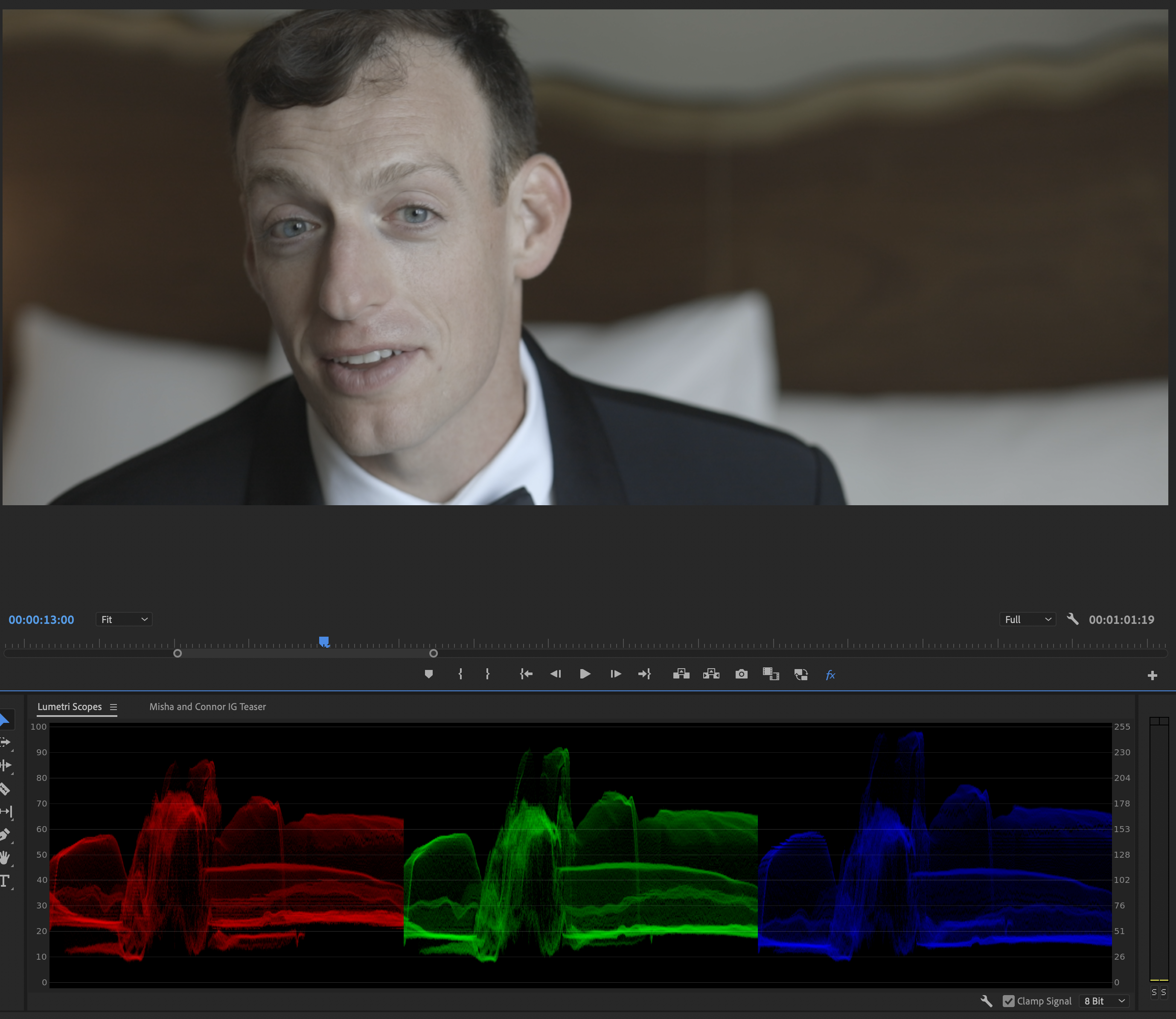

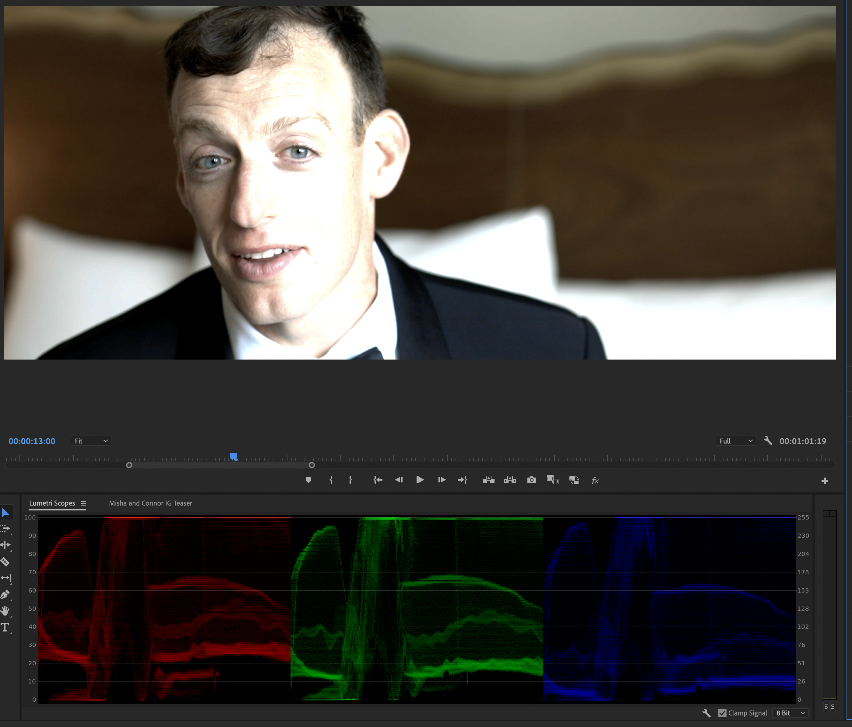

Also, I just added a couple of screen-grabs with scopes.

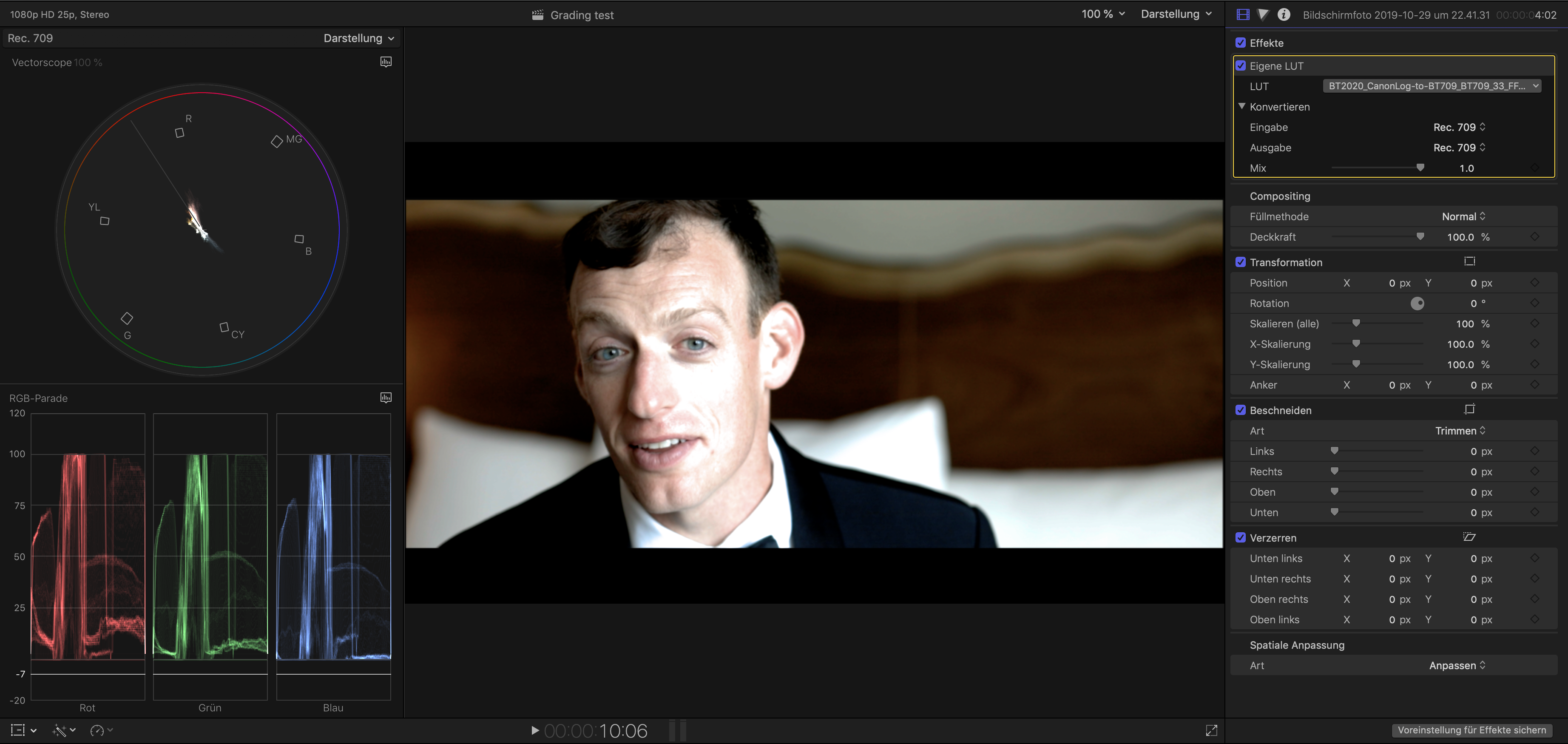

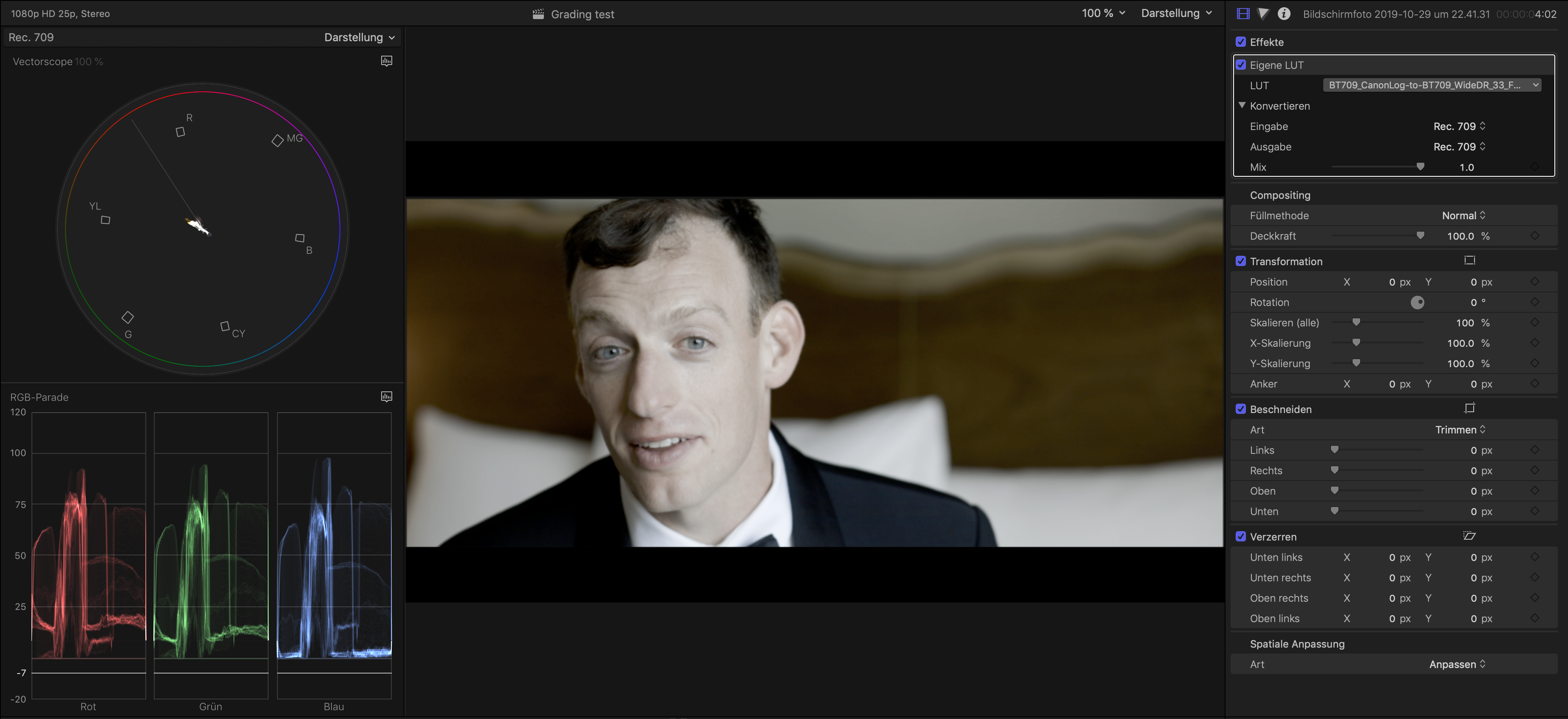

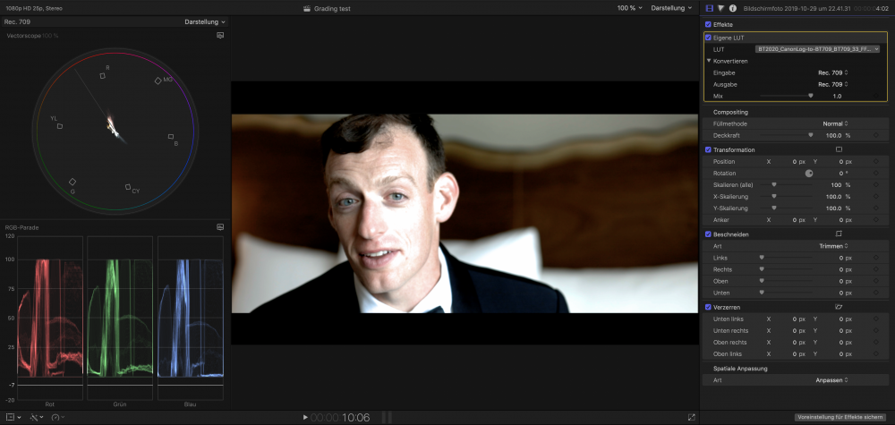

1318896337_Bildschirmfoto2019-10-29um22_45_24.thumb.png.64750032c891907c158a871043a1ac90.png
This is what a Screenshot of your Grab with the lut BT709_CanonLog-toBT709_WidDR_33_FN_Ver.1.1 looks like in FCPX. Not great, but neither blown out. And it's just a screen grab from a screen grab... So I assume the lut should look better on the original video. You find it in the official lut-package from the C200 support page (i assume it's the same in other cameras support pages?): folder path: 3dlut -> 33grid-3dlut -> full-to-narrow-range
That specific lut is attached...
I tried a 2020-to-709 lut too and it gives the blown out highlights. So maybe your premiere project thinks your original media is in 2020 color space if this happens with a 709to709 lut? I'm not too familiar with the Adobe suite so can't help you with how to possibly fix that...
 196494731_Bildschirmfoto2019-10-29um22_50_04.thumb.png.9475a25d42f7812d49d51dd1da6dbb6e.png
BT709_CanonLog-to-BT709_WideDR_33_FN_Ver.1.1.cube

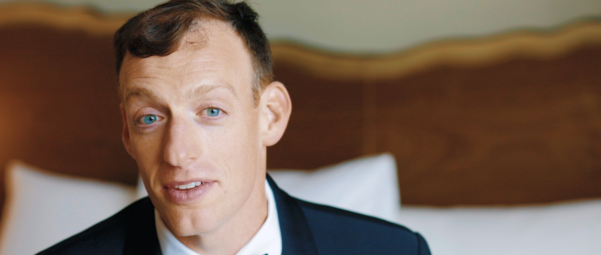

This is the final result I got using PP Lumetri. I think it looks good, but I am not 100% happy with it due the amount of artifacts and noise at base iso, but I was able to correct those issues using Neat Noise.
