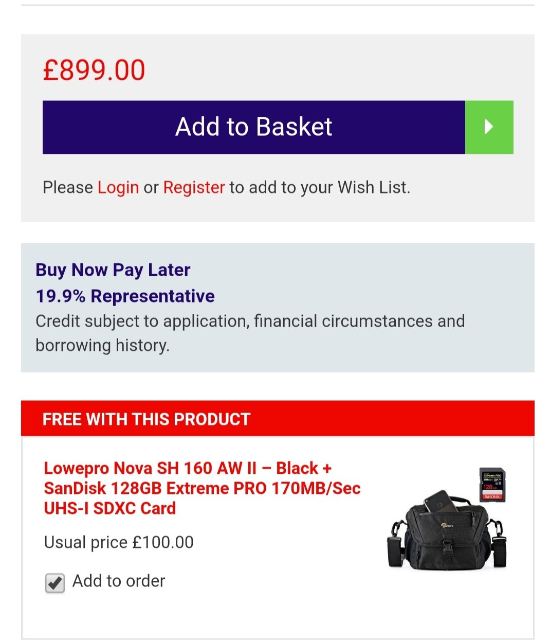

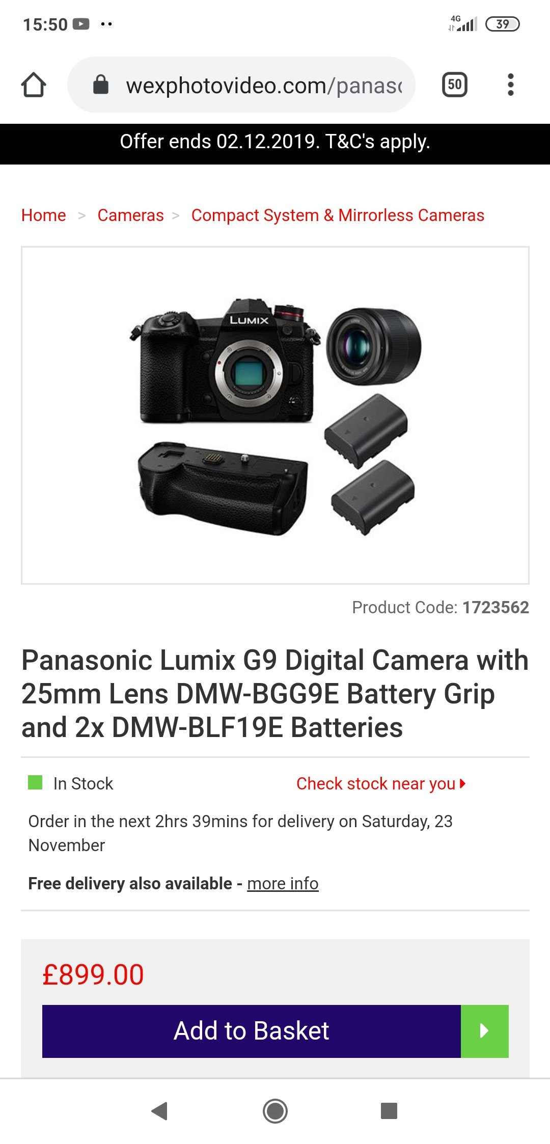

AlexTrinder96 Posted November 22, 2019 Share Posted November 22, 2019 Not sure if this has already been posted... Great deal ? https://www.wexphotovideo.com/panasonic-lumix-g9-digital-camera-with-25mm-lens-dmw-bgg9e-battery-grip-and-2x-dmw-blf19-1723562/ Link to comment Share on other sites More sharing options...
