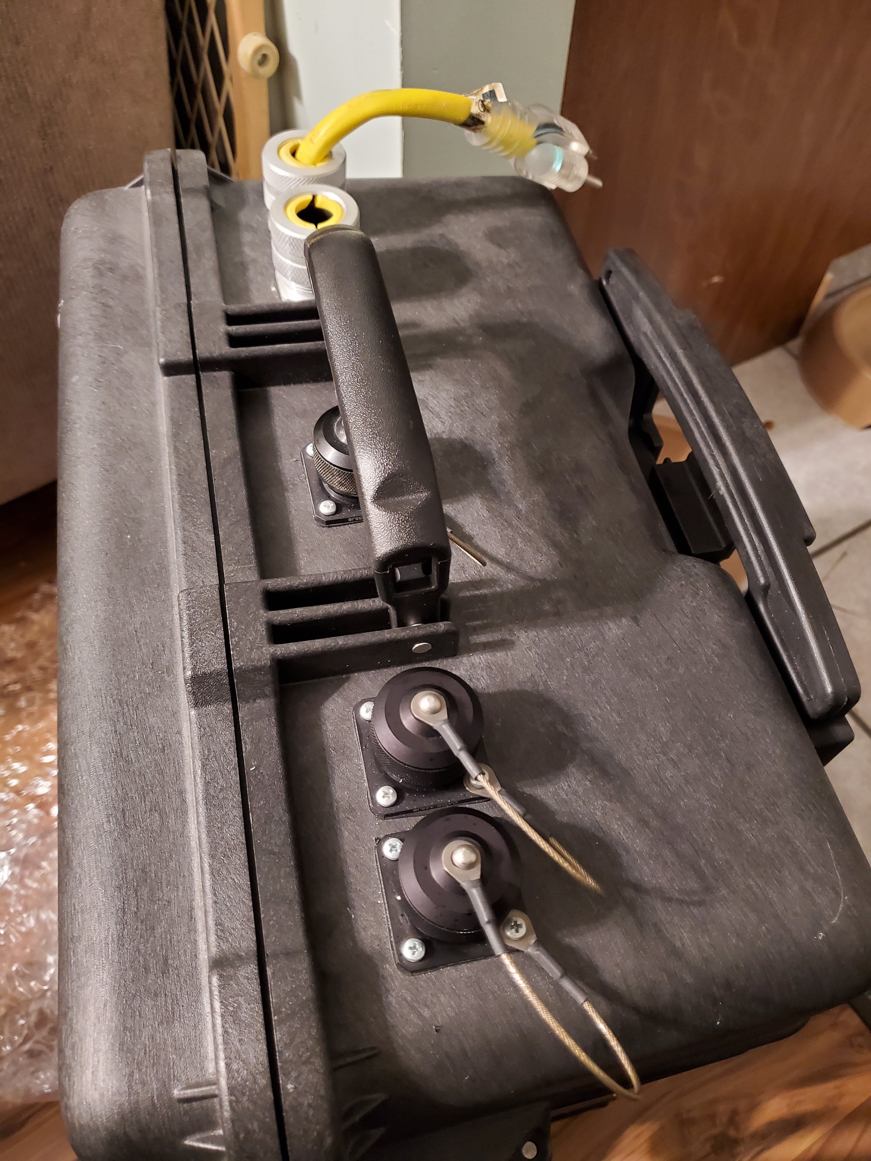

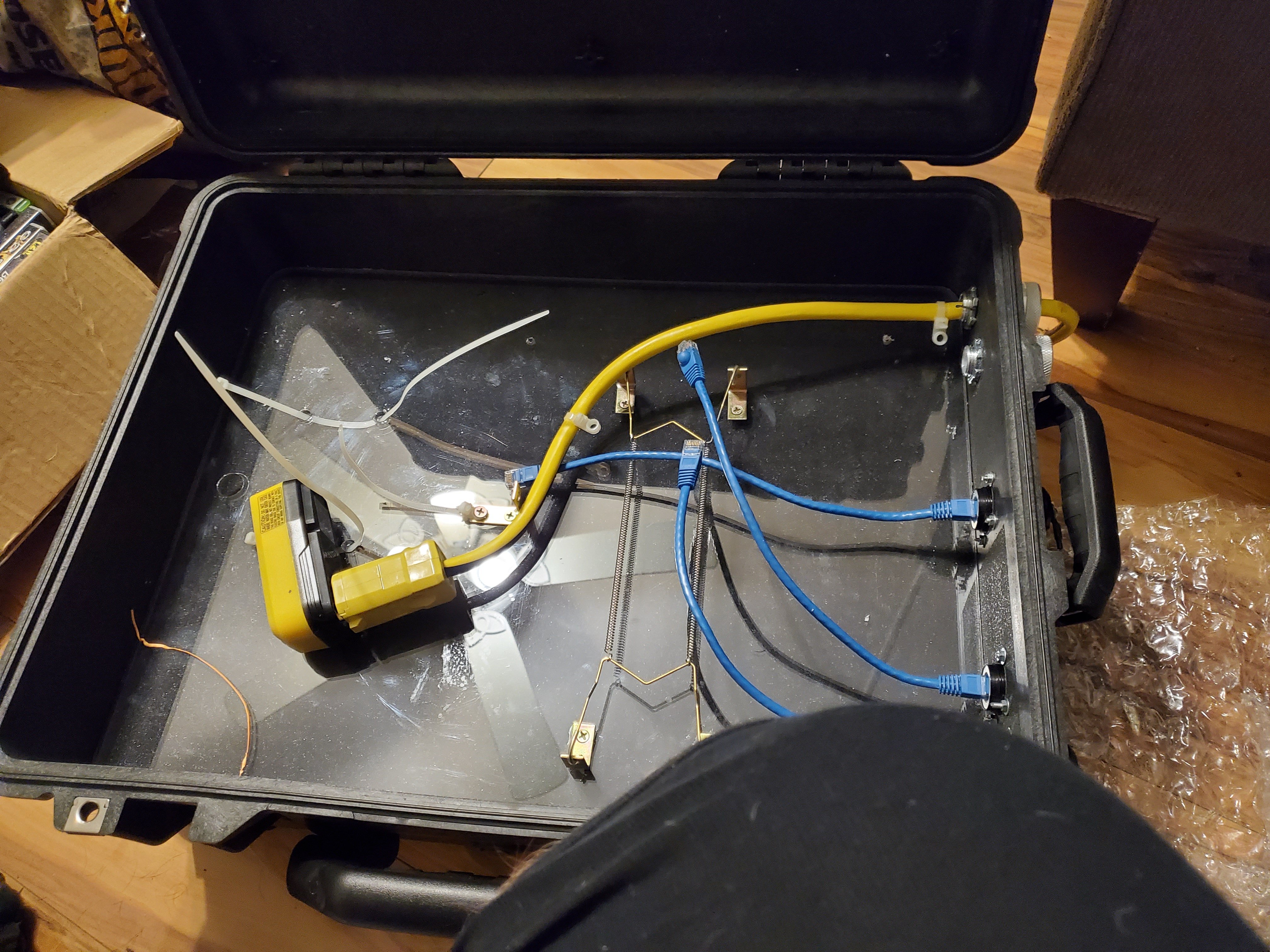

newfoundmass Posted November 22, 2019 Share Posted November 22, 2019 So I picked up a 1560 Pelican case for dirt cheap after having used an off brand version. It was used to store computers, but I'd like to use it to store video equipment. It's in really good condition, the problem is the case has been modified with five holes, two for power cables and three for ethernet cables. Does anyone have any experience with patching holes in Pelican cases? I'm not too concerned about making them submerge proof, but I'd like to make them as water resistant as possible. Any ideas / suggestions would be appreciated! Link to comment Share on other sites More sharing options...

mkabi Posted November 29, 2019 Share Posted November 29, 2019 I would actually keep it as is.... remove the wires and find screw on caps on both sides. Link to comment Share on other sites More sharing options...
