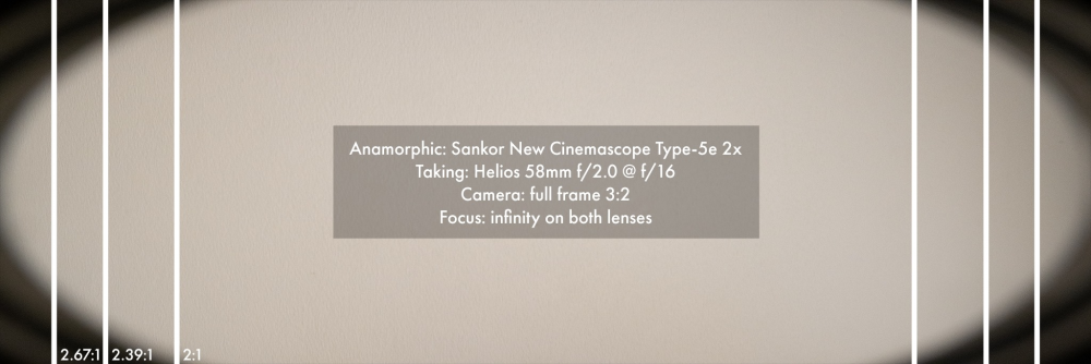

mercer Posted December 12, 2019 Author Share Posted December 12, 2019 On 12/11/2019 at 9:42 PM, Timotheus said: How important is (wide) coverage for you? 55mm on fullframe with this lens is hard to imagine, aps-c or smaller would make more sense. In general, chubby and short with big elements provide widest coverage. That's why the 8z variants (16H, B&H, Sankor Anamoprime) are so popular (mind the crazy edge distortion though). He is talking about a smaller lens (probably 16S or 16A). Expand Sure I'd like the widest coverage possible but that wasn't necessarily the point of my question. I just liked the look of the frame, so I was curious if better trained anamorphic eyes and more knowledgeable members could deduce what lens he was using. On 12/12/2019 at 1:11 PM, Julien416 said: The largest you can have in full frame with projection lenses is, according to my findings, around 50mm with a Kowa 16h/8z. It will have funky distortions on the sides and will vignette heavily. 55/58mm would probably be the safest width. But anyhow, a single focus solution will be limited to around 75mm in full frame with the rectilux, and probably a few more mm with the FVD 16. Use Tito's excellent anamorphic calculator, it's a time saver. Expand Okay, thanks. So much information in such a short time is getting muddled in my spherical, full frame brain. Although the Kowa 16-... variants are a lot cheaper, I keep going back to the Kowa B&H/16H/8z/Elmoscope II scopes. Based on eBay prices, the 16 lenses aren't really that cheap, so I may just save my money and search for a B&H/16H/8z/Elmoscope. In your opinion what is a good price for a very good to mint condition copy of: Kowa 16a, 16d, 16s Kowa B&H Kowa 16H/8z Elmoscope II Thanks again, I appreciate your guys' help! On 12/12/2019 at 4:46 PM, heart0less said: @mercer This sample shot was taken with Sankor Type-5E, which is believed to share the same optics as Kowa 16-H / B&H, etc - meaning: you can't go any wider. No single focus diopter. Both lenses (Helios and Sankor) set to infinity. Courtesy of Daniel Cai: My dear god, these stills look fantastic.. The post you linked looks more like 55 mm on an APS-C sensor to me. Expand Thanks, I haven't heard of the Sankor before... I assume that's the same one Timotheus mentioned? What are those frames from? Idk, maybe the frame I posted is from an aps-c sensor, I just based my assumption by his surprise of coverage. I assumed he wouldn't have been as surprised if it was shot on a 1.5x crop camera. Link to comment Share on other sites More sharing options...

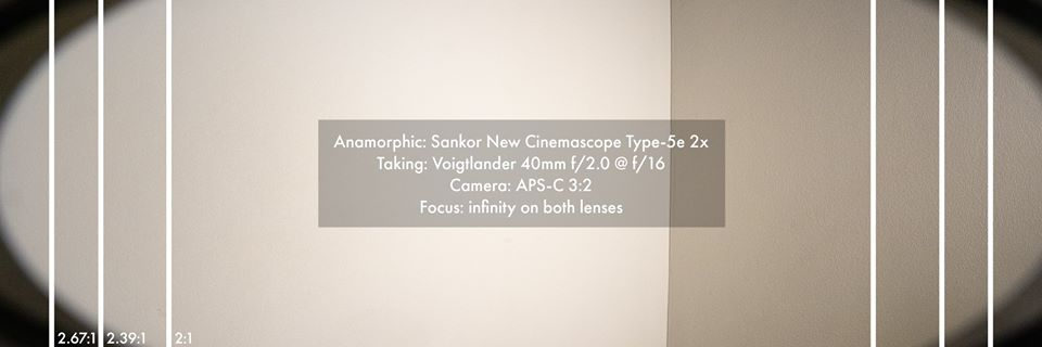

heart0less Posted December 12, 2019 Share Posted December 12, 2019 On 12/12/2019 at 6:54 PM, mercer said: I assume that's the same one Timotheus mentioned? Expand I think it's safe to assume that it's the one, though I'm not 100% sure. Never heard of 'anamoprime' before. On 12/12/2019 at 6:54 PM, mercer said: What are those frames from? Expand Just some sample photos from Daniel Cai taken with the abovementioned Sankor. He shared them in his sale post on Anamorphic Shooters. His asking price was 475$ and he listed it only today, but I suppose it's already sold. On 12/12/2019 at 6:54 PM, mercer said: I assumed he wouldn't have been as surprised if it was shot on a 1.5x crop camera. Expand 55 mm on APS-C camera is still quite good result, if we're talking about full 3:2 coverage. I, myself, am not able to achieve that. On 12/12/2019 at 7:31 PM, Julien416 said: What I mean is, don't necessarly go for the perfect lens, otherwise you might end up paying a premium price. A few scratch really do not impact image quality up to a certain point. Expand +1 I agree completely. mercer 1 Link to comment Share on other sites More sharing options...
