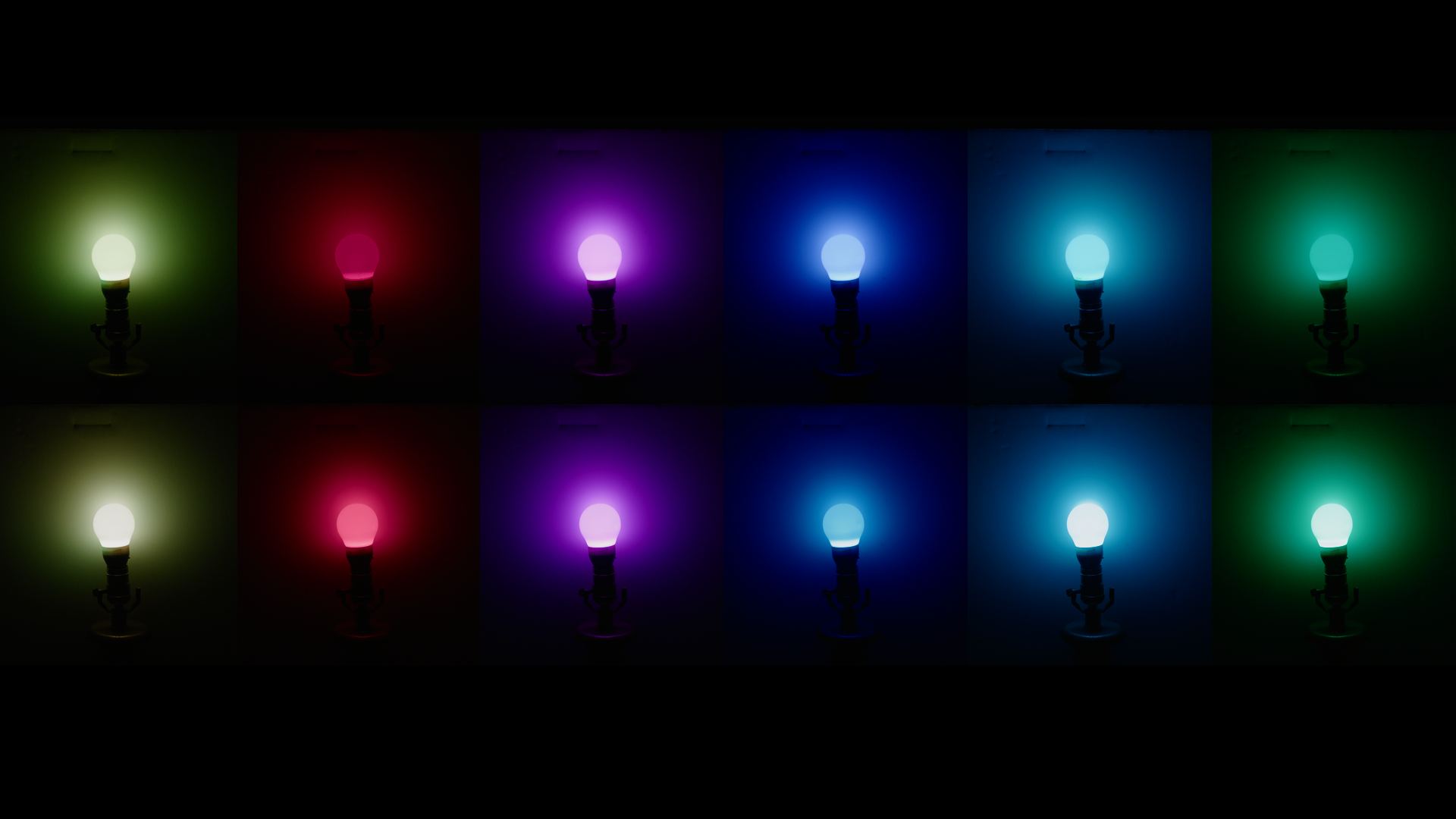

Sage Posted January 1, 2020 Author Share Posted January 1, 2020 Its a party bulb I picked up from the local hardware store. It has a hue rotate mode that, paired with a gradient, is completely unforgiving Link to comment Share on other sites More sharing options...

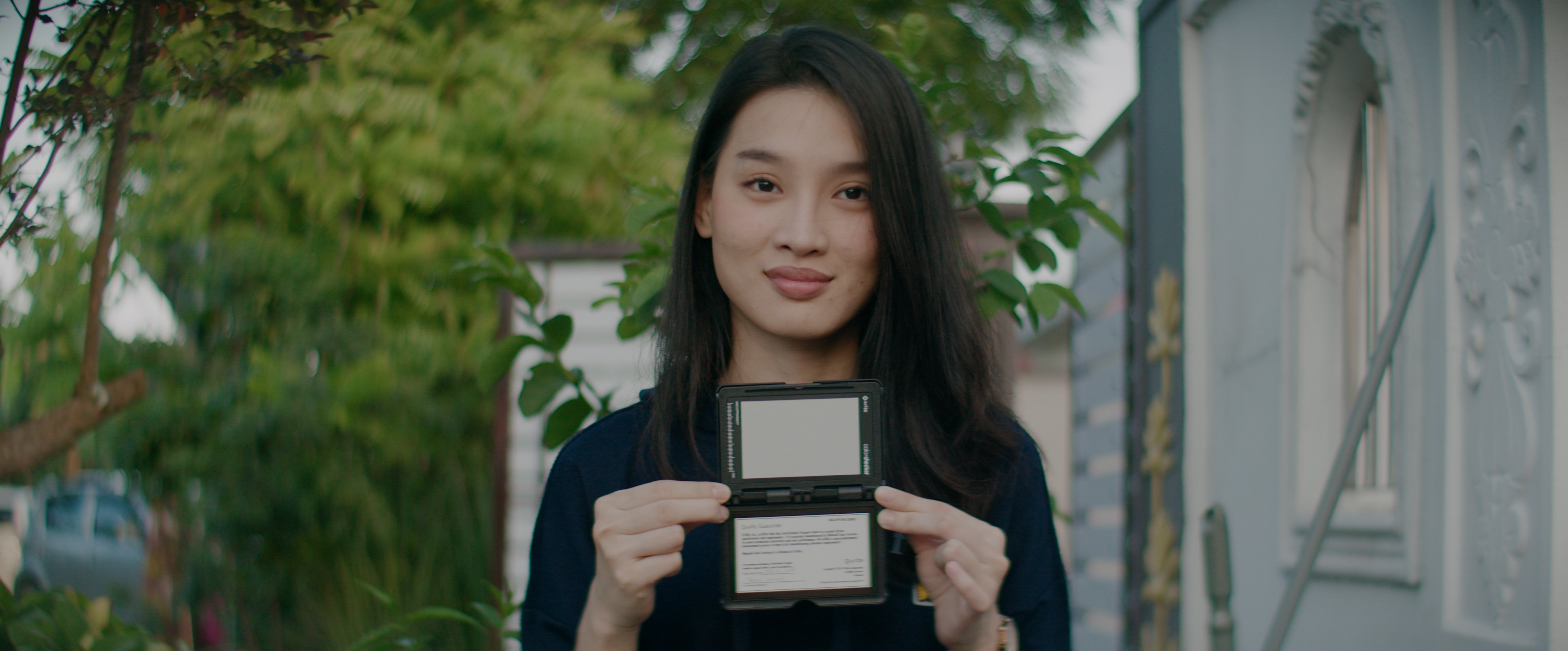

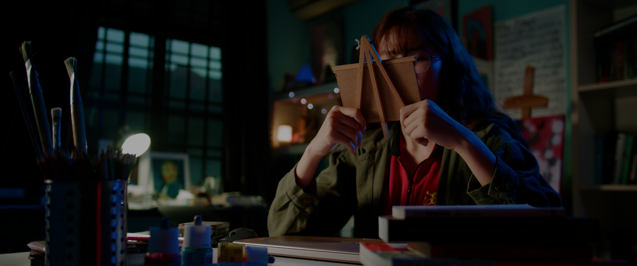

jackch2n Posted January 2, 2020 Share Posted January 2, 2020 4 hours ago, RCV said: This looks great. looking forward to seeing the video. What lens is this? Looks incredible. Lighting and framinng. looking forward to the video. Im sure John Brawley is taking notice. BM should reach out to you to collaborate Thank you! The lens I used for the test shot with the girl holding the ColorChecker is Metabones 0.71x , YongNuo 50mm 1.8 and a Sankor 16D Anamorphic projector lens. The shot of the girl holding a picture frame in a room is from a test shot of my school assignment. The adjustments and the conversion I used is -1 Stop Pre Exp + P4Ka Tungsten (Main) + ABL 2 + Color Wheel Slider (Midtones and Highlights) to conform to cinema luminance for the skintone and scene context needed. Make sure to white balance to the key light and the skintone falls on the skintone line of the Vectorscope. RCV and heart0less 2 Link to comment Share on other sites More sharing options...
jackch2n Posted January 2, 2020 Share Posted January 2, 2020 1 hour ago, jackch2n said: Thank you! The lens I used for the test shot with the girl holding the ColorChecker is Metabones 0.71x , YongNuo 50mm 1.8 and a Sankor 16D Anamorphic projector lens. The shot of the girl holding a picture frame in a room is from a test shot of my school assignment. The adjustments and the conversion I used is -1 Stop Pre Exp + P4Ka Tungsten (Main) + ABL 2 + Color Wheel Slider (Midtones and Highlights) to conform to cinema luminance for the skintone and scene context needed. Make sure to white balance to the key light and the skintone falls on the skintone line of the Vectorscope. The guides are included in the PDF guide provided. Sage and RCV 1 1 Link to comment Share on other sites More sharing options...
