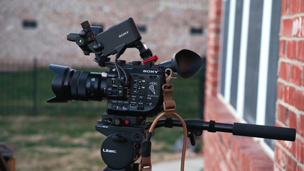

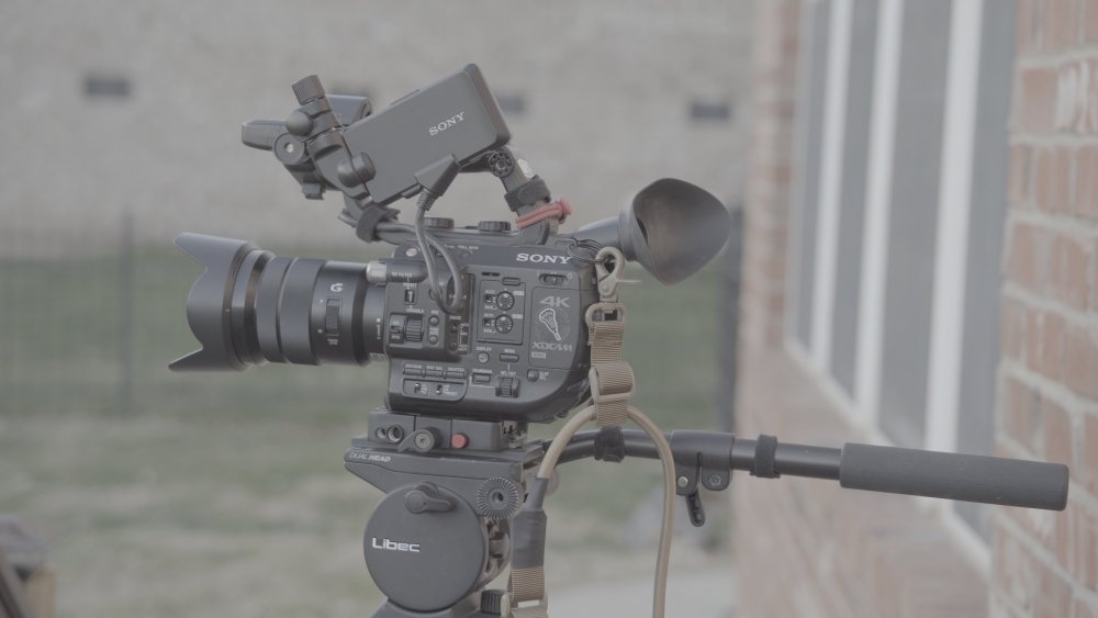

Mako Sports Posted December 9, 2019 Share Posted December 9, 2019 Was able to shoot some test shots today. Exposed at 85 ire this time. Once again I shot Slog 2 - S gamut3.cine in camera. Used color space transform in Davinci Resolve Studio. Uploaded both Luts also. Image 1. Color space transform conversion from Slog 2 to Slog 3 Image 2. XDCAM user Sony Venice - Slog 3 rec 709 look/lut Image 3. XDCAM user creative lut. (Fuji SL2 1 Stop over) ACFujish1-SL2-1OVER.cube AC-SL3-to-709-2OVER.cube Link to comment Share on other sites More sharing options...
Mark Romero 2 Posted December 9, 2019 Share Posted December 9, 2019 40 minutes ago, Mako Sports said: Was able to shoot some test shots today. Exposed at 85 ire this time. Once again I shot Slog 2 - S gamut3.cine in camera. Used color space transform in Davinci Resolve Studio. Uploaded both Luts also. Image 1. Color space transform conversion from Slog 2 to Slog 3 Image 2. XDCAM user Sony Venice - Slog 3 rec 709 look/lut Image 3. XDCAM user creative lut. (Fuji SL2 1 Stop over) Thanks for posting the photos and the workflow. Is there any benefit to shooting in SLOG 2 and then using CST to transform to SLOG 3? ( As opposed to just shooting in SLOG 3 to begin with?) Link to comment Share on other sites More sharing options...
Dave Del Real Posted December 9, 2019 Author Share Posted December 9, 2019 49 minutes ago, Mako Sports said: Was able to shoot some test shots today. Exposed at 85 ire this time. Once again I shot Slog 2 - S gamut3.cine in camera. Used color space transform in Davinci Resolve Studio. Uploaded both Luts also. Image 1. Color space transform conversion from Slog 2 to Slog 3 Image 2. XDCAM user Sony Venice - Slog 3 rec 709 look/lut Image 3. XDCAM user creative lut. (Fuji SL2 1 Stop over) ACFujish1-SL2-1OVER.cube 947.83 kB · 0 downloads AC-SL3-to-709-2OVER.cube 994.93 kB · 0 downloads Thanks for posting. Did you adjust any other settings in camera? Or is it default SLog2 but with SGamut3.Cine? Link to comment Share on other sites More sharing options...
Mako Sports Posted December 9, 2019 Share Posted December 9, 2019 52 minutes ago, Mark Romero 2 said: Thanks for posting the photos and the workflow. Is there any benefit to shooting in SLOG 2 and then using CST to transform to SLOG 3? ( As opposed to just shooting in SLOG 3 to begin with?) less likely to have banding with slog 2 than slog 3 with 8 bit recording. Also Slog 3 is a cineon log curve whilst slog 2 isn't, that's why most people will say slog 3 is easier to grade. Essentially shooting Slog 2 so there's less of a chance with artifacts and banding, then switch to slog 3 in post because its easier to grade. 48 minutes ago, Dave Del Real said: Thanks for posting. Did you adjust any other settings in camera? Or is it default SLog2 but with SGamut3.Cine? only other thing I changed was instead of the standard -7 detail/sharpness setting, I bring it up to zero. I personally prefer a more sharper clinical look. Link to comment Share on other sites More sharing options...
