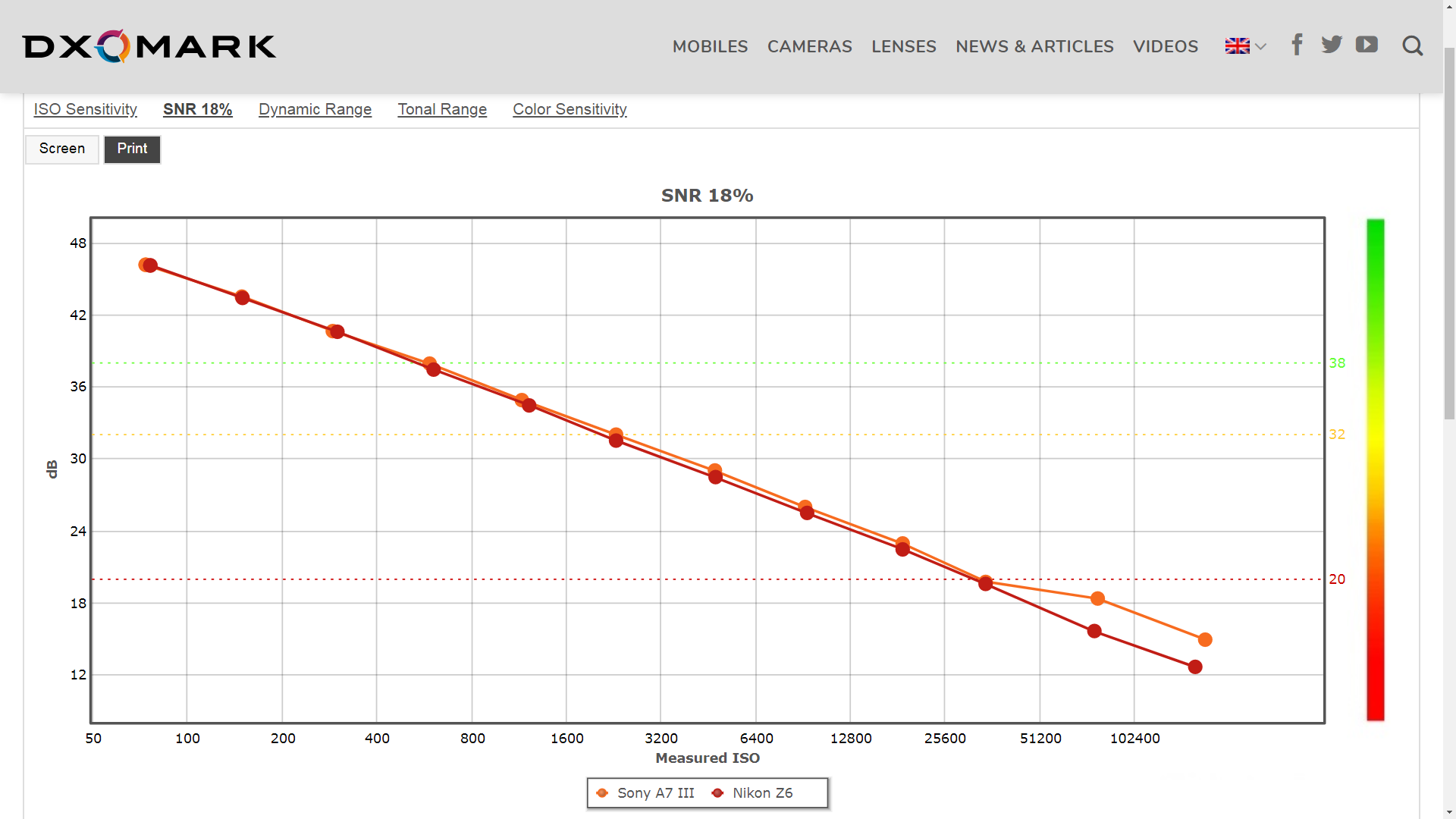

IronFilm Posted December 11, 2019 Share Posted December 11, 2019 15 hours ago, SRV1981 said: @IronFilm Thanks for your responses. 1/500 was to dark indoors with the XT2 and the ISO had to be at 6400 causing grain. What was your F-stop though? Couldn't you use say 1/300th? Do you have a handful of pics you can share? 15 hours ago, SRV1981 said: From what I read that Z6 was excellent but couldn't compare with ISO performance of A7 III. Nahhhh, look at the measurement results: Basically identical until you get to over fifty thousand ISO Link to comment Share on other sites More sharing options...
thebrothersthre3 Posted December 11, 2019 Share Posted December 11, 2019 The Z6 probably beats the A73 for video low light as it has less heavy noise reduction, aka no ghosting at higher ISOs. IronFilm 1 Link to comment Share on other sites More sharing options...
