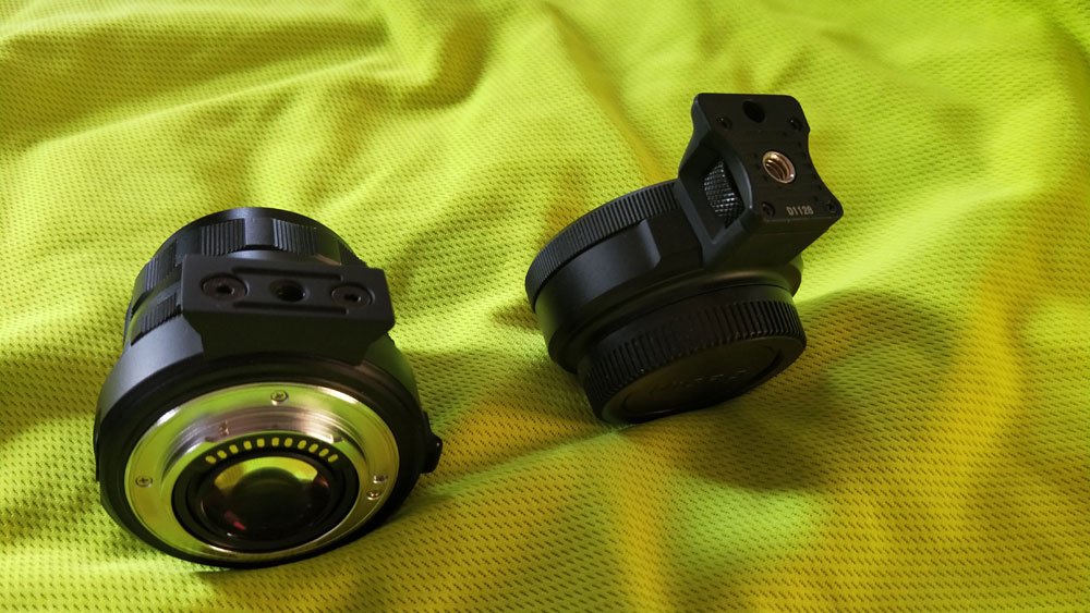

leslie Posted December 11, 2019 Share Posted December 11, 2019 i have two villtrox adapters, so i'm either a fanboy or a cheapskate or all of the above ? all my pentax m42's get mounted to a cheap ef adapter then to the viltox ef-m2. There is some small amount of play on both sides of the mount. If you shoot hand held it will probably annoy you. i also have the viltrox mount adapter for nikon to m4/3 the aperture control seems to work ok if i turn the aperture to f22 on the nikon then the viltrox will control the nikon aperture. The villtrox nikon mount has the same amount of play For what its worth i do like the foot on the viltrox ef speedbooster it has two screws to tighten it against the adapter. The nikon adapter has a thumbscrew setup and its a pain to tighten so the the camera doesn't move around. I cant really say anything much about the optics. Mattias Burling did some tests with the speedbooster, he seemed quite happy with it. Which is part of the reason i got the viltrox over the other adapters and cost of course. I dont have any auto focus lenses so i have no experience in that regard which is of no help to you. Link to comment Share on other sites More sharing options...
