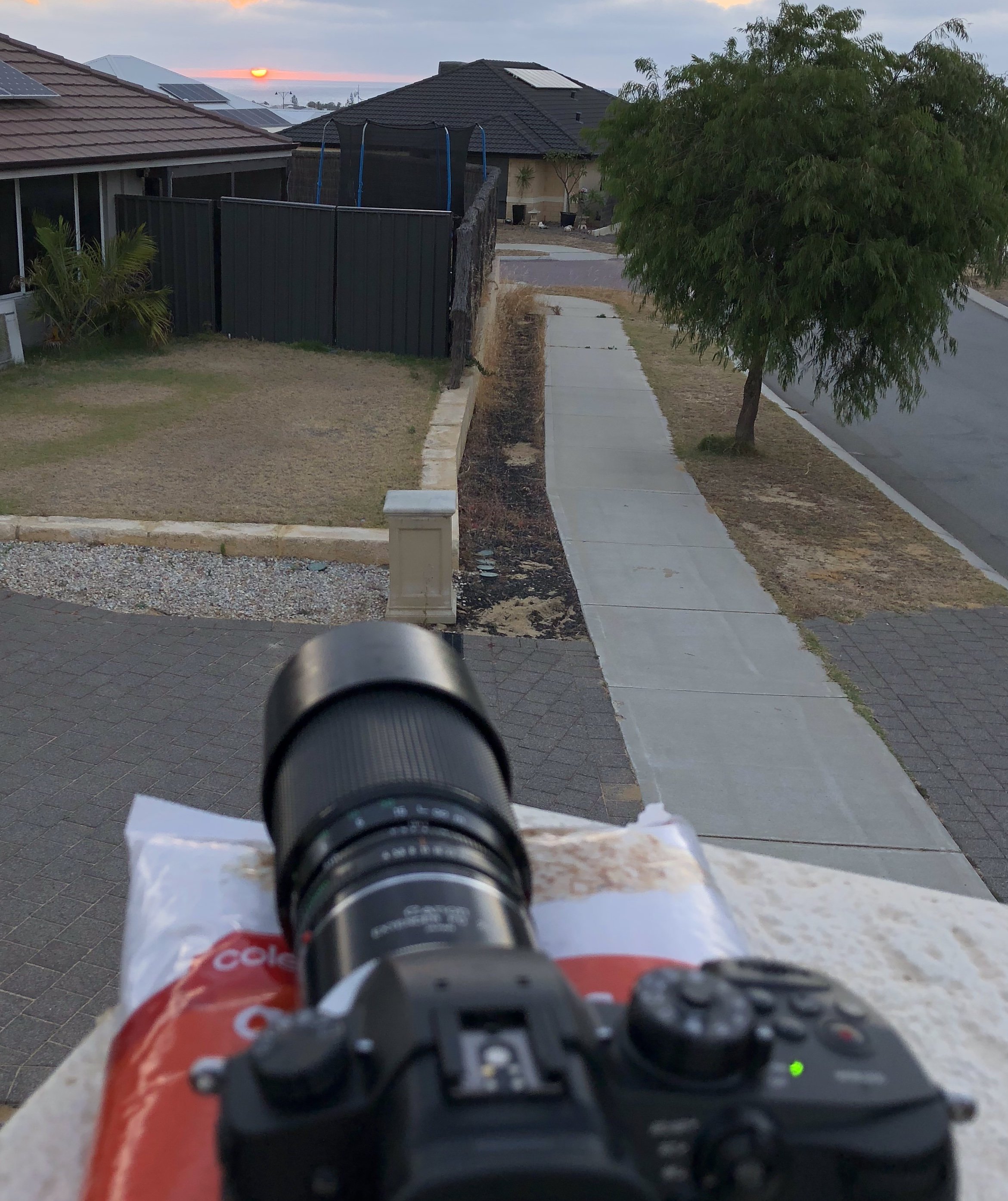

kye Posted December 18, 2019 Share Posted December 18, 2019 The other day I noticed the sunset and decided to have a go at filming the sunset at super-telephoto so that the sun fills a large section of the frame and you see all the atmospheric distortions and stuff. First attempt was a write-off because I stuffed up the focus. Second attempt was better as I was able to focus better, and then closed the aperture a few stops to make sure I got it. I stuffed up the settings as I still had it on my normal auto-exposure and auto-WB, so that's why I'm only posting this still, however I think I'm getting closer.. This was shot in 4K but I think next time I will do a normal time-lapse and get the benefits of RAW and a better ISO as there is quite a bit of grain in the file. The setup seems to work though: GH5, Canon FD 70-210 F4 at 210mm F11, Canon FD 2x TC. Setup on a packet of oats for stability in the breeze we had, and on top of a pillar on the fence. I suspect that at 840mm equivalent that stability is one of the key factors here, and the oats seemed to do the trick. Once I get it all setup then I can probably put a bag of pasta or something on the top to further damp it and deflect some of the wind. Yesterday was cloudy so no sunset, but hopefully tomorrow I'll get another go with fixed settings and in time-lapse mode and I'll be able to post a video instead of just a still Anyone else shooting longer than 600mm, or 800mm equivalents? kaylee and billdoubleu 2 Link to comment Share on other sites More sharing options...

Mark Romero 2 Posted December 21, 2019 Share Posted December 21, 2019 On 12/18/2019 at 3:50 AM, kye said: Setup on a packet of oats for stability in the breeze we had, Did you use organic oats??? That will give your footage a more "organic" look. leslie, kye and noone 1 2 Link to comment Share on other sites More sharing options...
