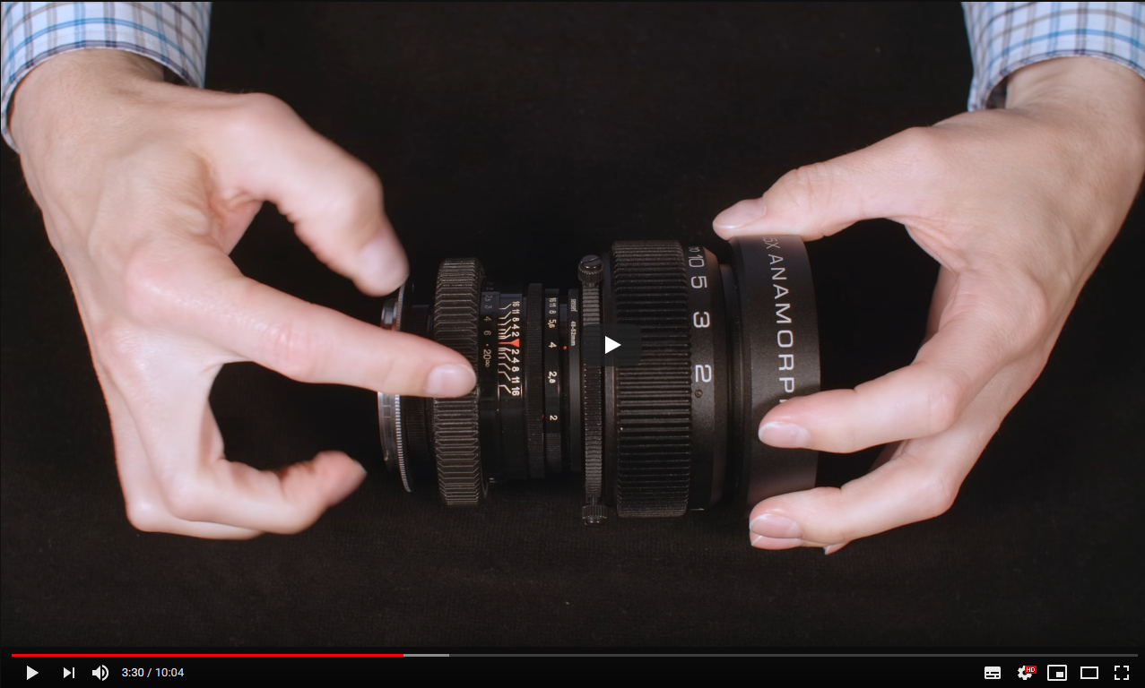

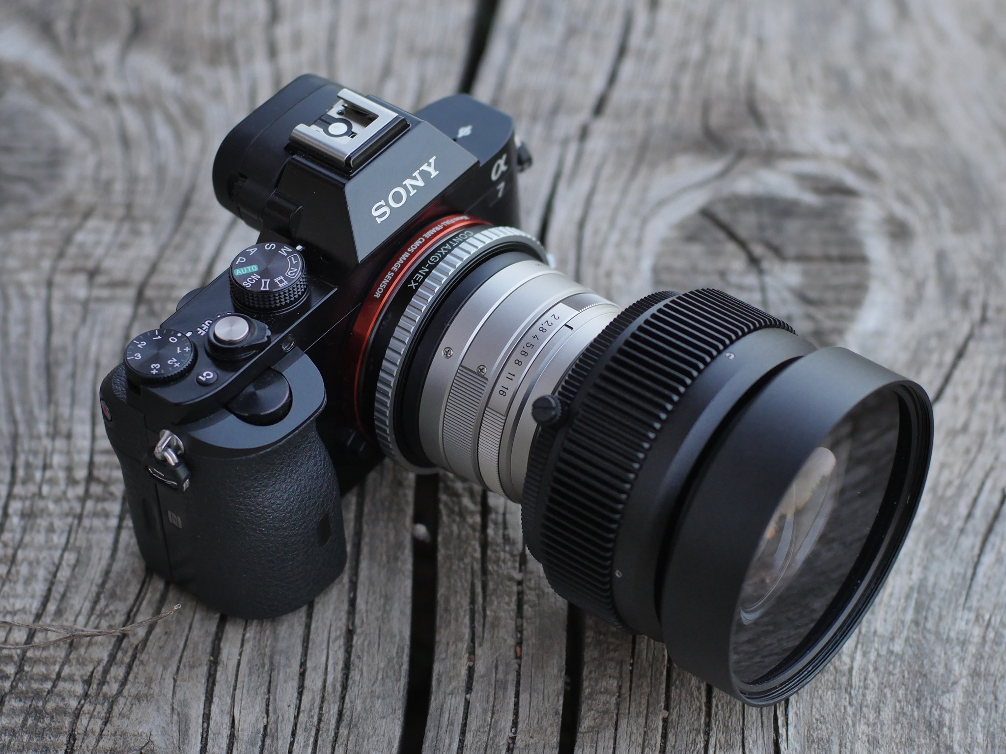

heart0less Posted December 26, 2019 Share Posted December 26, 2019 Nah, unfortunately it's still too heavy. I wouldn't feel comfortable / safe to use it without rails. The lightest way to go is Aivascope paired with Focuser-8, but you'd only get a 1.5x strech with it. Looks like this (not my photos): Chamsom, Ian Edward Weir and leslie 3 Link to comment Share on other sites More sharing options...

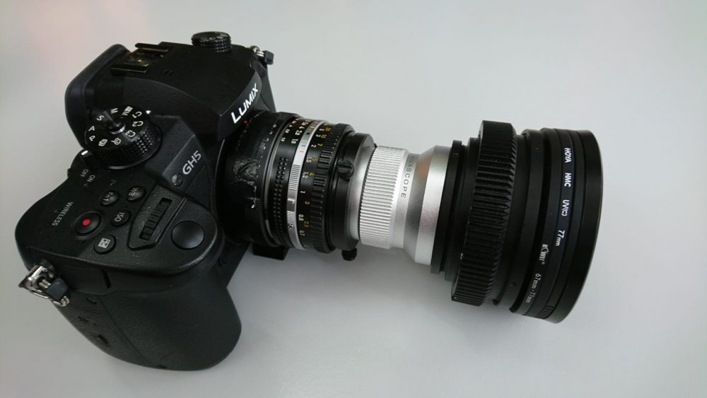

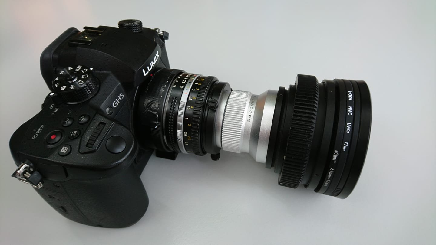

seku Posted December 27, 2019 Share Posted December 27, 2019 There's quite a few ways to go lightweight, but you didn't mention what sensor size you are going for The Aivascope that @heart0less linked you to is an awesome, single-focus 1.5x for fullframe. It does not need a focusser, but imho it does need support, because it is rather heavy on the taking lens at around 700 gramms. But Aivascope also makes a smaller scope, for smaller sensors. Here's mine for instance : GH5 > speedbooster > Nikon 50mm 1.8 pancake > Aivascope 1.75x v2 > ProtoDNA. Quite lightweight, does without rails. (see attached picture) This gives me perfect 2.40:1 when desqueezing opengate 4:3. Then again when you go vintage scopes there is quite a lot of choice : Baby Hypergonar (the 1.75x aivascope is a modern take on that one Yashica Scope (a cute small 1.5x one, which i would double focus) Bolex 8/19 (1.5x bolex flare goodness, one of my favorite baby scopes) Baby Kowa (2x, even more elusive than the Bolex) So you can go for light and small scopes, especially if you stick to m43 or s35 sensor sizes ... but it might take a year or 2 to hunt some baby scopes down... and you better have deep pockets. heart0less and Chamsom 2 Link to comment Share on other sites More sharing options...

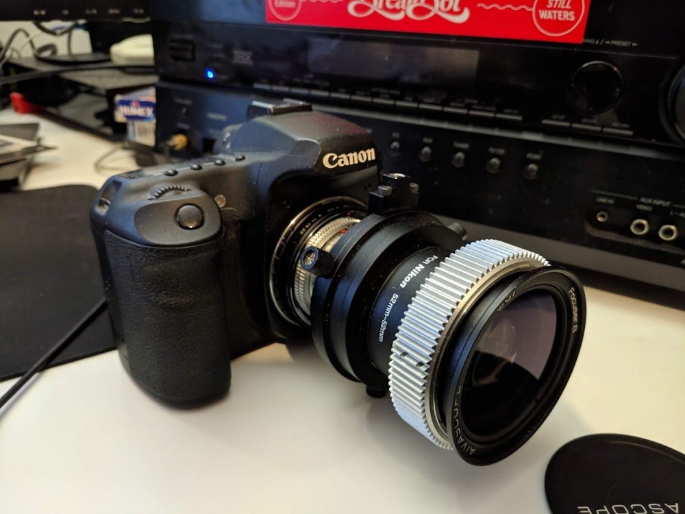

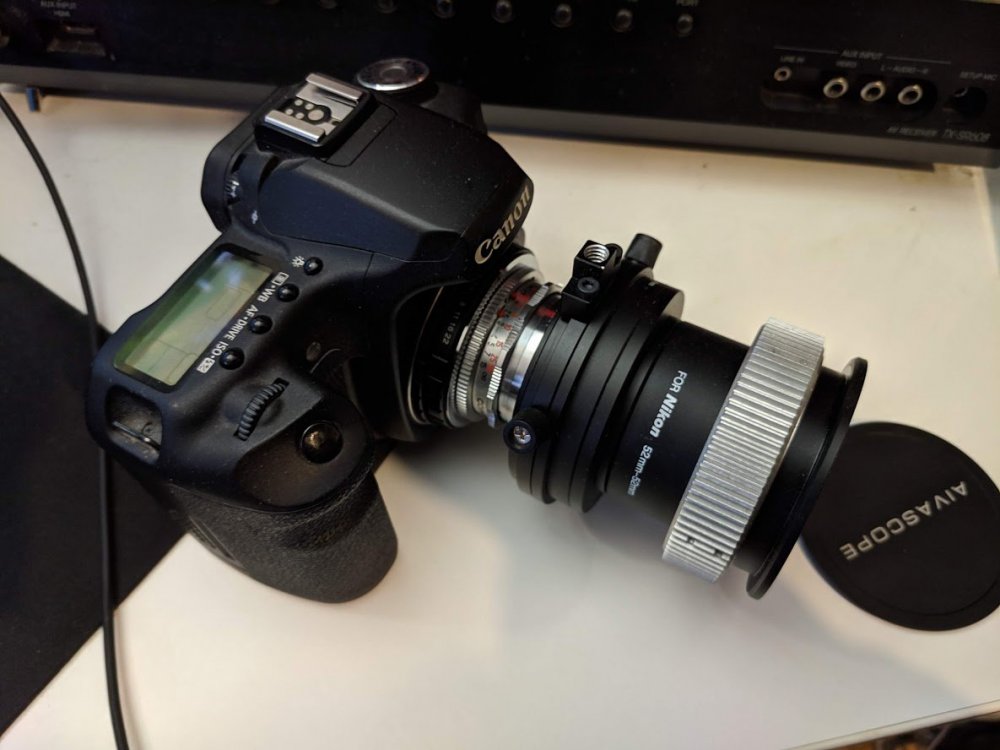

Justin Bacle Posted December 29, 2019 Share Posted December 29, 2019 Here you go, My smallest yet. Canon 50D + Voigtlander 50/2.8 (DKL mount) + YashicaScope + Aivascope Focuser 8 ( + lots of adapters from china + rapido to have the yashicascope held properly) Chamsom, heart0less, leslie and 1 other 4 Link to comment Share on other sites More sharing options...

seku Posted January 19, 2020 Share Posted January 19, 2020 the clamp came with the aivascope but for others, i like RAFCamera lately. Link to comment Share on other sites More sharing options...

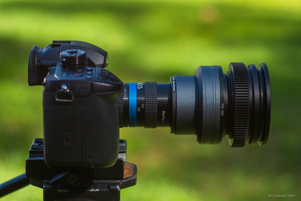

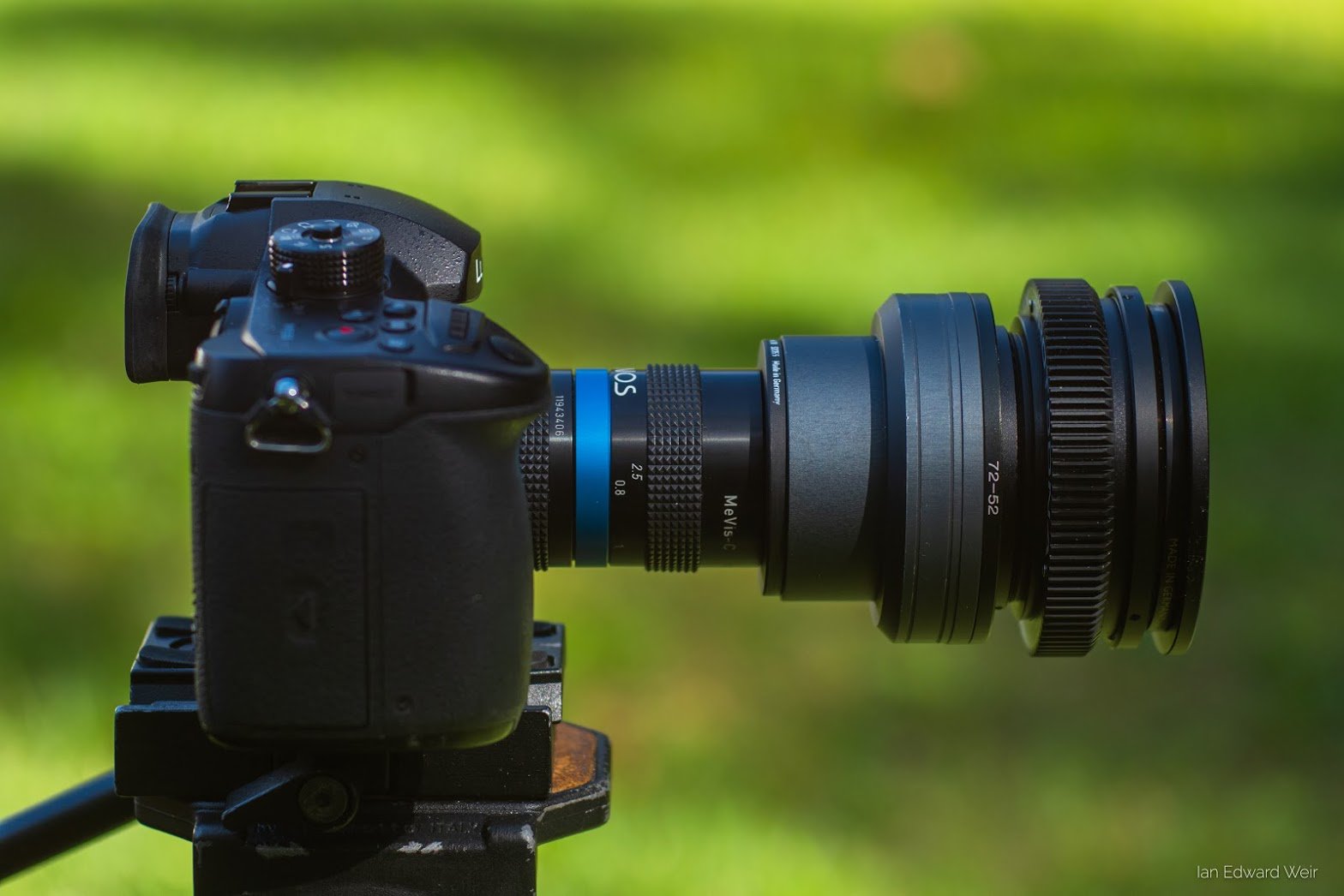

Ian Edward Weir Posted January 21, 2020 Share Posted January 21, 2020 Baby Hypergonar 1.75x in Redstan jacket + MeVis 35mm + Proto DNA. I also do this combo with the 38mm f1.8 Pen F and it's super tight. heart0less 1 Link to comment Share on other sites More sharing options...
Ian Edward Weir Posted January 21, 2020 Share Posted January 21, 2020 On 12/29/2019 at 9:03 AM, Justin Bacle said: Here you go, My smallest yet. Canon 50D + Voigtlander 50/2.8 (DKL mount) + YashicaScope + Aivascope Focuser 8 ( + lots of adapters from china + rapido to have the yashicascope held properly) Hey Justin, I have a few of those Rapido clamps laying around. I love to try the same thing with Bolex 8/19. How did you hold Yashica in place and have hood cover? What are your rings? Thats a Nikon spacer? Link to comment Share on other sites More sharing options...
