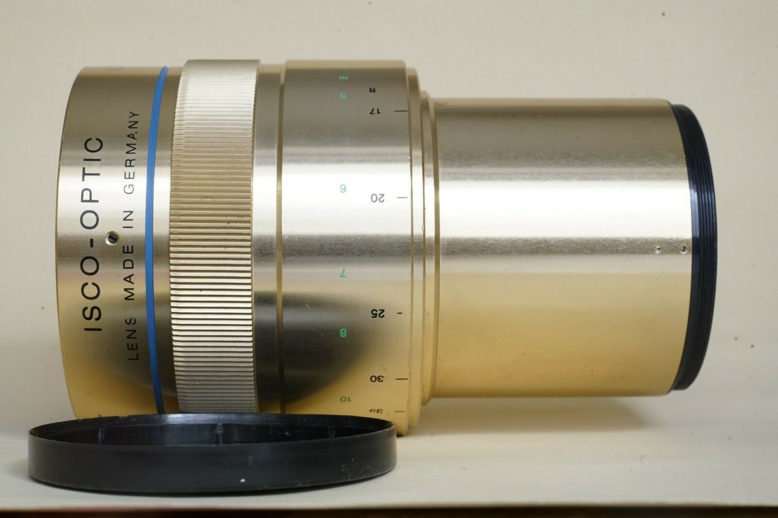

Marty Posted January 31, 2020 Author Share Posted January 31, 2020 Is this one a small or a big one? Link to comment Share on other sites More sharing options...

heart0less Posted February 1, 2020 Share Posted February 1, 2020 Yeah, it's the big one. Most of them feature those distinct green focusing marks, whereas the smaller ones don't. Here are some pictures of how do the small Ultra Stars look like: My Ultra Star looked like this: As I said, notice the focusing marks - they are unicolored. Link to comment Share on other sites More sharing options...
