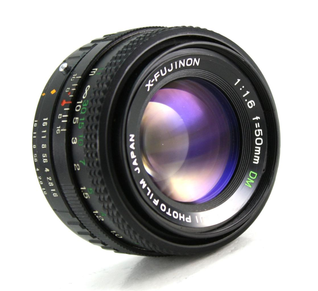

rawshooter Posted January 22, 2020 Share Posted January 22, 2020 This refers to the older, 1980s/1990s Fujica X-mount film SLR camera system, not to the Fujifilm X mirrorless system: https://en.wikipedia.org/wiki/Fujica_X-mount (This was a good manual-focus system, btw., with some really good lenses, which do a fine job adapted to the Sony A7 system.) Link to comment Share on other sites More sharing options...
Emanuel Posted January 22, 2020 Author Share Posted January 22, 2020 Yeah, they label it very inaccurate... Link to comment Share on other sites More sharing options...

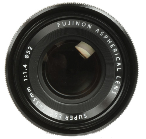

rawshooter Posted January 22, 2020 Share Posted January 22, 2020 11 minutes ago, Emanuel said: Yeah, they label it very inaccurate... No, it's correct - the lenses of the old SLR system were called "X-Fujinon": The lenses of the current mirrorless system are only called "Fujinon": Link to comment Share on other sites More sharing options...
