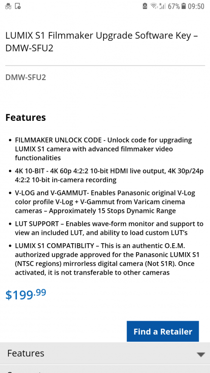

Mark Romero 2 Posted January 25, 2020 Share Posted January 25, 2020 Yes, the S1 can output 4K 60p (in aps-c crop) 10-bit 4:2:2 to an HDMI recorder. The S1 has some nice features when paired with the native Lumix 24-105 lens, but it has some drawbacks too, particularly on a gimbal. The native lenses are pretty expensive and pretty big and heavy. I use the S1 and 24-105 f/4 on my Weebill S and it is a bit hard for me to keep under control. The 24-105 is so big that you have to slide the whole rig back real far on the weebill s and that can limit how far up you can tilt the screen (I tend to shoot close to waist level on a gimbal, so it might be less of a bother to others who hold the camera closer to eye level). Oh, and that is with the 24-105 at the 24mm end. If you zoom in, then the barrel extends a LOT and you will have to rebalance and move the camera further back on the gimbal, if that is even possible. The S1 has two zebra memory positions, but unlike the S1H, you can't show BOTH zebras at the same time. On the other hand, some good things are that: The 25-105 is about as parfocal as can be, as far as I can tell and have seen on the internets The 24-105 has minimal focus breathing. While we all know about Panasonic DFD autofcus, doing a focus pull using the touch screen is REALLY smooth. It isn't fast, but it very gently eases in to the new focus point. It probably eases out from the first focus point, too. Yes, it is far slower than my Sony cameras, but it is much, much smoother and is pretty similar to a really good manual focus pull. (Much better than I can do manually.) And speaking of manual focus pulls, the S1 allows you to set the 24-105 to a linear focus response when turning the focus ring (so much better than the typical focus by wire response), and... You can adjust the amount of degrees of rotation in the focus ring from minimum focus distance to infinity. I think you can have a minimum of 90-degrees and a max of at least 360-degrees. There is a setting that says "Maximum" but got no clue what that means. The other good news is that the Sigma MC-21 seems to work pretty well with a lot of Canon glass (at least for AF-S, there is no AF-C at this time with the SA-21 adapter and ANY lens, either sigma or canon), and your typical manual vintage FF lenses work well on the S1. That's a good thing because there isn't a whole lot of L Mount glass available now. For example, the only native 50mm lens is an f/1.4 costs around $2,300 and there isn't anything on any lens roadmap for a native 50mm f/1.8 for a couple hundred dollars. There is an 85mm f/1.8 on Panasonic's lens roadmap, but I wouldn't be surprised if it is big, heavy and expensive. Trek of Joy and Geoff_L 2 Link to comment Share on other sites More sharing options...
Mark Romero 2 Posted January 25, 2020 Share Posted January 25, 2020 27 minutes ago, Mckinise said: Both the Pocket Cinema Cameras and S1H have true 24.0 fps and Cinema 4k, but does the S1 have it before or AFTER the Filmmaker upgrade key? Just to clarify, the S1 (with the film makers upgrade) shoots at 23.976 fps, as opposed to "true 24.0 fps." I would assume that before the upgrade it still shot at 23.976 fps. Resolution is 3840 X 2160, so it is UHD and not DCI 4K. At least, that is as far as I can tell. The S1 is VERY complex (for me) and some of the settings seem to affect / interact with other settings. So maybe there is a way to get DCI 4K and true 24.0fps that I am not familiar with yet. This is for the S1. I don't know what the S1H does. Link to comment Share on other sites More sharing options...
Super Members BTM_Pix Posted January 25, 2020 Super Members Share Posted January 25, 2020 20 minutes ago, Mark Romero 2 said: Yes, the S1 can output 4K 60p (in aps-c crop) 10-bit 4:2:2 to an HDMI recorder. Is it still cropped with the DMW-SFU2 upgrade ? Link to comment Share on other sites More sharing options...
Mark Romero 2 Posted January 25, 2020 Share Posted January 25, 2020 22 minutes ago, BTM_Pix said: Is it still cropped with the DMW-SFU2 upgrade ? Yes, as of this writing, it is still cropped. Don't know if further on down the road, with any more firmware updates, it will offer full frame readout or not. I know a few other S1 owners and they have said that they find there is a bit too much noise in VLOG to use 4K 60p so they tend to use HLG instead if shooting 4K 60p. I would assume that is due to the crop instead of using 6K downsampled in camera to 4K, which is what a full frame readout would give. I don't want to swear by it since I don't own one, but I believe the 4K 60p in the S1H is cropped as well. BTM_Pix 1 Link to comment Share on other sites More sharing options...

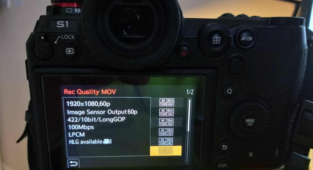

Mark Romero 2 Posted January 27, 2020 Share Posted January 27, 2020 8 hours ago, thebrothersthre3 said: Have you tried this? Because that doesn't make sense that you can do 10bit hlg but not log. Neither HLG nor VLOG is available as 4K 60p 10-bit internal. Internally, you can record 1080p 60p 10-bit at 100Mbs (don't know if that is 4:2:2 or 4:2:0 though). Link to comment Share on other sites More sharing options...
Rinad Amir Posted January 27, 2020 Share Posted January 27, 2020 37 minutes ago, Mark Romero 2 said: Neither HLG nor VLOG is available as 4K 60p 10-bit internal. Internally, you can record 1080p 60p 10-bit at 100Mbs (don't know if that is 4:2:2 or 4:2:0 though). Correction 1080p 4:2:2 10bit 100mbs Vision 1 Link to comment Share on other sites More sharing options...
Vision Posted January 27, 2020 Share Posted January 27, 2020 Hey everyone Yes S1 shoots 4:2:2 in 10bit 100Mbs Full Log in HD Rinad Amir 1 Link to comment Share on other sites More sharing options...
Mark Romero 2 Posted January 27, 2020 Share Posted January 27, 2020 11 minutes ago, Rinad Amir said: Correction 1080p 4:2:2 10bit 100mbs Yeah, thanks for pointing that out. if you go into the full menu it shows more details about the codec. I have it set up in the quick menu (Q) and it shows less details. For anyone who might be interested, if you are in the menu system and click the DISP button, it gives a little pop-up blurb that describes the settings in a bit of detail. Can be helpful for those who aren't really sure what the settings do. Vision 1 Link to comment Share on other sites More sharing options...
